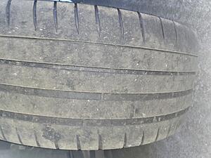

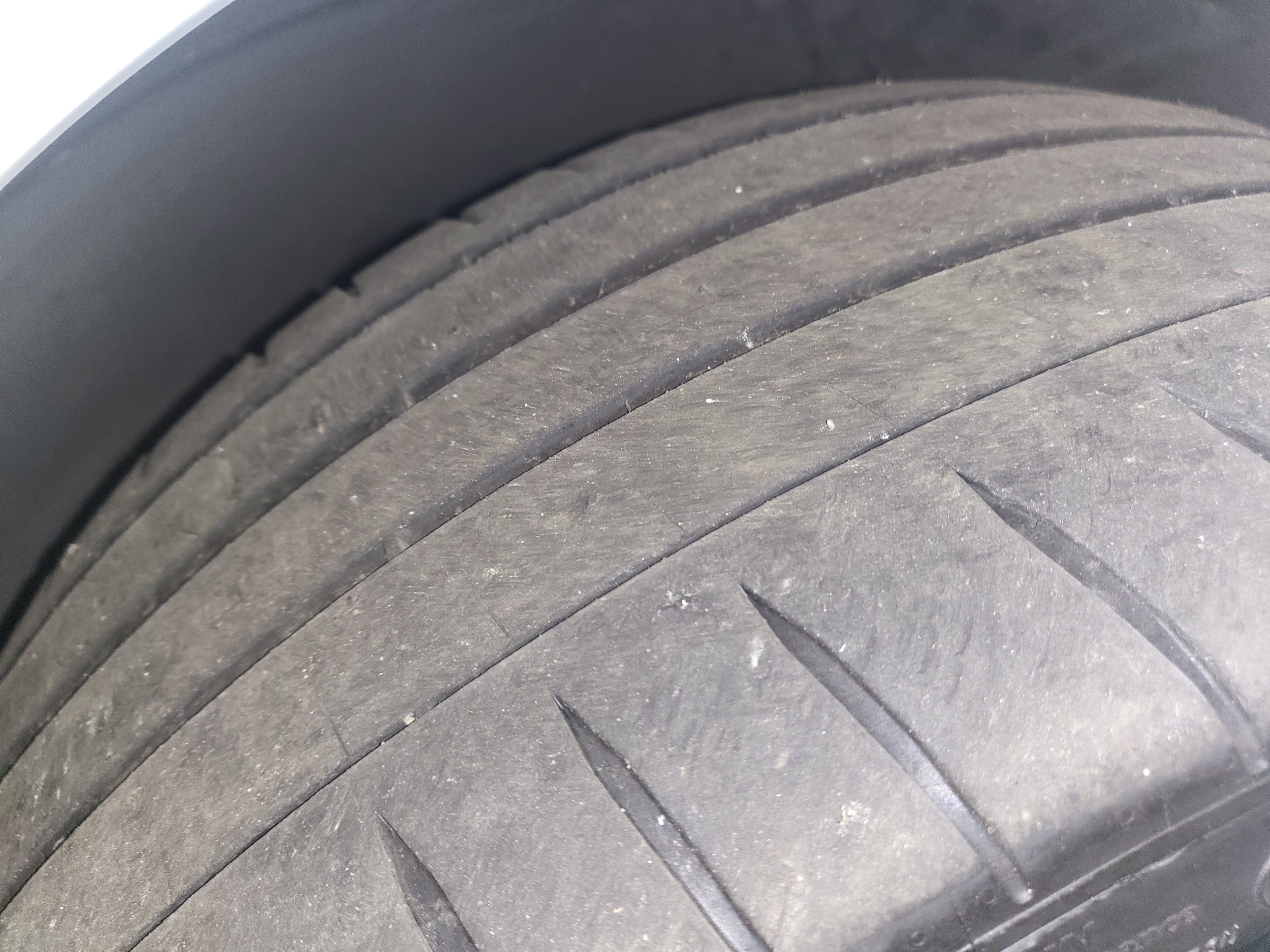

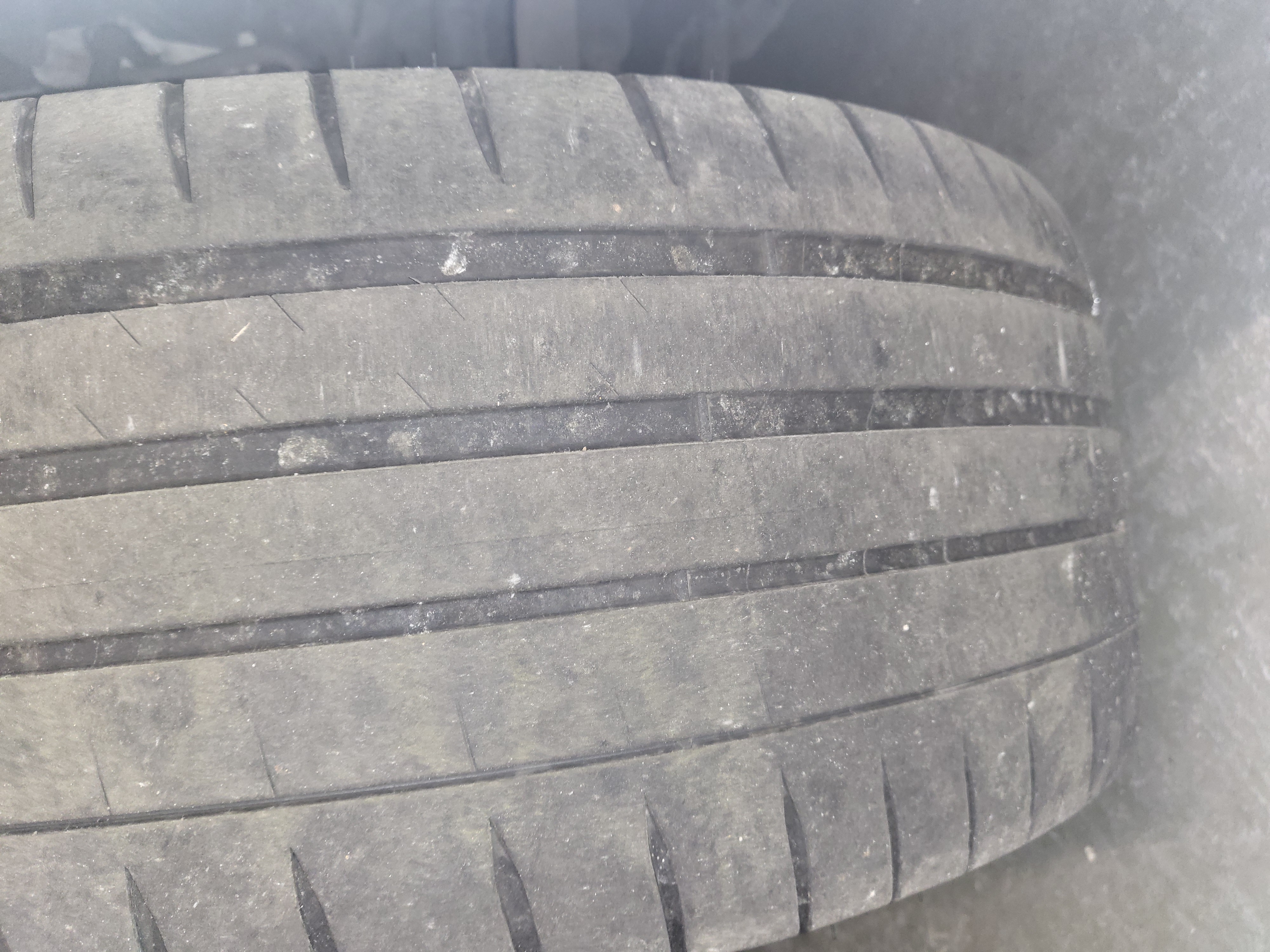

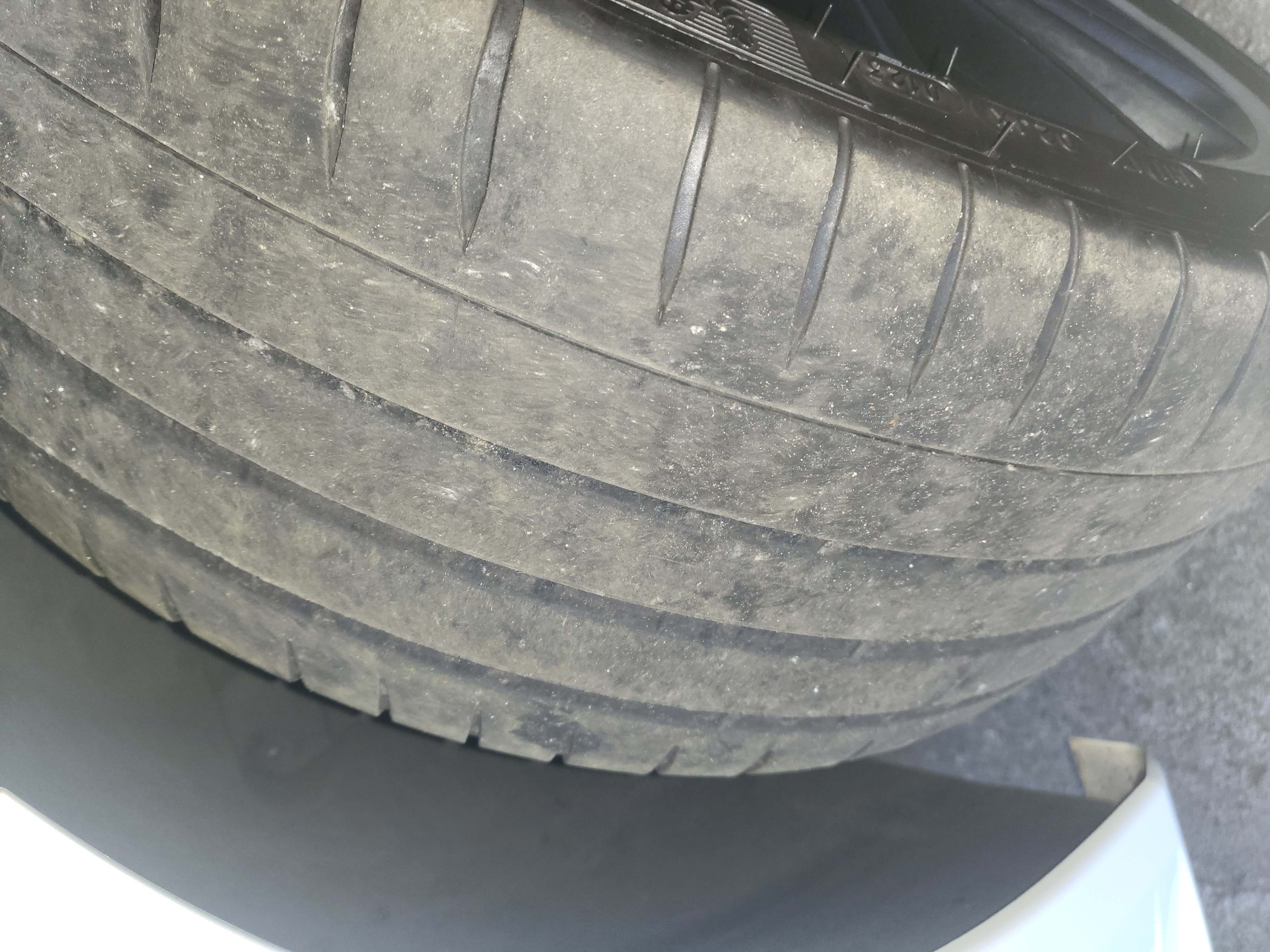

First 2 pics are the front right tyre. 2nd set are the front left tyre.
OK, they're not slicks & maybe I exaggerated but I was honestly horrified to discover they are both illegal in such a small timeframe.
I know the second pic doesn't look like they are past the markers but both are shot and past the markers.
I'll go Demon Tweeks & do an alignment as stated and hopefully this issue is sorted.

Looks like some fairly even wear to me. Maybe slight over pressure.
Are you sure they didn't install used tires to begin with?

Slight over inflation and yeah your toe is probably fairly aggressive (stock settings)

It seems impossible that you could put that much wear on the fronts in 800 miles and evenly - what are the date codes on the sidewalls?
