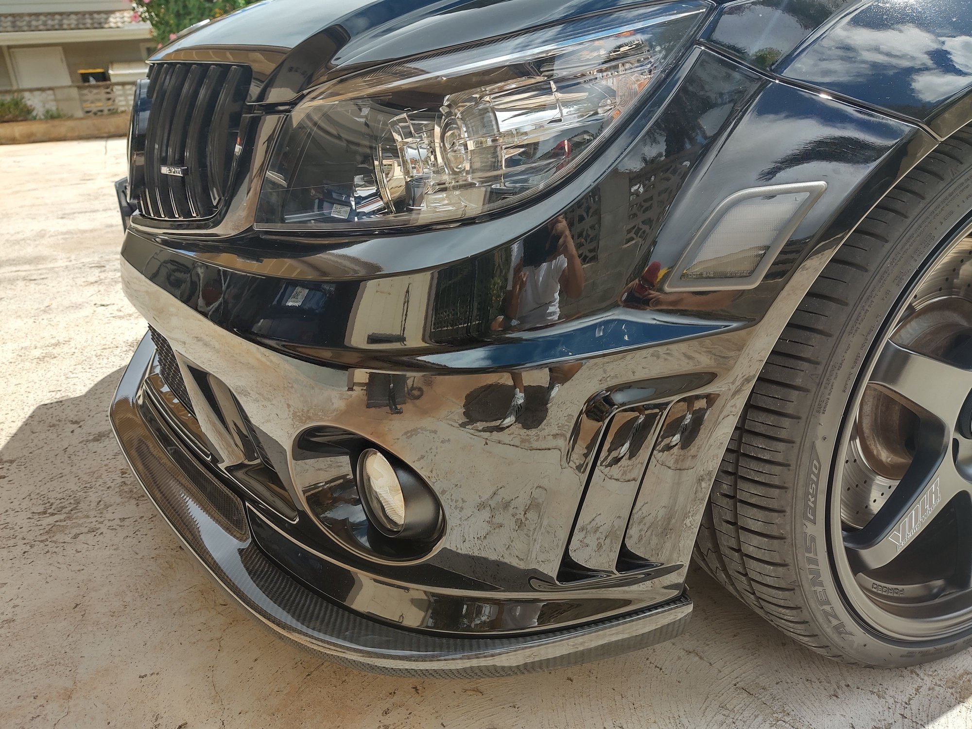

Ok at the risk of seeming stupid I'm attempting to passively straighten the splitter. It's not as stiff as I remembered, it does flex when I push down on it so I'm confident it can be fit to the bumper, however I prefer not to install it under tension.
It has about an 1-1/2" of deflection, using some dumbells to flatten it and hoping the Hawaiian sun will basically gently soften up the fiberglass over one week. I've read on some other forums that these warp from improper storage and some others had a degree of success resetting the shape by using jigs or weights in the sun or with heatguns. After I'll remove the bumper, install with well nuts and silicone then clamp overnight while the silicone sets.
I'll post pics of progress

So install successful. Thanks to everyone for your suggestion, y'all basically saved me 500 dollars. It definitely wasn't perfect, I needed to use a Dremel to cut some to fit and there are still some small gaps but overall it looks good enough for me.
Installed with well nuts and self tappers. Used clamps to get everything lined up. Took about 3 hours and cursing but it's in there.
