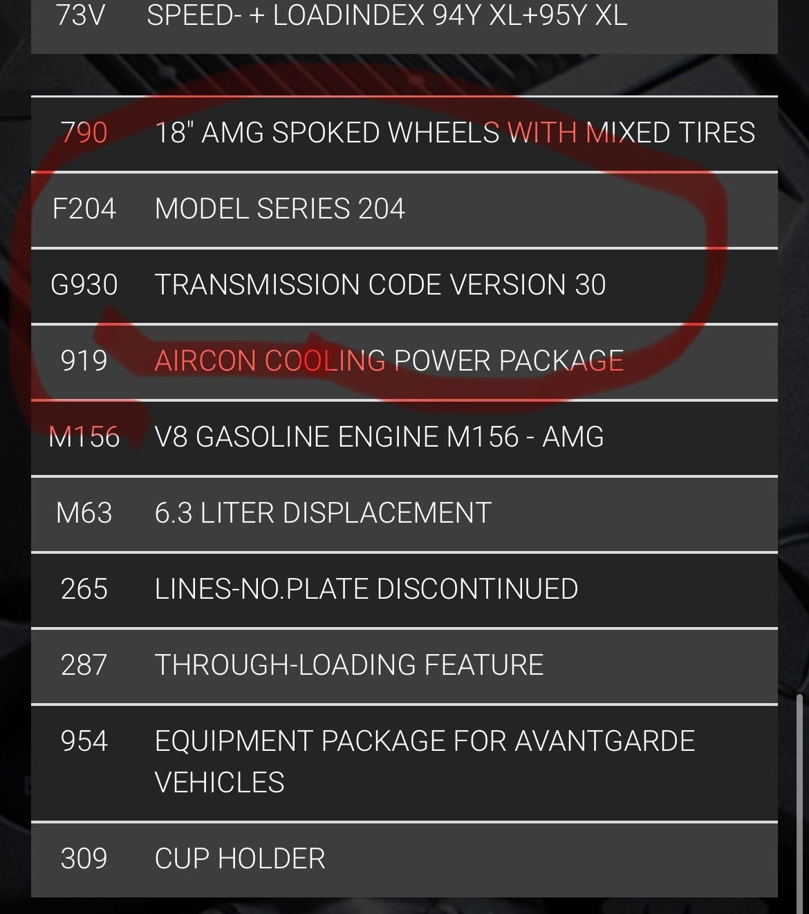

I have a 2013 Mercedes c63, and I was wondering how can I find out if my car has a lsd? I did a vin decoder and it said I had transmission code version 30, not sure if that means I have a LSD, usually when I do burnouts both wheels do spin so im guessing I do? My car is not a P31.

The data sheet will have a code for 471. You can also lift the car, put in neutral and spin a tire, if the other moves in opposite direction then you have an open diff.

Yeah I just checked it right now and no 471 , maybe I’ll swap for a LSD , I don’t do donuts or burnouts to often so im not to sure ,
