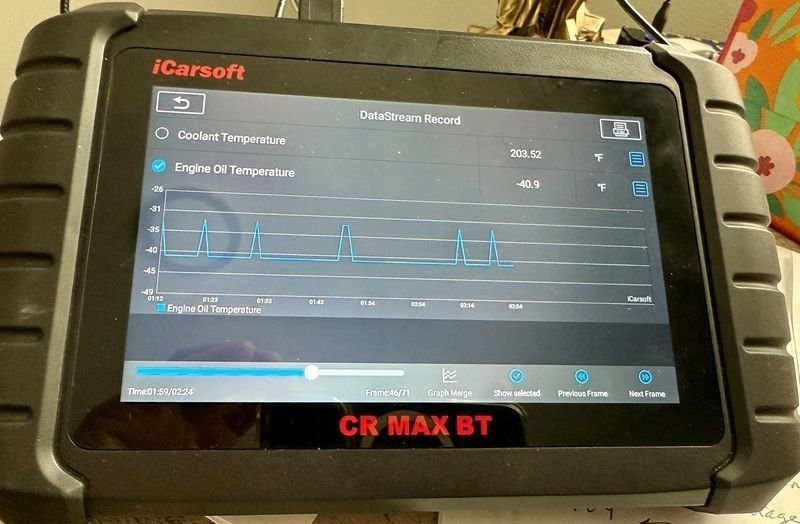

One question I've heard asked but not answered is whether you have to remove anything if you don't know if you need to replace the sensor, you just want to pull [and reconnect] the connector. Do any of you know the answer to that?
Also, If I remove the ECU connector and read back through the sensor to ground, any idea what resistance it should read when cold?
When I read the oil temp pid with my iCarsoft scanner, I see that it has almost regular very clean spiky pulses from between -41C up to -32C. Not what I would expect from either a faulty sensor or an oily wire so i'm wondering if what I'm seeing is the actual sensor output or if it's a calculated/test value from the ECU.
Thanks in advance for whatever info you might be able to offer.
Graph of oil temp pid when display is showing only blank underlines
