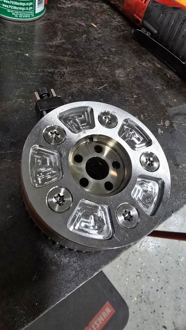

Update (kind of lol):
Haven't touched the car since April. I've got other "fun" summer cars that i've been driving so it hasnt really been a priority to fix it, so its been sitting the driveway since April.
Since I last updated this thread, late March i threw my hands up and drove the car the ~2 miles to the local mercedes dealer. I was going to be traveling, buying another vehicle (Ford Lightning) and knew I had a ton of other projects stacking up, so I decided to see if I could pay Mercedes to at least diagnose the issue. I typed up a full 1 page document for the service advisor explaining the symptoms, and everything I had done thus far to attempt to fix so that they hopefully wouldnt charge me for doing testing I had already done.
A week or so later they call and say its the passengers side exhaust cam adjuster solenoid. Ok, great, go ahead and replace it, i'm in Florida. Another week goes by, they call and say "we replaced the solenoid, no change, so it has to be the adjuster which would cost $3900 with labor to replace". At that point, I said i'll come get the car. I even spoke with the Master tech and the tech that worked on the car and discussed how they had come to this conclusion. They said the misfire occurs on multiple cylinders right at 1500RPM, which is when the adjuster is trying to activate. They basically said that is the only thing left it could be, and if its not that, they would need to open a case with Mercedes engineering because they are out of ideas ($$$$). So with that, I paid my $1100 diagnosis bill, and drove my still broken car back home.
Since then it has been sitting in the driveway.
I've got parts to take apart and inspect the adjusters (diamond washers, cam bolts, skeleton covers etc), just haven't had time. I've always dismissed the adjusters as a problem since I just rebuilt them 10k miles ago, but I am running out of ideas. I also found this thread, where it seems someone had my exact issue (multiple cylinder misfire only at 1500RPM, runs perfect above or below that RPM, and runs perfect with cam adjuster solenoid unplugged) https://mbworld.org/forums/c63-amg-w...k-misfire.html
When rebuilding the adjusters I did re-use the hex hardware and skeleton covers. perhaps one of them is leaking oil and not adjusting properly, or is seizing up? Probably worth an inspection at the very least. Open to other ideas. Hoping to finally work on the car this week!

Dang man, that's frustrating AF. The cam phaser operation should be pretty easy to see since you have HP Tuners...you can look at the desired exhaust adjustment and the actual exhaust adjustment and see if they are off. If not, then it's not that. If it is, then there are a few reasons why. Be sure to check for scoring internally if you dig into them.

Working on replacing cam adjuster skeleton covers. No smoking gun yet.

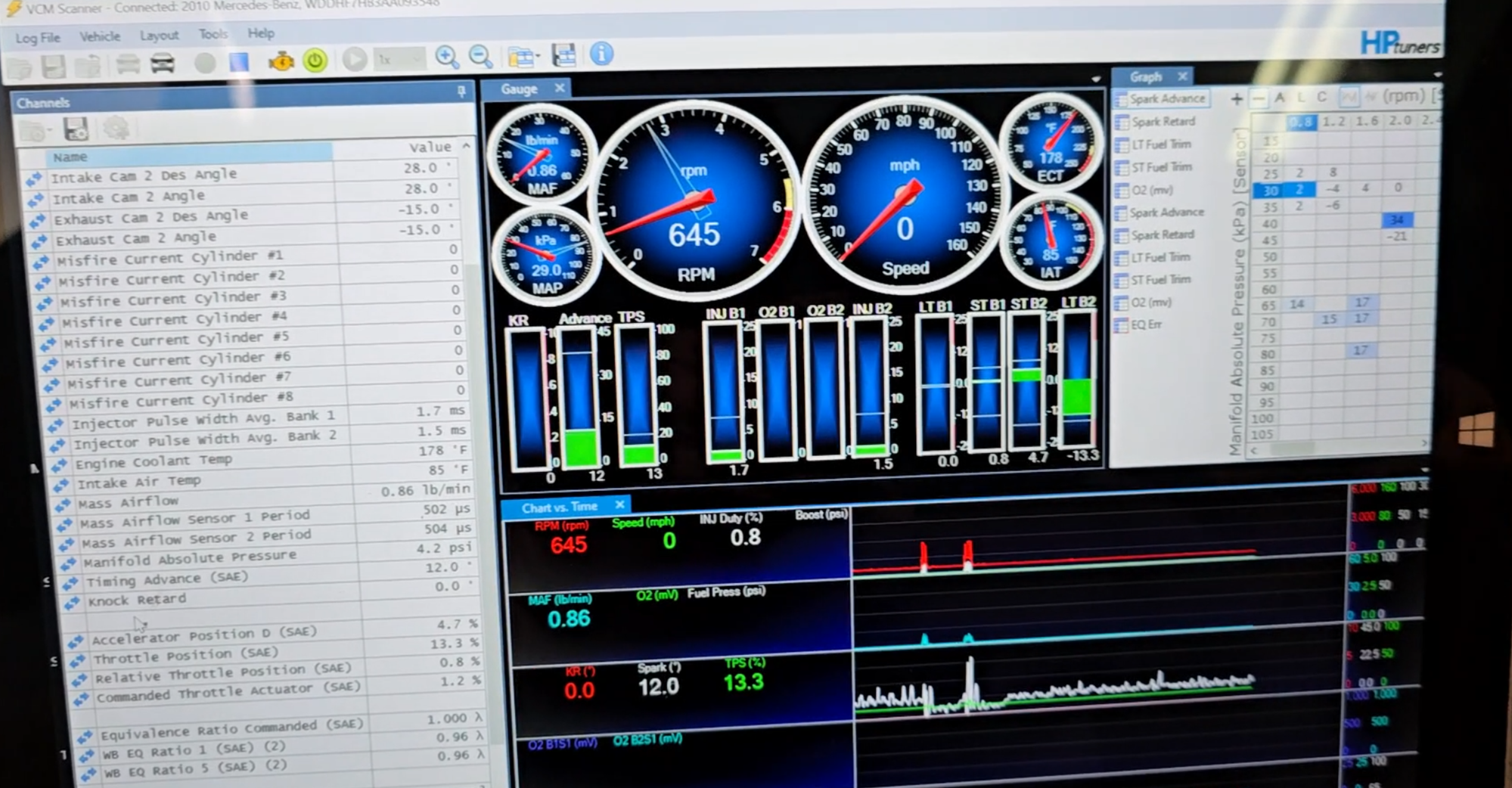

I've been happy with my setup from @BenzNinja. Years of successful use on my personal cars and friends' cars.
He specifies which Windows PC options to choose from and then remotes in to build you a complete setup spanning STAR, WIS / EPC and Vendiamo to code modules.
As for the rest of the hardware, he will link you sources to order from.

You can get the Xentry software online for free and install it on an old windows laptop. Then just buy the Tactrix Openport 2.0 from Aliexpress for $20 and save yourself hundreds of dollars.

Welp, as suspected, rebuild/inspection of the cam adjusters has not solved my issue. Car still misfires between 1300-2000rpm. Those 63 motorsports skeleton covers and hardware sure look nice though!
Smoke tested the entire engine, no leaks except for a minor one on the passengers side intake Y pipe right where the airbox clamps on. I broke the tab off the part that latches it to the intake manifold a while back anyways, so I just ordered a replacement off of ebay. This leak was very small though, so i dont have much confidence it has anything to do with my issue.
Still stumped at this point. Did let the car run for a while and noticed bank 2 LTFT are going down to ~15% negative.
Cams seem to be right where they are supposed to be.
One other thing I noticed was my battery voltage seemed to be all over the place. As low was 12.4V when running, and other times up to 14.5V. This seems strange to me, but i researched some older threads that say this is normal on these cars. I replaced the voltage regulator less than 2 years and 10k miles ago. Misfire does not appear to be affected at all whether the voltage is ~12V or ~14V.
Not sure what else to look at at this point. Car still runs without misfires with cam solenoids unplugged, but maybe this is because misfires are detected by those and when they are unplugged, it just ignores/doesnt see misfires?
