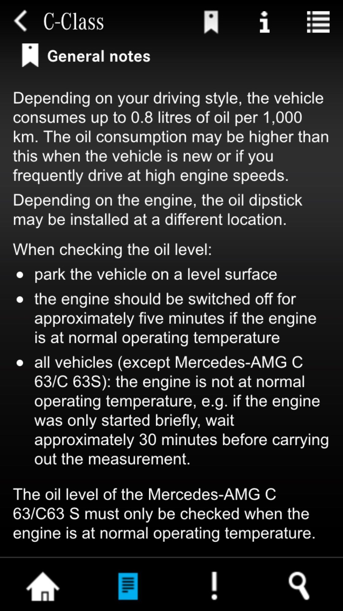

Oil level

Just for info if you've not read the manual but the oil level of normal C classes needs to be checked with the engine cold, the AMG engine however needs to be checked with it running and at operating temp.
Does sound like a problem as so many cases but maybe it is a bit low but your not seeing it because your checking the level when the engine is cold?

Has anyone here checked it as per the manual and then checked it with the engine cold to see the difference in indicated levels?

FastlaneJB
You said running??? it does not say that in the post (only at operating temp)and I have never heard of checking oil running are you sure about this??

Originally Posted by RDOCA
FastlaneJB
Sorry was late when I posted that, my mistake. Your right, just needs to be at operating temp. Hopefully no one got sucked up into the turbos and chewed up by a V8 because of my mistake
