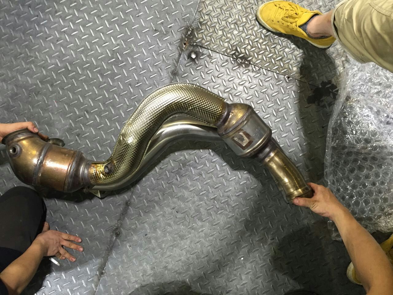

yea mate thats the same issue i cud face too ie RHD vs LHD! How did you fix the downpipe for fitment?

When the problem arise they told me to send my stock DP to their head quarters and custom make one that will fit for my RHD car. That's why I am saying it's fair for both customer and builder.

Stock RHD DP vs catless DP for driver's side, as you can see it will block something which is the steering column!
The passenger side DP was fine!

thanks so much for the shot mate!! Definitely will save me a lot of trouble getting my DP. Maybe i should get the weistec one as well coz they now know how to bend the pipe for RHD
