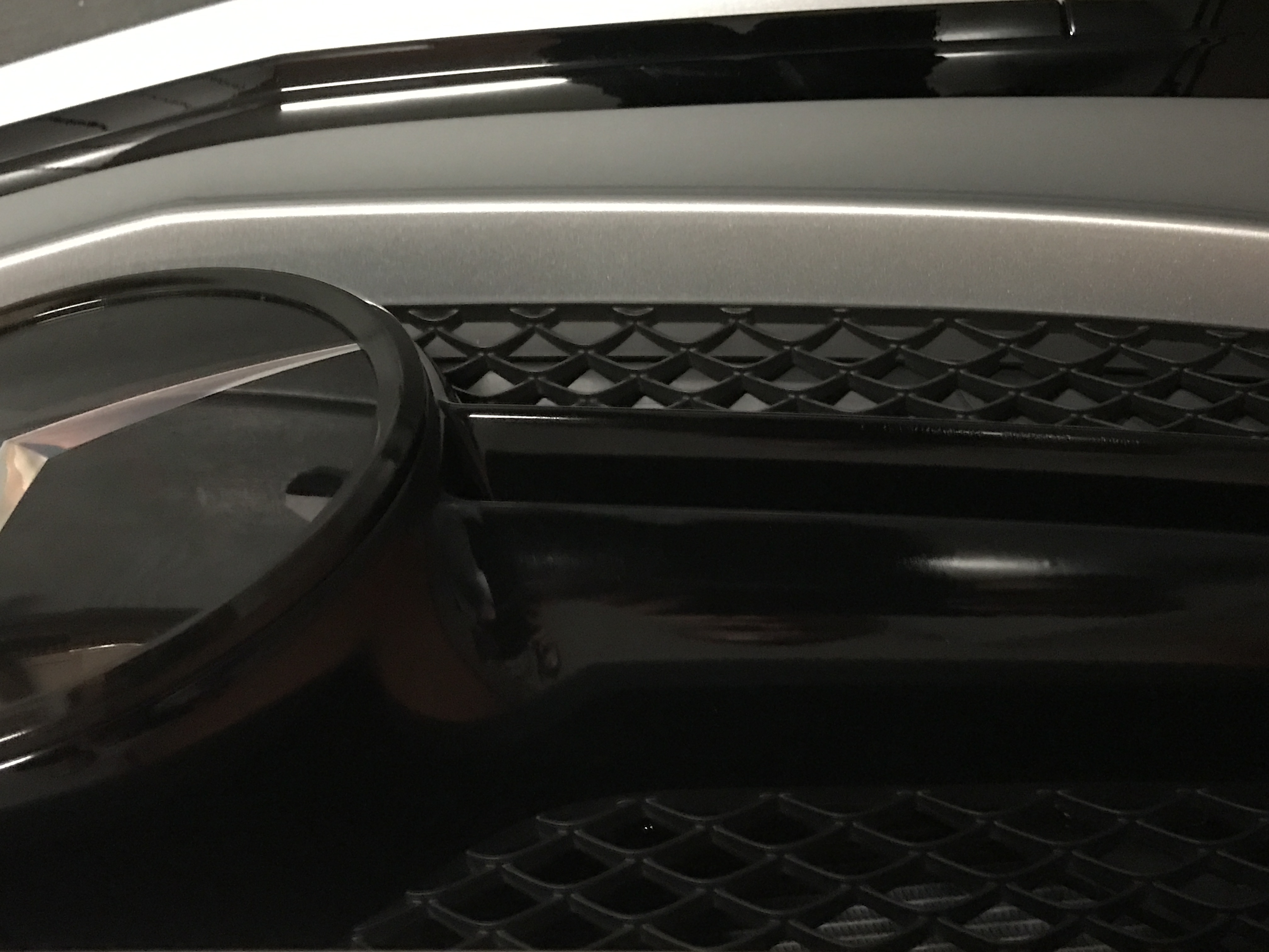

Used this paint, which is excellent IMHO:
Amazon Amazon
And for pics:
Attached Thumbnails Painting the front grill silver lines-img_0601.jpg   Painting the front grill silver lines-img_0602.jpg

Thanks man thats exactly what I wanted!!!
Did you leave it on the car and just tape/mask off the rest?

Oh god no, LOL.
Dealer removed and reinstalled.
Tip: multiple VERY LIGHT COATS.
Do not do what instructions on paint say.
Cover with light coats until completely covered, then just one more light coat
I applied a clear afterwards, same technique.
Too much paint is BAD!!!!
