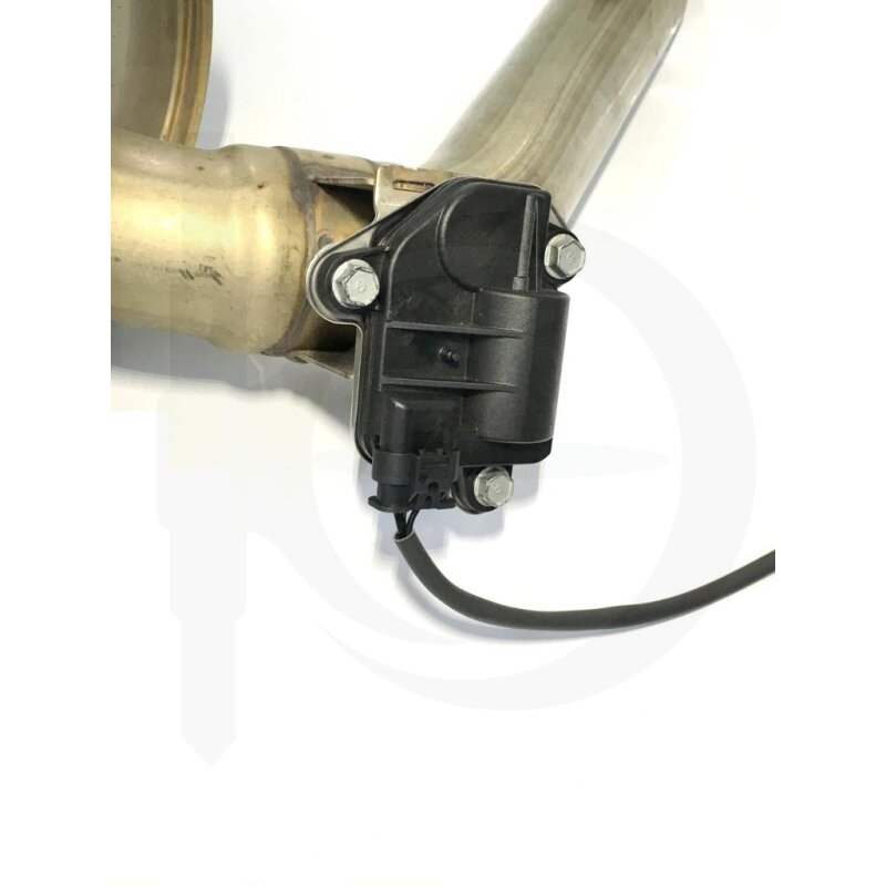

Yes, this one is specifically for the C63S: http://www.chrome-tec.com/Mercedes-C...s-AMG-C63.html
I've been in the back of the trunk before and that module is mounted right next to where the exhaust valve plugs are wired to the ECU/can-bus (though for the install, you plug at the actual exhaust valve motors and run the wiring up through the trunk, there's an opening for wiring).
This is the exhaust valve plug as it sits stock:
And this is with the plug intercepted:
Then you just run the wiring up to the trunk and mount the box. Very straightforward install, would probably take a half hour or so.

Hi all, quick update from Sweden.
I'm SUPER HAPPY with the end result after installing the Active Valve Control from Active-Sound.eu yesterday. Now I finally hear the potential in this car, it has a deep tone and is much louder during low RPMs. I can no longer cruise unnoticed on the streets apparently (if flaps are open). Another thing I need to mention is also how quiet and comfortable the car is when the flaps are 100% closed. Videos are coming, just need a tool that lets me blur my license plate. Any advise on software I should use?
Yes, I paid a higher price for my unit. Yes, I needed to "hardwire" and cut cables in my trunk - but it's worth it with the security features this module has. Even if my flaps are closed 100%, they will be forced open at high RPMs. The installation took about 20 mins.
I'm still waiting for my MB dealer to get back to me in order to get the latest software to get some loud crackles. I can't wait.
Please make sure the unit you are mounting has the same features, in order to not cause damage if you end up driving hard with the flaps closed.
EDIT: The perks (and reason it's more expensive than competitors) of the Active Sound version is that the exhaust button in my car still works, and it has the security feature mentioned above.
