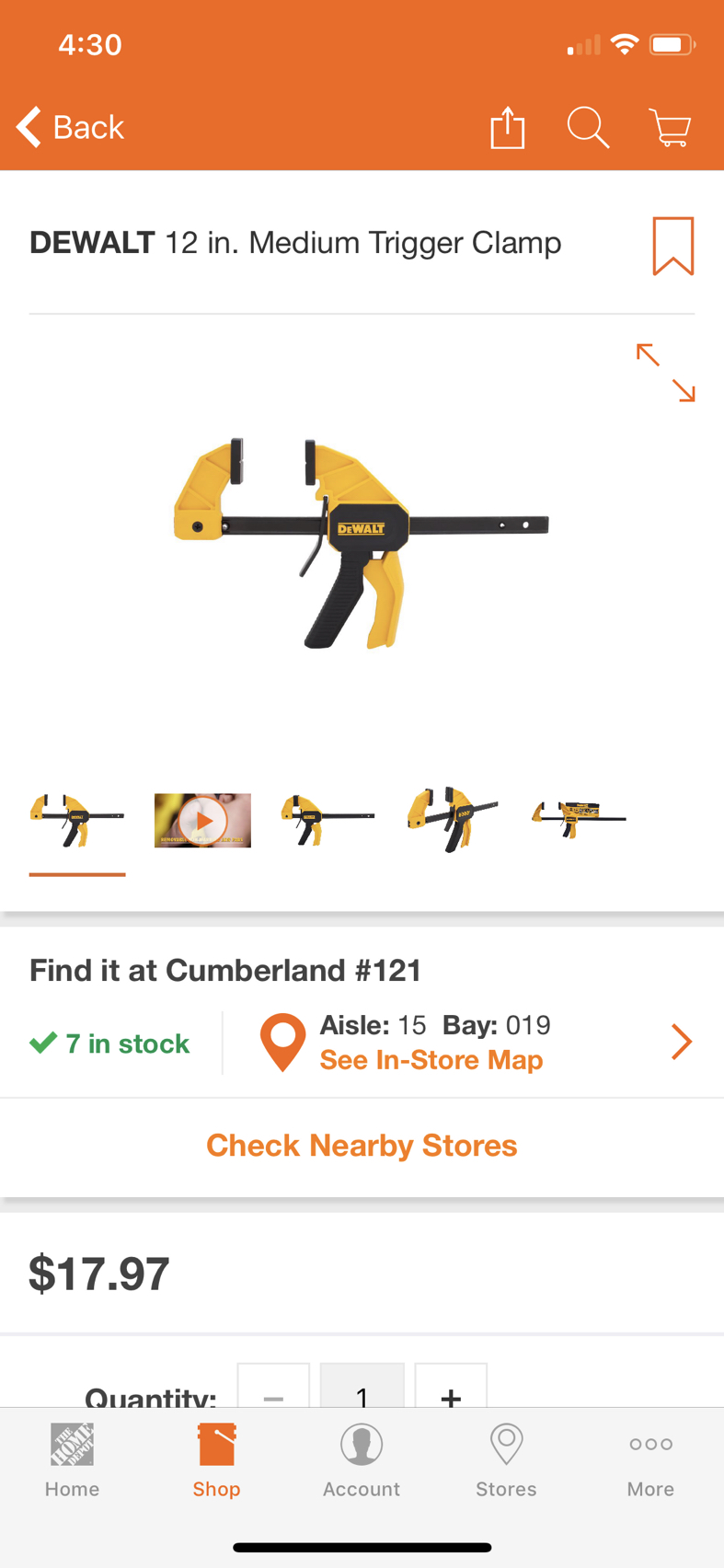

I just finshed my fronts they installed with ease. As for the backs, even in serivce mode their is so much meat I can’t get the pistons back by hand. Can you recommend a the piston retracting tool that you used?

Go to Home Depot and get a squeeze grip. They're in the tool isle and work like a charm. The Two pack is maybe 14 bucks
ahh shoot never thought of that, large vice grips.

Here you go

Here you go
That’s the exact one I used worked perfectly. Got the backs on with no problem. Took it out did 5 stops from about 35 then 3 from 45. Never came to a full stop.
