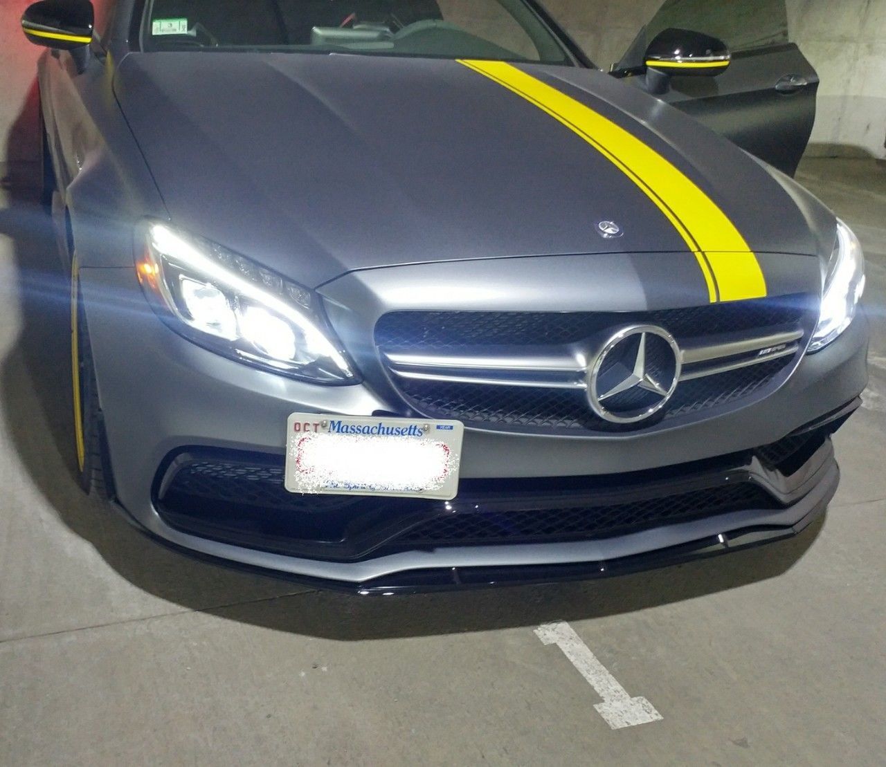

This is how I did mine

Thanks for the photo.
That looks like one of those frames goes into the tow hook
I was just curious if anyone out there used the dealer bracket in the center, and if that required drilling into the bumper

Old Oct 4, 2017 | 12:51 PM
ahesq's Avatar
Joined: Mar 2010
Posts: 106
Likes: 20
2021 GLE63S
Photos
