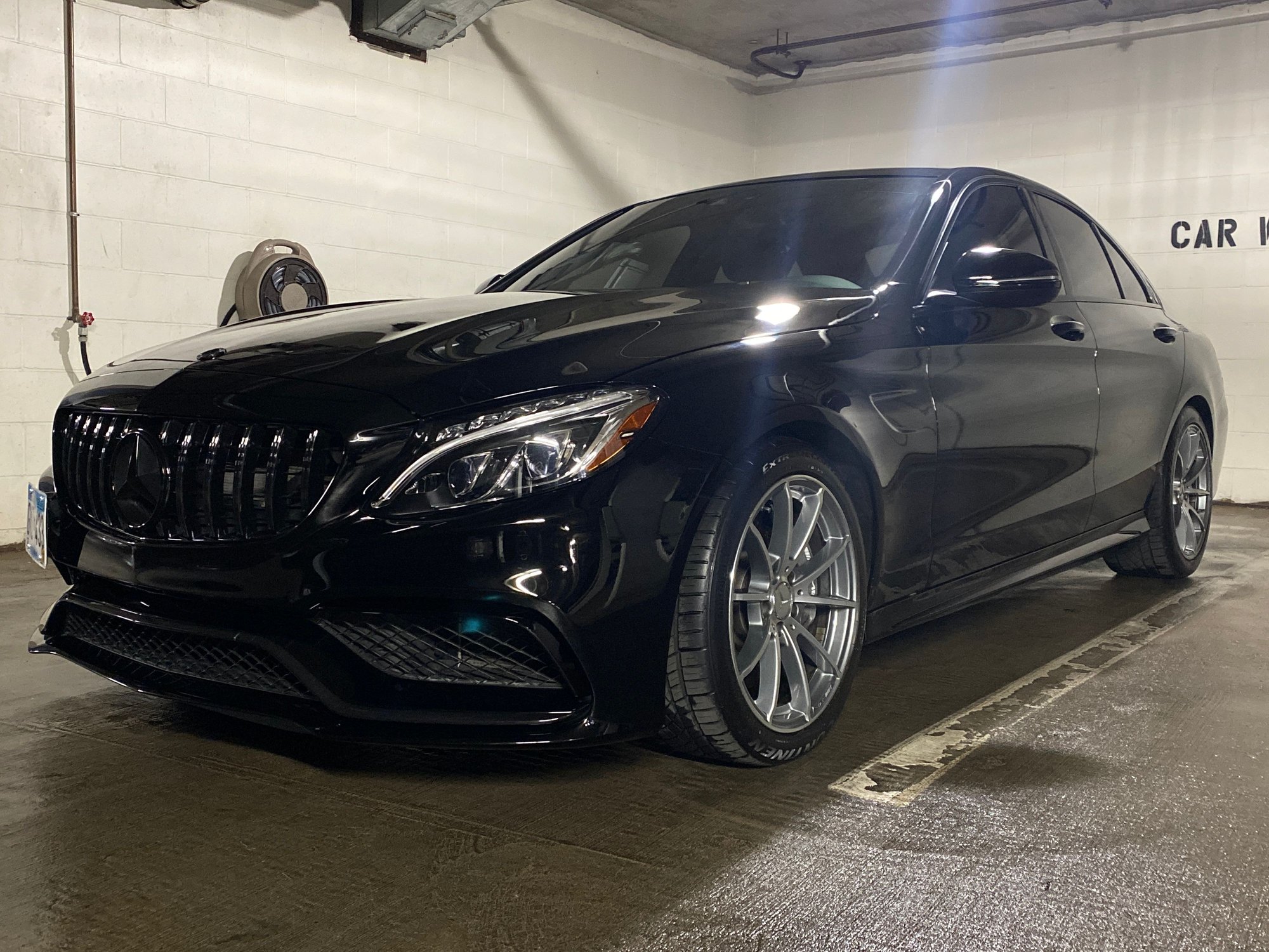

2016 C63 AMG SALOON
I have Continental Extreme Contract DSW06+ on my stock rims. Which are the best all season tires made; hands down.
I special ordered rims for summer tires. I'm thinking Goodyear Eagle F1 Supercar 3. I'm looking for tires with stiff sidewall that will ride good with the weight. Michelin track tires are great for Porsche and Corvette but too squishy for heavier cars. Bridgestone discontinued their "holy grail" 200 tread wear tire. Falkin Azenis RT660 is only W rated and the sidewalls bulge. I eliminated all non-XL rated tires. Michelin PS4S might be the safest for daily driving. But does the new Continental Sport DW out perform the Michelin PS4S now; on the DL. Goodyear Eagle F1 Supercar 3R and Nankang AR-1 might be slightly more extreme than I require for daily use. So far Goodyear Eagle F1 Supercar 3 is my top choice.
Front: 9.5x19 30ET, 265/35R19
Rear: 11x19 55ET, 305/30R19
