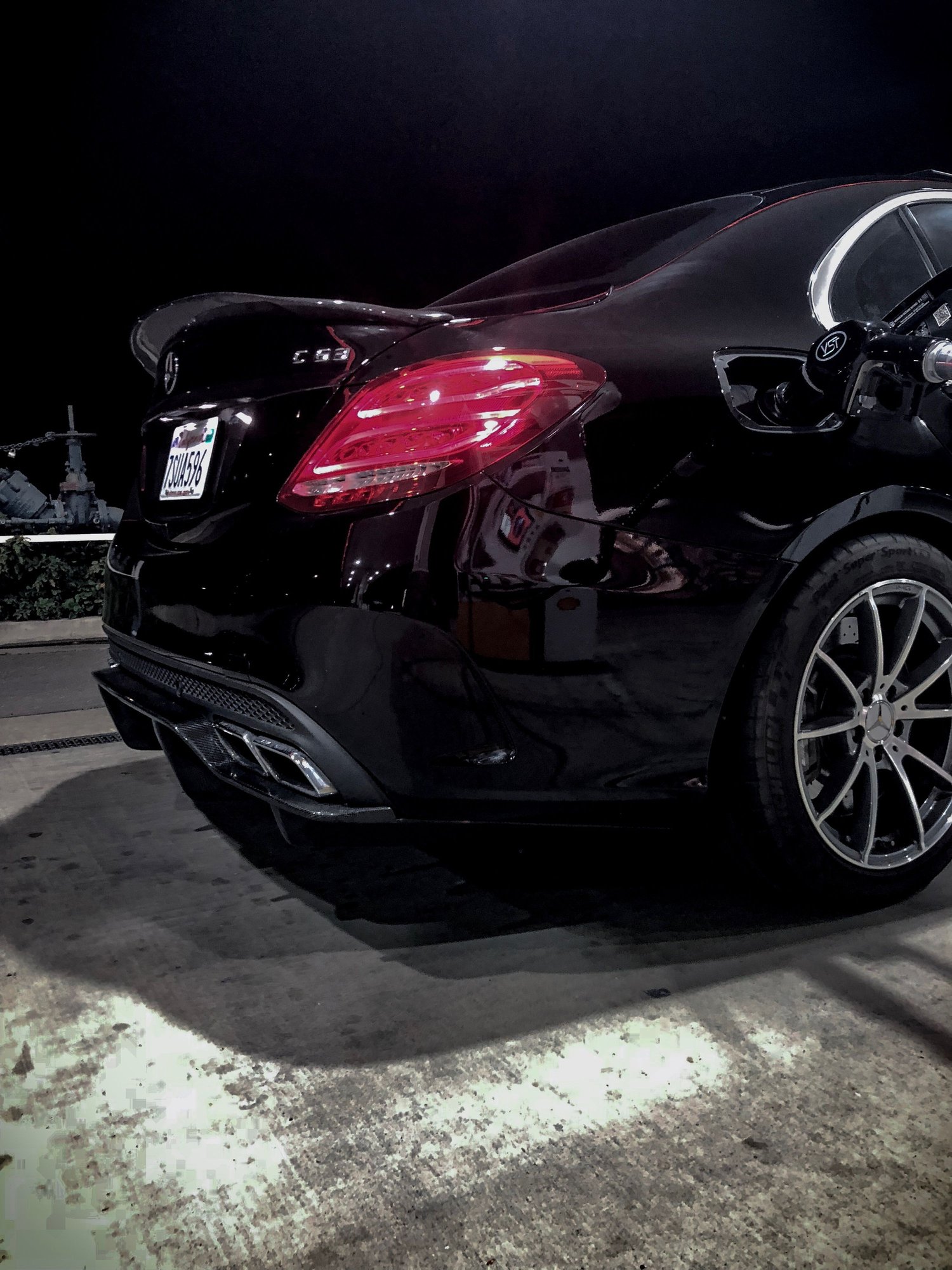

Feb 26, 2018 | 11:10 PM
18 inch wheels
Reply 0
Feb 27, 2018 | 10:14 AM
Quote:
These are 18" wheels mounted onto a non-S C63 which has smaller diameter front brakes than a C63S. Those same wheels would not be able to properly clear the front brakes on a C63S.
C63 = 360 mm (14.2 in) diameter front rotors
C63S = 390 mm (15.4 in) diameter front rotors for standard brakes or 400 mm (15.8 in) diameter front rotors for CCB
Reply 0
