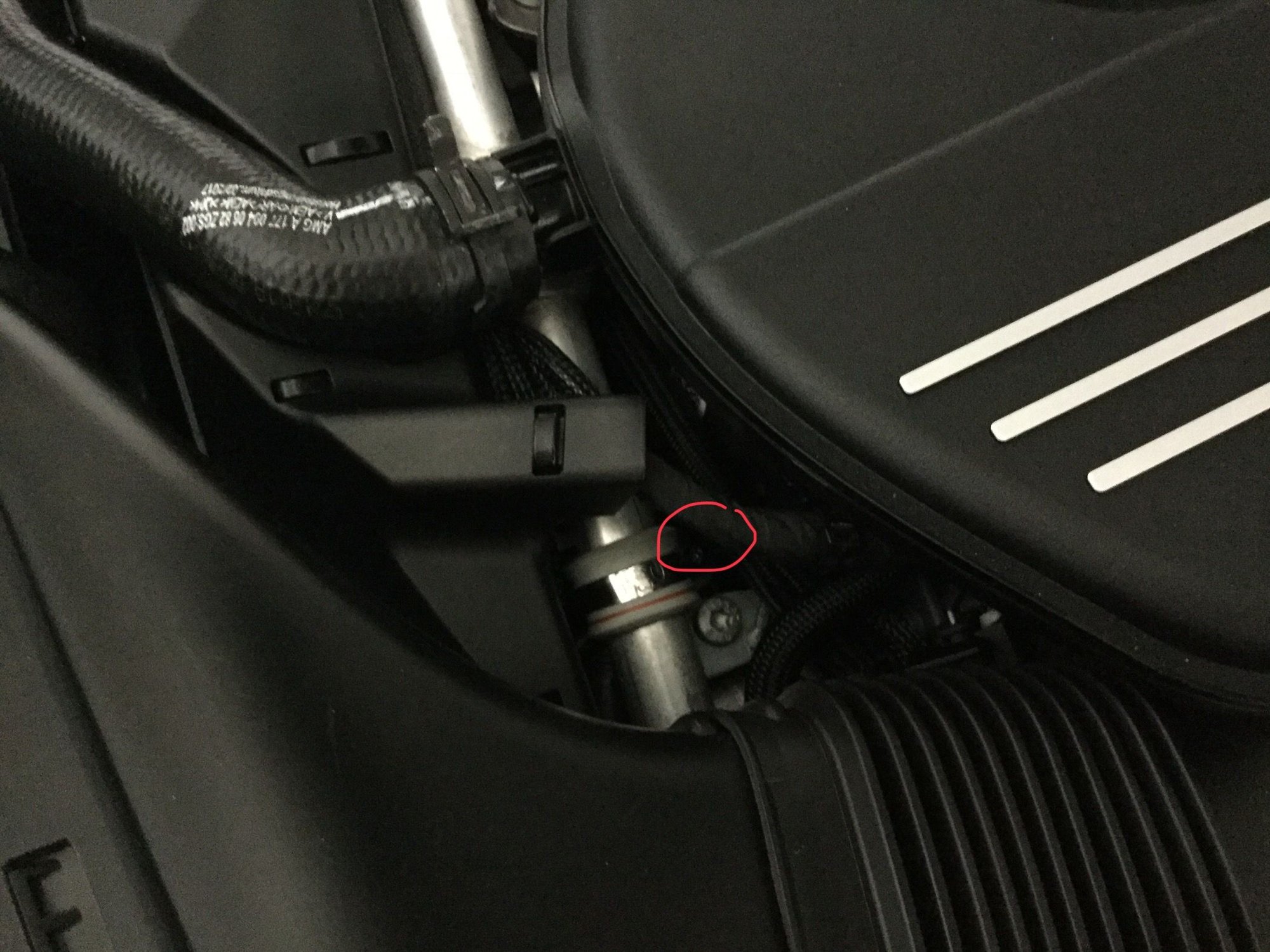

Can anyone tell me who done the installation if the plastic ties depicted in my pic need to be cut to move the harness cover, I see no alternative.

No, you shouldn't need to cut those. There's enough slack to move it a bit to get to the sensors.

I agree with Vaelin. But too be honest it is easier if they are cut. But not worth it to cut since redoing the zip ties is a HUGE pain.

I have loosened everything as much as I can. I may have to take off connectors to provide more slack ( which I prefer not to do). I will call Dinan tomorrow. Their intructions show arrows to the areas where the sensors are but I do see the harness pulled to the side in any of their pics. At least 3 inches of slack is need to get to both passenger side sensors. I have done many upgrades,but this one is not easy as the instructions depict.

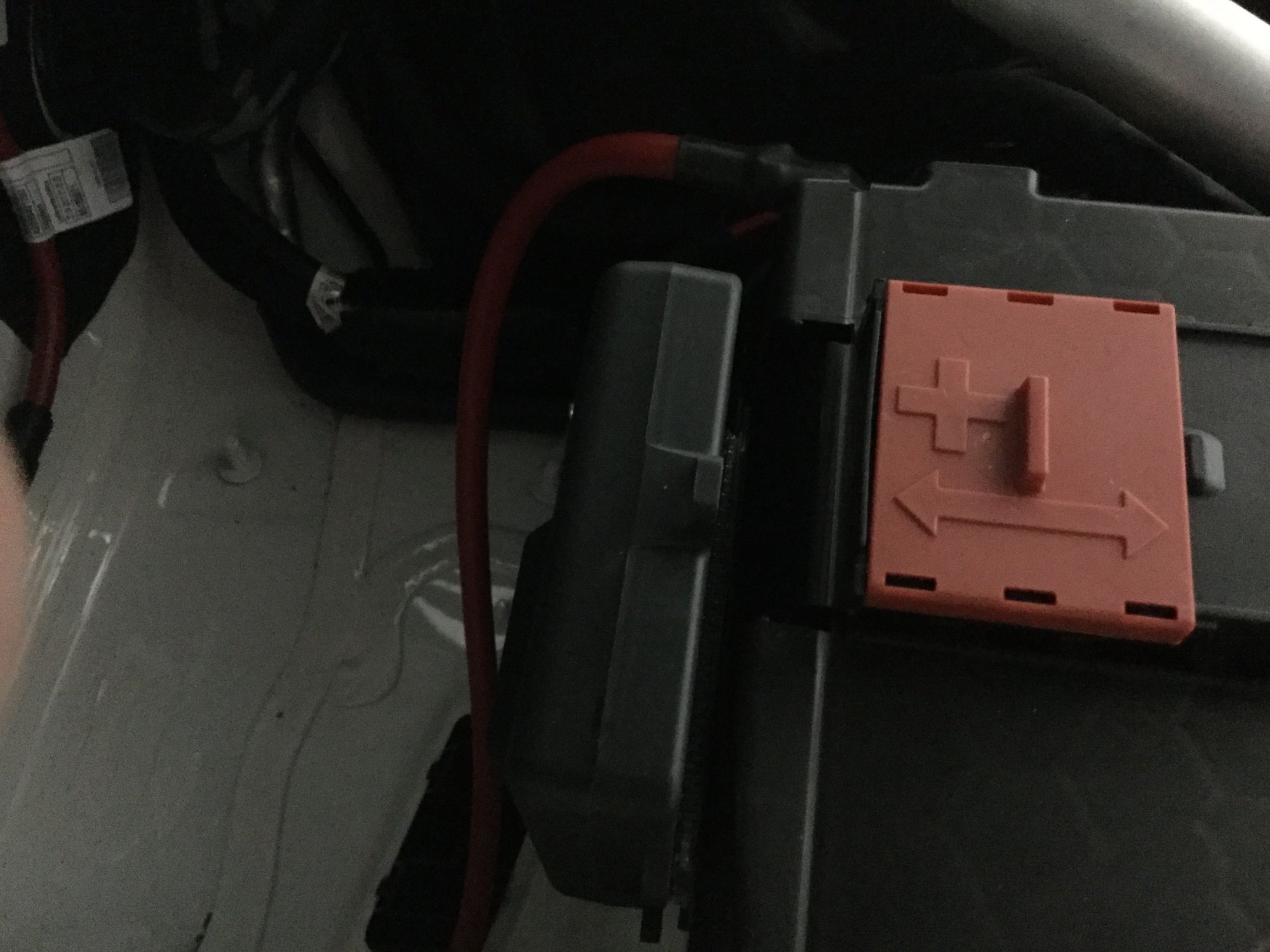

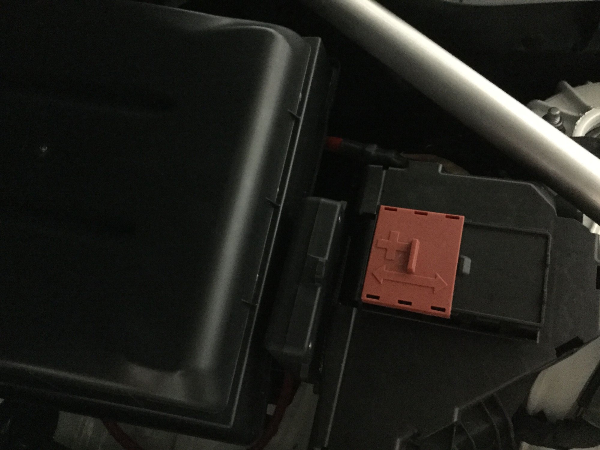

Here are two views...between cabin air filter and positive pole connect...

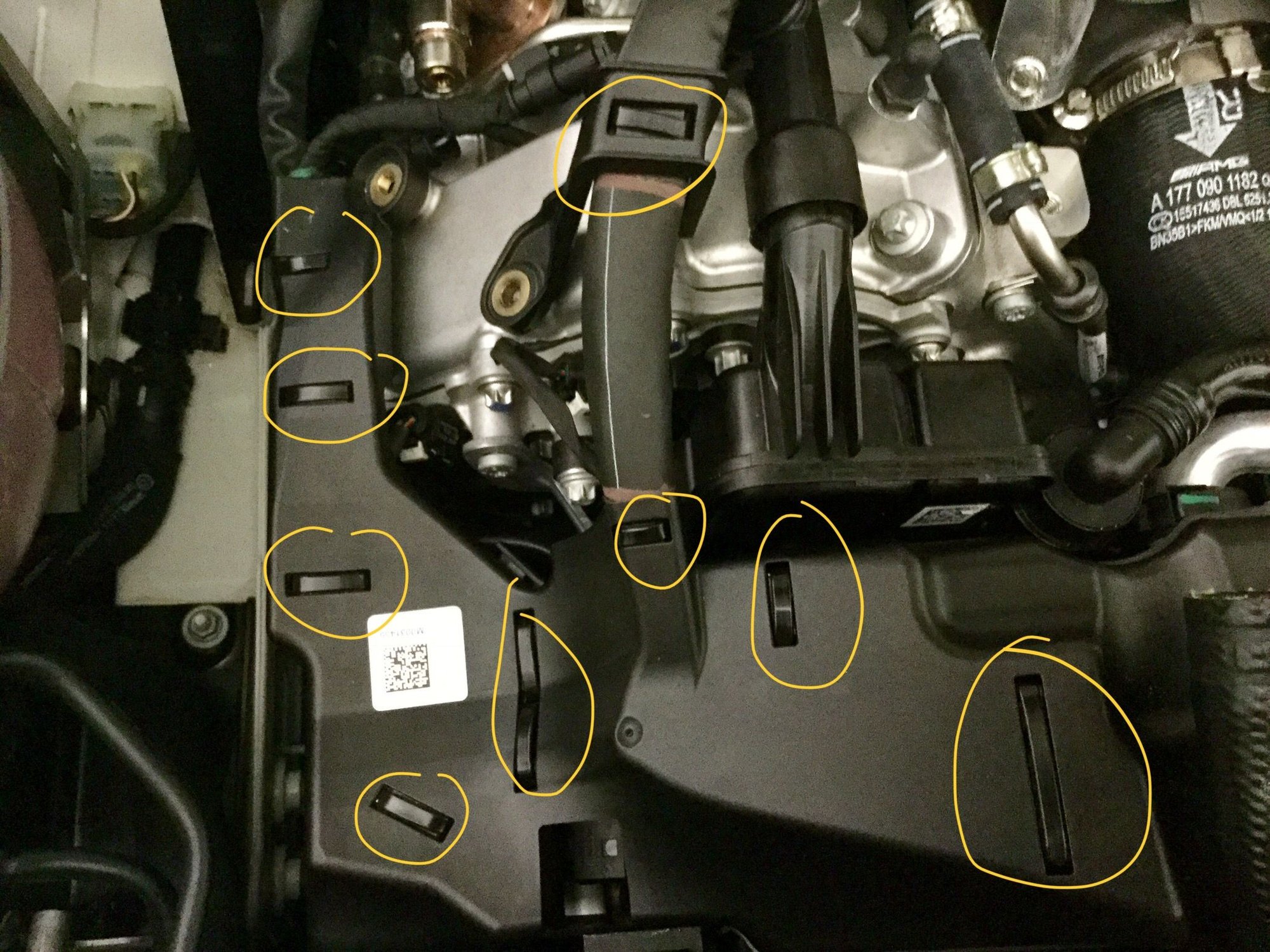

Insofar as the remaining black screw...check the aluminum piping bracket.

That was it! Thanks! Also mounted the ECU where you did

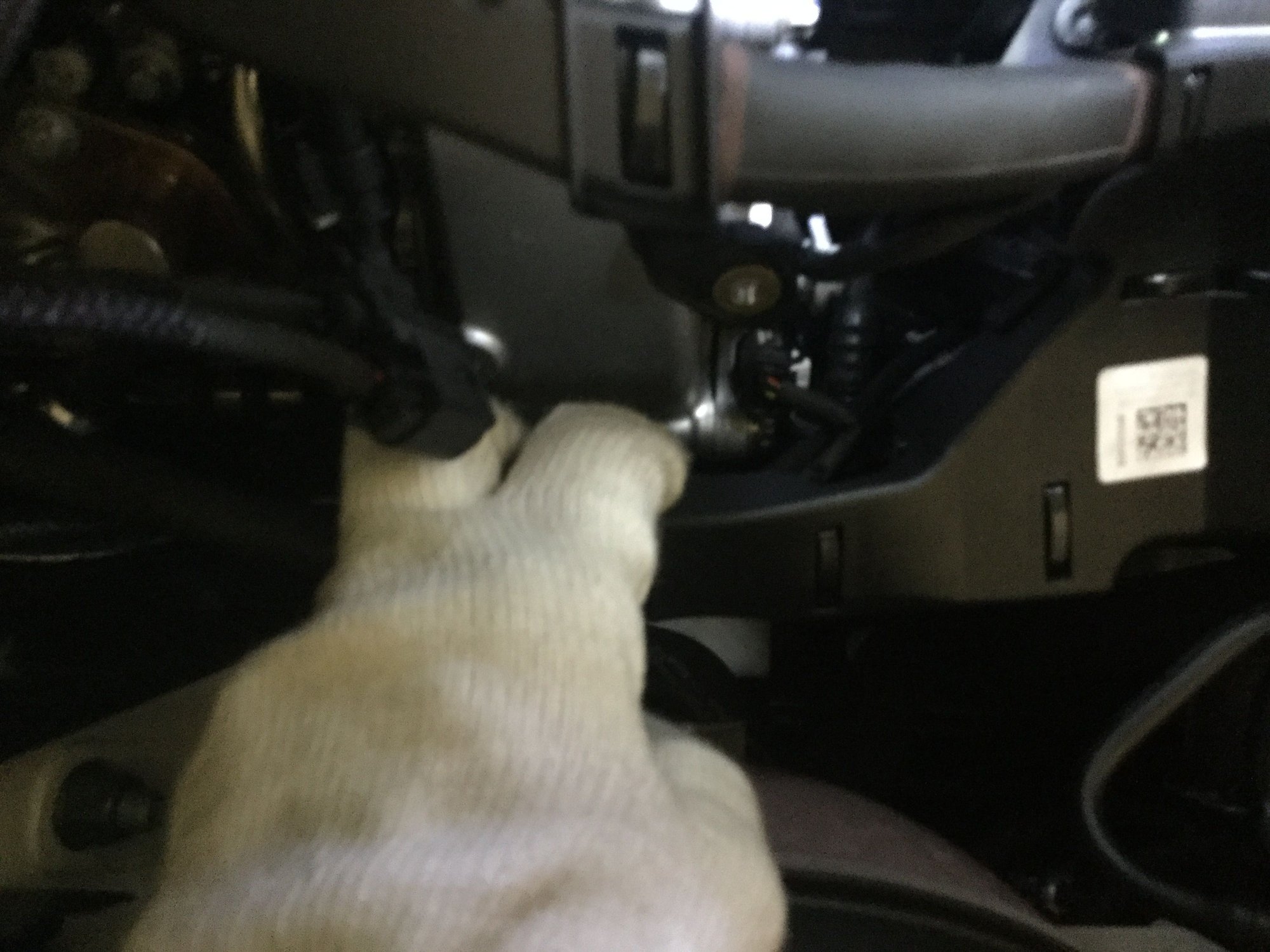

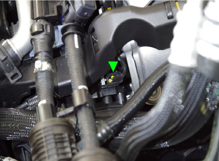

Can anyone help me? I have been stuck with this map sensor 4 for a while. It is very deep unlike the one on the instructions.
