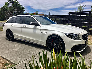

Above is at standard ride height. It usually sits on KW has set at the lowest on the rear. I’ll post more pictures when they’re refitted along with the K-Mac order that’s just arrived.

Originally Posted by JaeJin Sohn
OMG YOU HAVE THE WAGON!!! I am a sucker for European wagons and I really really wish that it becomes more available in the US. Anyway, a sick car you have there (I might also be biased because I just LOVE wagons lol). I don't know if wagons have the same width and suspension geometry and fitment as the Sedans but 20x10 +38 for a sedan would probably be a little too aggressive and poke unless you stretch tire.
as far as I know they’re the same with regards to the rear end drivetrain.

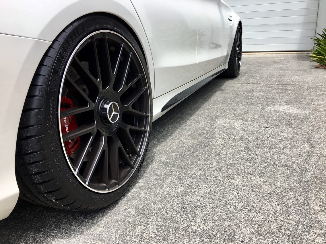

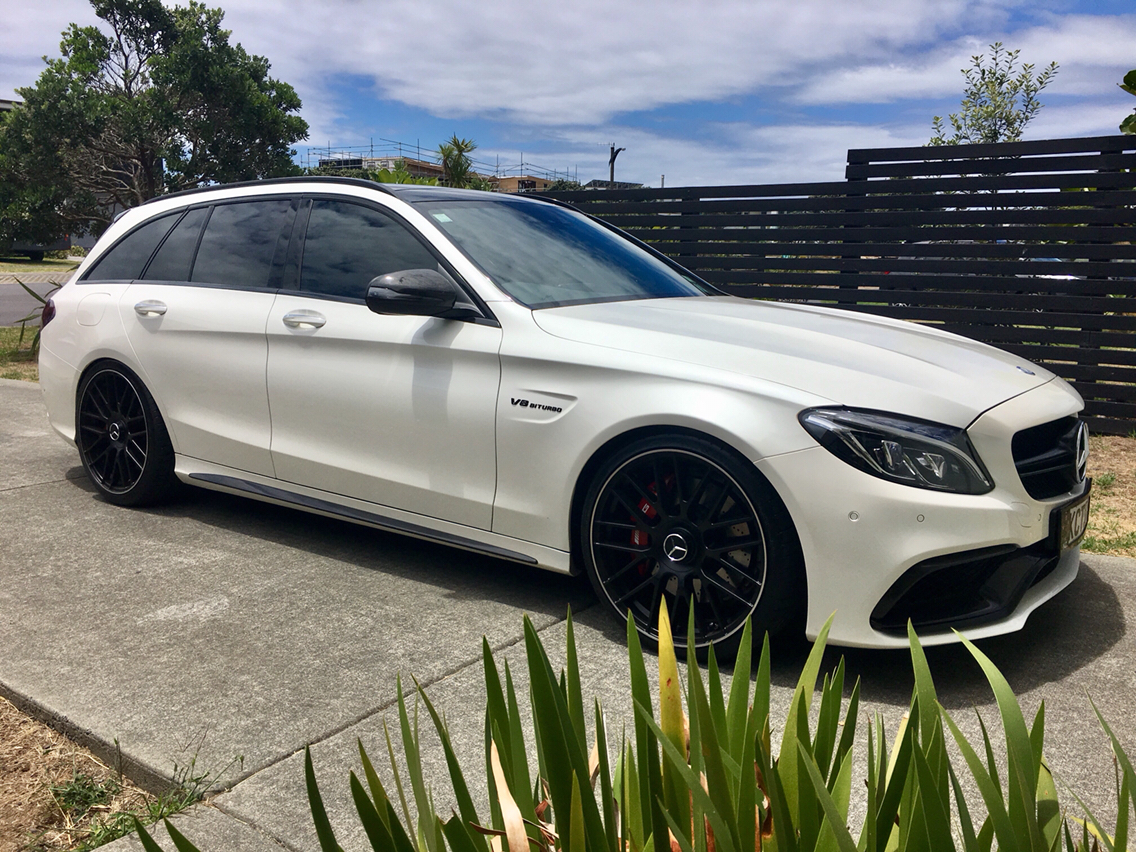

I'm also running +48 offset in the rear on 9.5 x 20" wheels with 285 PS4S. Fitment is perfect. Don't think you could go more aggressive without it rubbing. Here is a pic with the KWs on the lowest setting. I have since raised it 10mm to make it more compliant as a daily driver.
The fronts in the photo are 8.5" x 20 +38 offset. They needed to be pushed out so I got a 15mm hub centric spacer which is slightly too aggressive for me. I think 10 - 12 mm would be ideal. I don't have a photo with the spacers. Just about to get the KMac kit fitted to the front. The negative camber is eating the tyres and low speed steering is terrible. Hope this helps.
