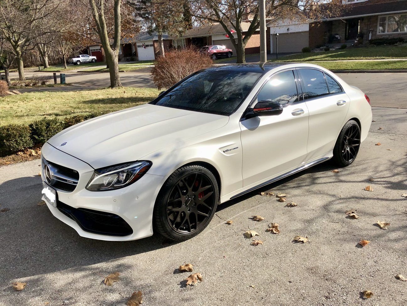

If you go with cast wheels, make sure the shop you go to "guarantee's" the wheels will fit.
I had a shop that said a set of cast wheels would fit for my winter wheels and the drop lip (added for strength since the wheel was cast) was touching the brake caliper.
They gave me back my money and ordered another set (the ones in the picture) that fit perfectly.
Looking at some flowform/rotary forged wheels as of now. Like forgestars or a local brand that makes flow form wheels. What brand are yours if you dont mind me asking?
Braelin BR06
Haha i had a feeling those were braelins, i couldnt quite make out hte center cap though, i take it youre canadian aswell? Im looking at the BR10 wheels from braelin, theyre flow formed apparently and i like that design.
Yes, I'm from Toronto!
I got some matte black Mercedes caps for next winter, will have those on for next season!
