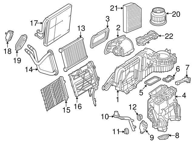

I forgot how I took out Cabin AF, but from the diagram below, it looks like the slanted cut off piece is located on the Top Right when it's reinserted. I took a Sharpie and marked the Arrow directly on the filter (where there was a faint arrow shown) just so you all could see where the arrow location is located on the Cabin Filter.

Here is the Cabin Filter, don't UNDERSTAND the ARROW? I know it to show direction of air-flow, but it's pointing UP? How would anyone know which way the filter was supposed to be installed from that Arrow on the filter?
I didn't pay attention when I removed it, so I had to look at some diagrams to figure out how to reinstall it the correct way.

Just left DEALER, $69.00 for Cabin Air Filter - 10% MBCA discount was $58.65. I read replacing the lower GloveBox Trim was a total B$%^& and wasn't looking forward to it. I also had to figure out which way the cabin replacement filter went backin? There is an arrow but to ME it was useless! I understand it is for air flow direction, but whatever way you pit it, it doesn't match up to how the air is flowing. I watched videos and looked at pictures and figured out the Slanted Cut Off Piece is positioned at the Top Right and I put the new filter in, put the bottom cover on, and locked it in place by sliding the cover.
