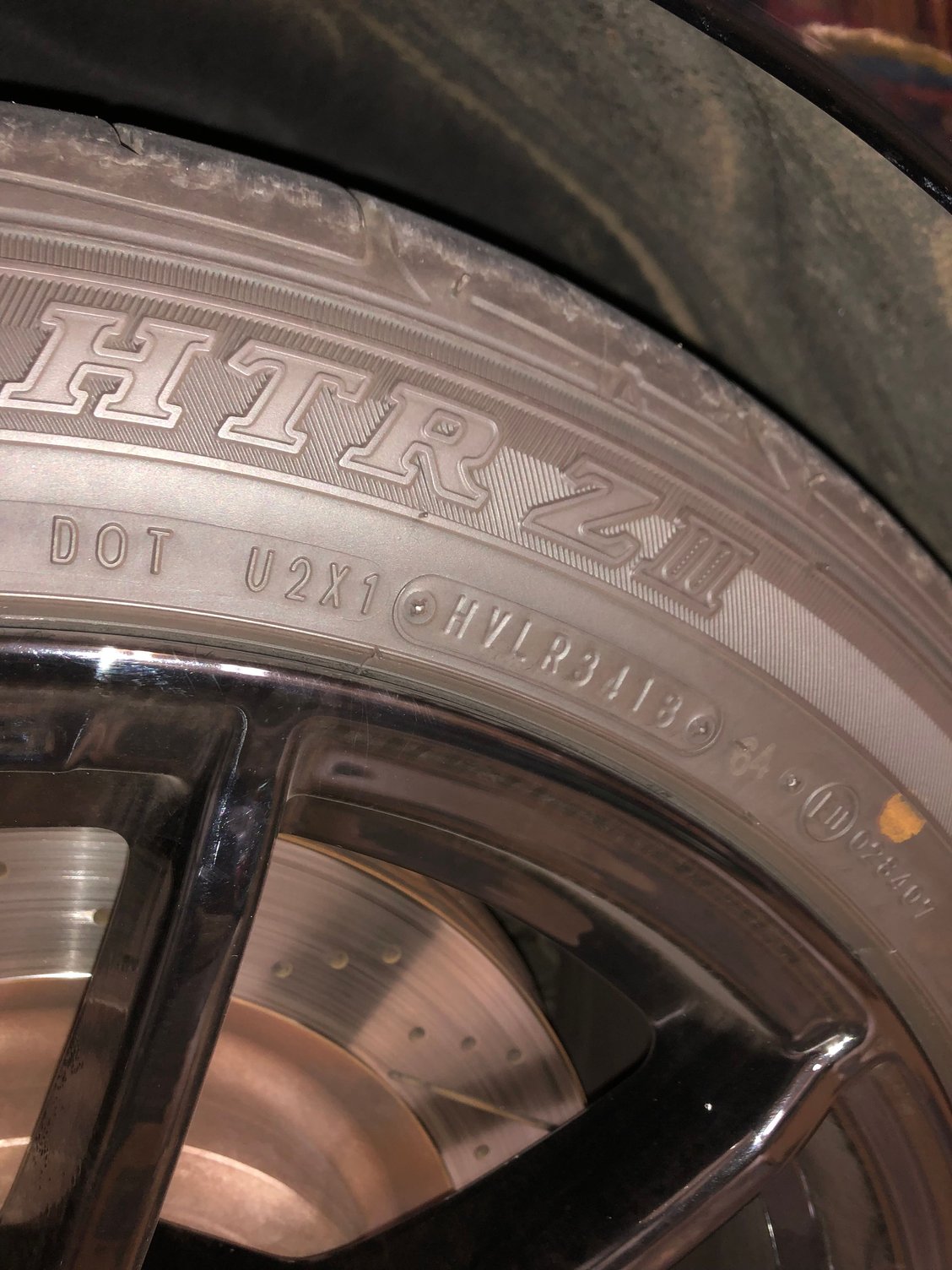

Will Tires make a Huge Difference Ride/Handling?
Car had new Cheap Tires just added when I bought it. Sumitomo. These are approx $100-$125 a tire.
I just noticed the Fronts and Rears are paired up, but have different models on F/R. Have 2,500 miles on the tires now, but as soon as I can, want to get some Michelin Pilot Sport 4S’s.
ON Now:
HTR ZIII Rears (had good reviews)
HTR A/S PO2 Fronts (decent Reviews)

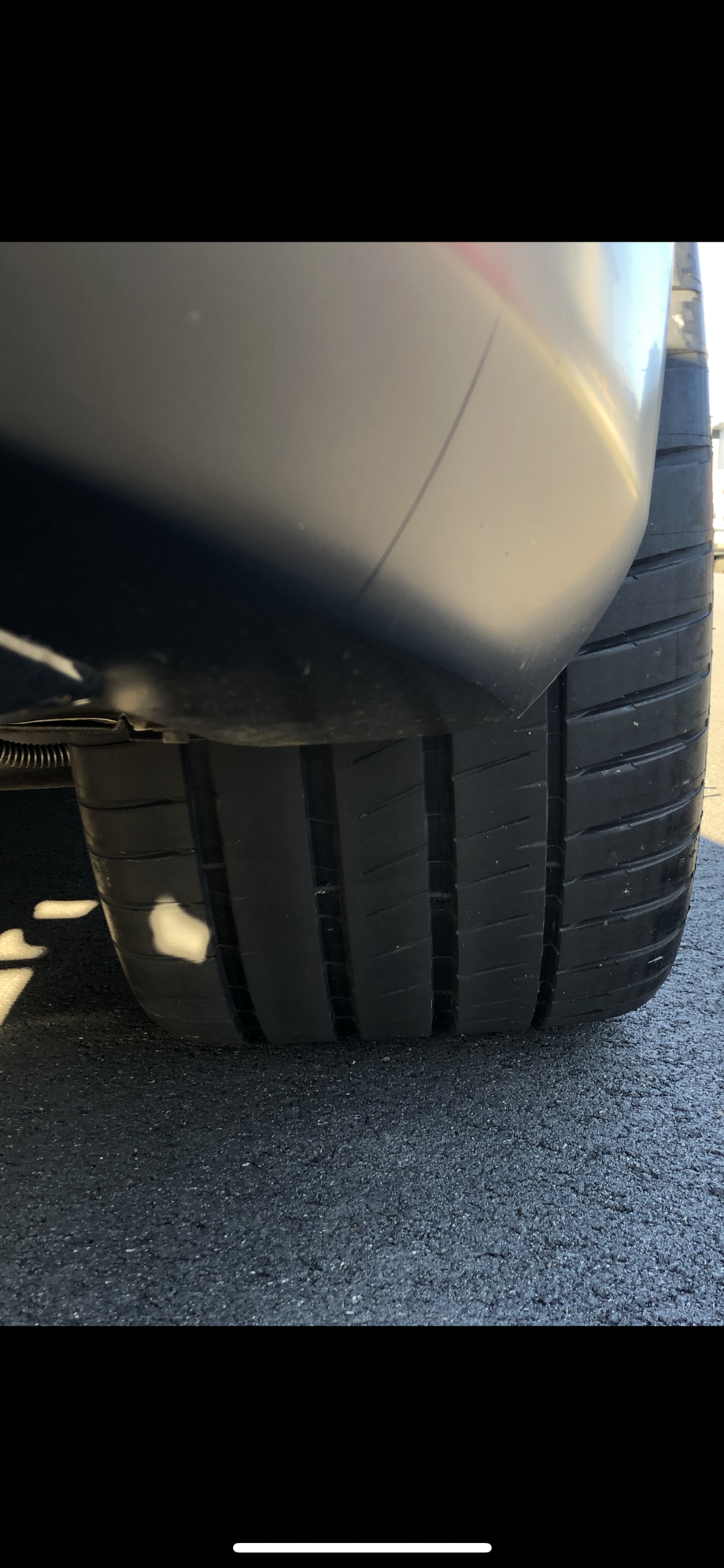

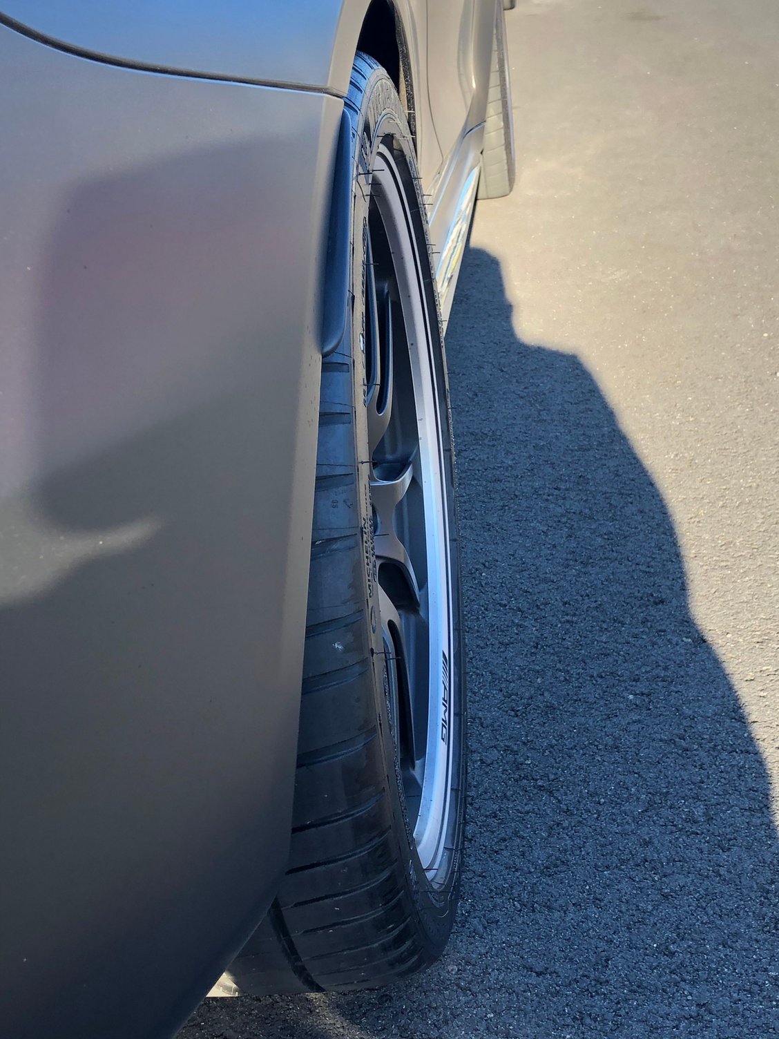

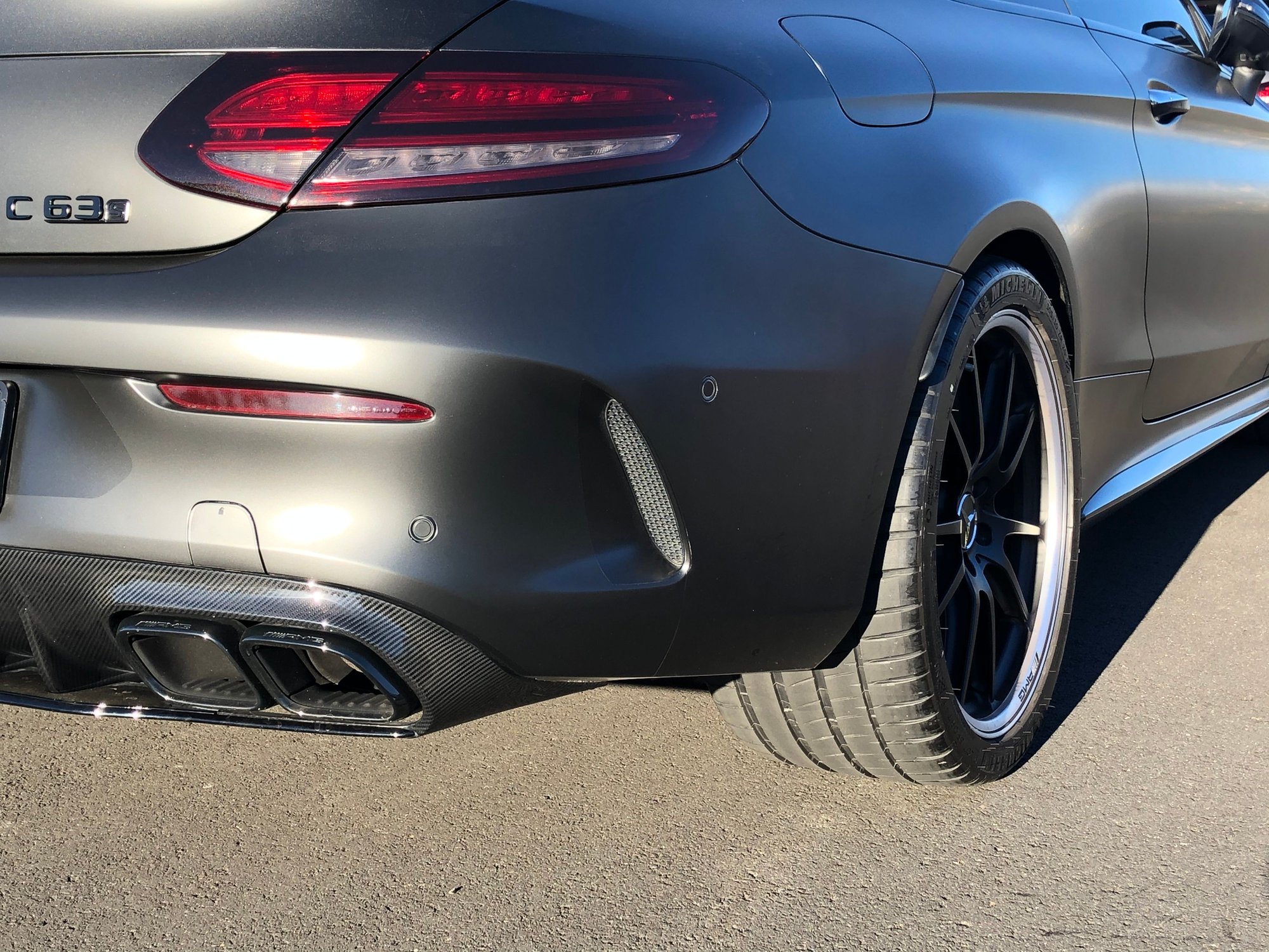

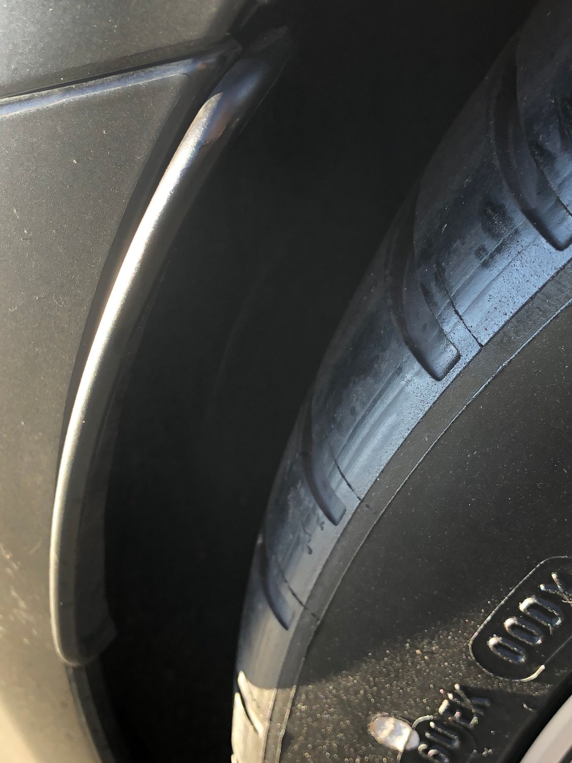

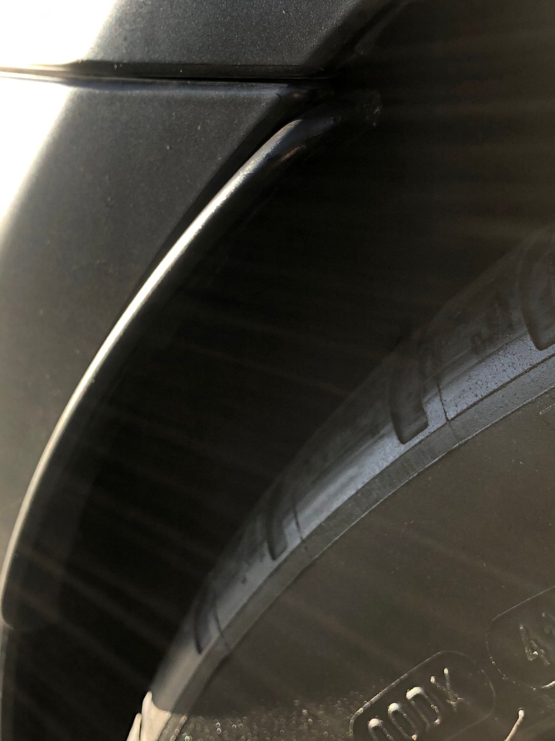

Old Aug 9, 2019 | 02:08 AM
Al718's Avatar
Joined: Mar 2019
Posts: 27
From: Sydney Australia
C63S 2019
Old Aug 9, 2019 | 02:16 AM
superswiss's Avatar
Joined: Nov 2018
Posts: 11,468
Likes: 5,356
From: San Francisco Bay Area
2019 C63CS
Thanks for the pics. Yeah, they stick out quite a bit past the wheel. I don't like that look, but now I see what you mean by plastic protector. We don't have that protector on US spec cars, but it still looks like it's gonna be too close to the rear bumper. Now I also know why I had to sign a waiver to not put chains on it. There's clearly not enough room.
Old Aug 9, 2019 | 02:23 AM
Al718's Avatar
Joined: Mar 2019
Posts: 27
C63S 2019
Yeah definitely no chains. Personally I like the look from the rear, makes it look wider. Anyways I’ll keep driving and see how I go, not sure of any other solution than to drive in sport suspension as that’s what’s currently working with me. Maybe someone has some better ideas. Plus they’re expensive so I don’t want to change again so soon.

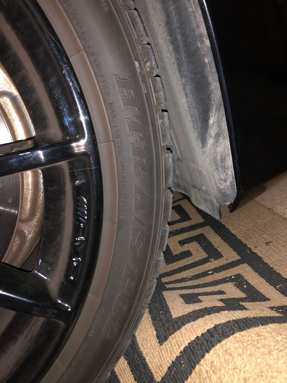

Old Aug 10, 2019 | 05:10 PM
TexasBenzBandit's Avatar
Joined: May 2019
Posts: 313
Likes: 17
From: TEXAS
2017 AMG C63, 2001 C5 Corvette
Just noticed here is what’s on there now.
HTR ZIII Rears. (had good reviews)
HTR A/S PO2 Fronts (decent reviews)

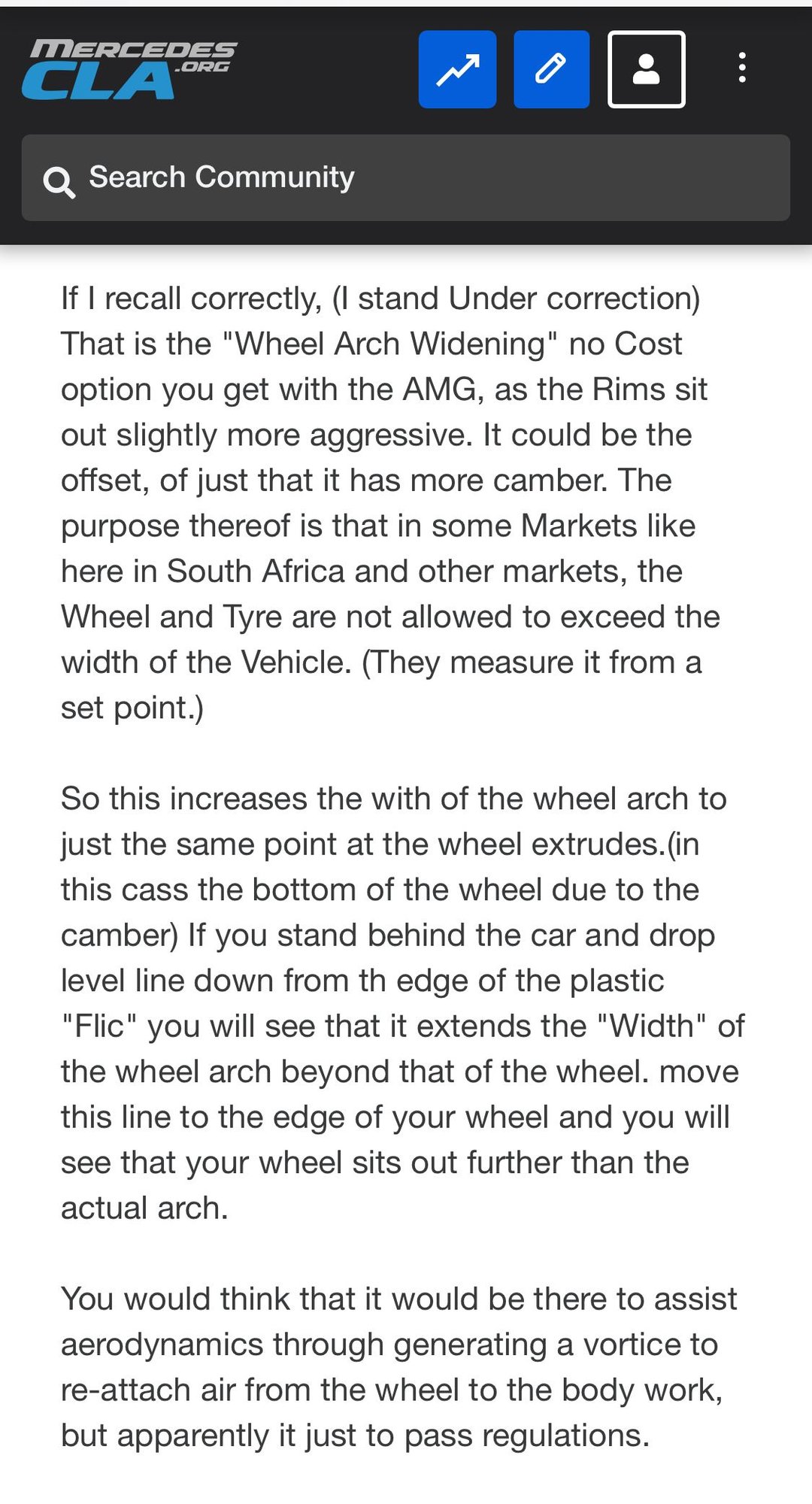

So the problem is that black plastic protector or whatever it is, it overhangs on the inside of the wheel arches causing it to rub on heavy bumps in the road instead of allowing the wheel to sink in behind it. You were saying the US models do not come fitted with these so I think it would be better without them. Not sure why they put them for our models here though.
Old Aug 12, 2019 | 04:40 AM
Al718's Avatar
Joined: Mar 2019
Posts: 27
C63S 2019
So I found this if anyone’s interested, apparently these are the ‘Wheel Arch Widenings’. They’re fitted here just to pass regulations.
