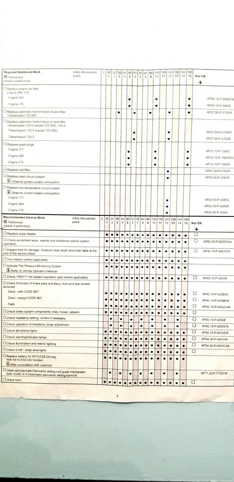

The dealer says it's time to flush the transmission and add new fluid. The car has maybe 40k miles on it. It this something really necessary for these cars?
They also said something similar regarding the spark plugs.
Are these items necessary? They are pretty costly.

For your PFL 2017
- transmission at 30k, spark plugs at 50k according to MB service guide. I got quoted $1200 and $1000 each just earlier this week. - are they needed...well, I suppose you can drive until it breaks but I would follow MB guidance as minimum requirement, our engines and transmissions are expensive....
- brake pads - no, you can change just the pads if the rotors have minimal thickness left (some people here insist on replacing both, which is always good but not necessary of rotors are still within tolerances).

A MB Service Chart showing when Transmission and Spark Plugs are due for change. Note: Transmission is different with model number. Hope you can read photos.
