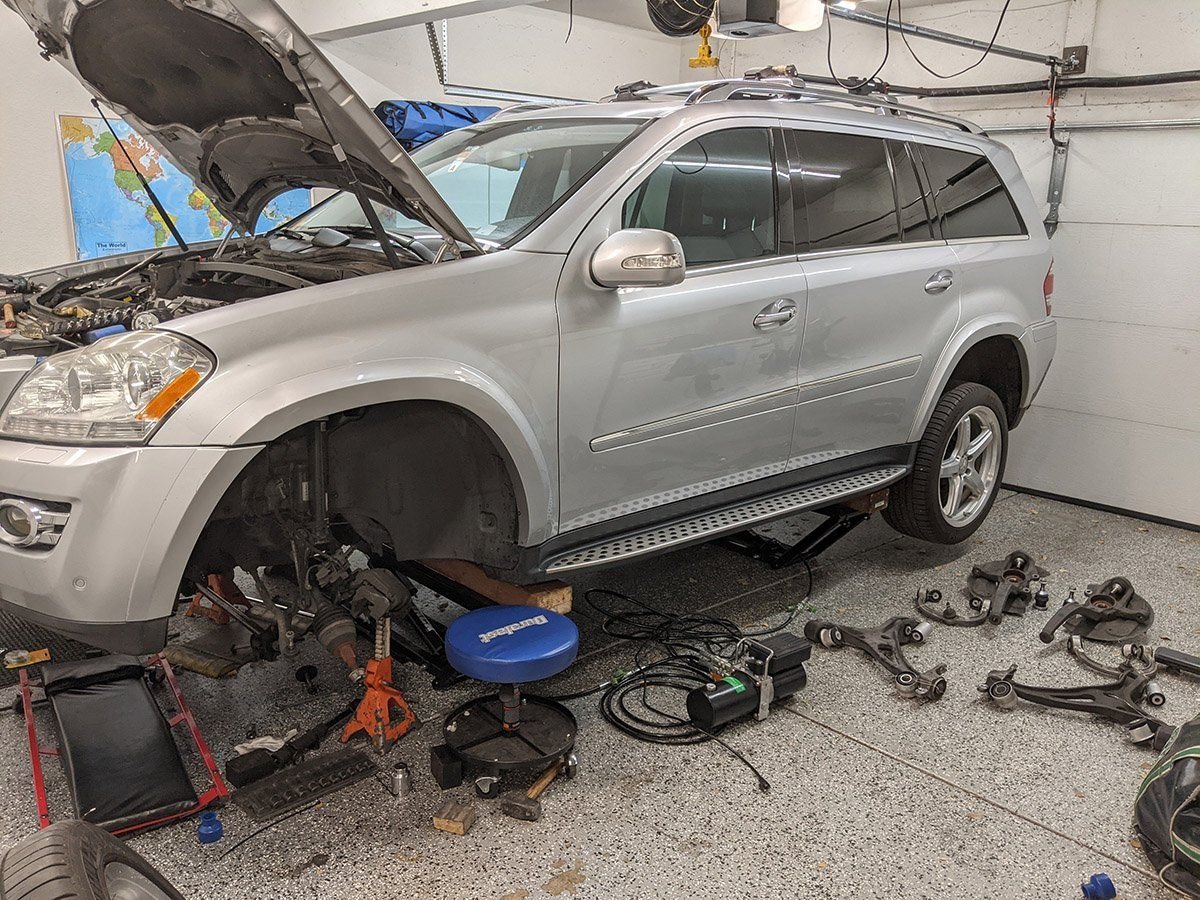

I am wondering if it will be safe to lift vehicle on pinch welds with QuickJack. I have a long wheel base on my GL and non on QJ have reach them out. However, QJ customer service suggested to place the rubber mats under pinch welds to lift the car. Is that safe? Any ideas?

Pinch weld is covered by running board plastics. I can put the solid rubber blocks that came with the quick jack. The main question is if the pinch weld is strong enough for this operation.
When you remove the plastic cover is it an actual pinch weld or is it a rectangular slot? If it’s just a pinch then I would use the slotted blocks from quick jack. If it’s the slot then use the pucks on the solid block.
I think the weld weld is strong enough either way but it’s more stable and safer to use the slotted blocks or the solid plus the puck.
It is an actual pinch weld, not rectangular slot. Unfortunately, I cannot remove the plastic easily since it will require to remove the running board first. I think I can just put the slotted blocks on top of the plastics. That plastic sits on the pinch weld. It can be deformed a little bit but I don't think it is going to be much. The only worry if the pinch weld and the area around it will handle the weight of the vehicle.

If you could post a picture it might be a little easier to help. I’d hate to tell you to do something that isn’t safe or causes damage to your car.

Here is the image of the pinch weld running behind plastic cover. One small area will be exposed.

Wow. That is a very small exposed area. Do a test fit with the slotted rubber block if you can get it on there I think it will work...I also think you will crack some of the plastic surrounding the pinch weld. Mercedes makes it hard for us to wrench on these ourselves.
If you can think of any other questions just post up and I'll do my best to help. I've lifted 4 different vehicles with my quick jack and the prevailing idea is, if it looks like it might be a bad idea...it is a bad idea. Stay safe sir and let me know if I can help further.

There is no way that pinch weld can fit into slotted rubber blocks there unless I will remove plastic covers of the running boards. It also will not make sense to lift the car with QJ if it requires to take off running boards in order to lift the car. I can try to use solid blocks to place them on top of the plastic covers. However, I am not sure the area around pinch welds is consistently strong everywhere to handle the weight of the vehicle. Perhaps, I should consider to build a custom extension or just not to buy QJ at all.

Yeah, since you haven’t purchased the Quick Jack yet, I would skip it...I think you will damage the car lifting it without removing the running boards.

So I just used the jack and placed it in the small area to lift it. Just have a ladder right under that rail area just in case. It didn’t budge at all

Clamelken2, what vehicle is that? It can be much lighter one.

Thats my c63 coupe

FYI, I see people are using 4x4 lumber like in the picture with QuickJack BL-7000SLX. I decided to make metal extension as soon as I will have time for this. It is not that complicated.
Interesting, I didn't know you could put them sideways. I guess that makes sense.
