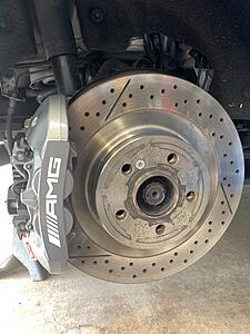

Rust on rear wheels drums, solutions?
I have my 2019 c63s coupe since april 2019 and keep get rust on inside both rear wheel not sure if it's the drums or rotors.(photos) It's not causing any mechanical concerns but cosmetically it's an eye sore. I like to know if other here have has this issue and suggestion on how to permanently correct it? high temp. paint?

Those aren't drums the rust is on the rotor hat. Not much you can do other than to clean it, prime it, and paint it. That's happened to all my cars.

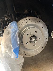

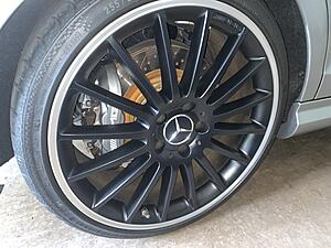

I know i'm replying to this 8 months too late, but I recently did a less involved process compared to what Grant posted. I just picked up a 2012 C63 a few weeks back and the front & rear brakes had just been done prior to purchase. Not even 100 miles in and all 4 rotors were beginning to become a rusty orange eye sore. I used some Brakleen, steel wool and VHT caliper paint to get the job done. I took some before & after pics, overall i'm happy with the end result - it got rid of the rust and protected the rotor hats.

A bit late to the game, too, but yeah, not much you can do about this other than driving in less corrosive environments or coating the material. With the rear rotors being single piece, the hat is steel, so it'll rust. On the C63 S, the front rotors are two piece with the hat made out of aluminum, so no rust. One way to avoid this is to put two piece rotors on the rear as well with an aluminum hat. But rusty brakes all comes down to the environment you drive in. Below are my original rear rotors at near 30k miles here in the dry Northern California climate, despite living right next to the Pacific Ocean. They stay rust free without the corrosives found in climates with snow and salt on the roads.

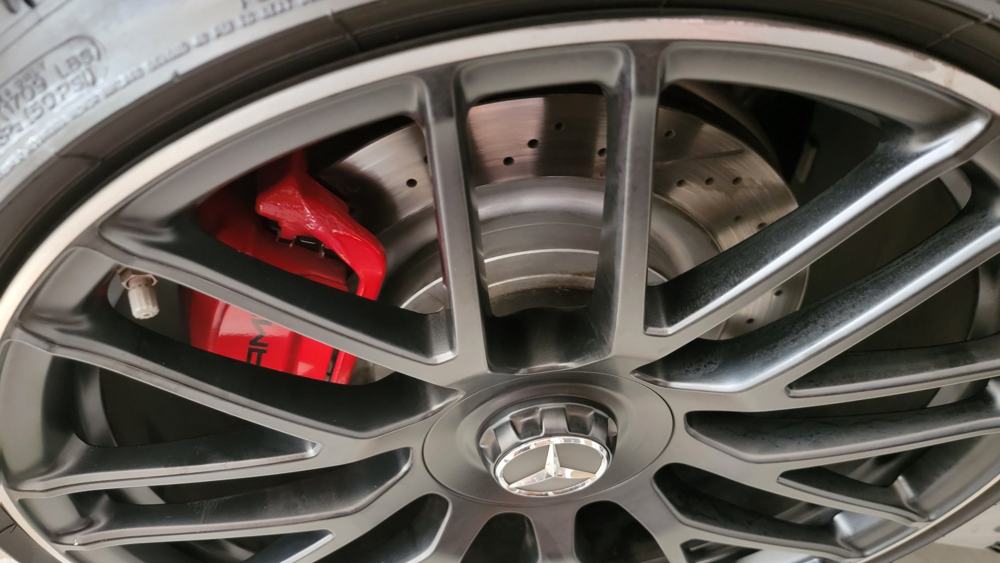

*****I did the same after using a wire wheel brush to scrape off all of the rust and doing some metal prep for the VHT to stick better. My car came from Chicago and the previous owner drove the car in the snow a couple of times I think as the undercarriage area above the pan cover had salt marks on it, etc.. I washed everything thoroughly before buttoning all back up again.
I'll take some pics later but I am really happy with how everything came out!
