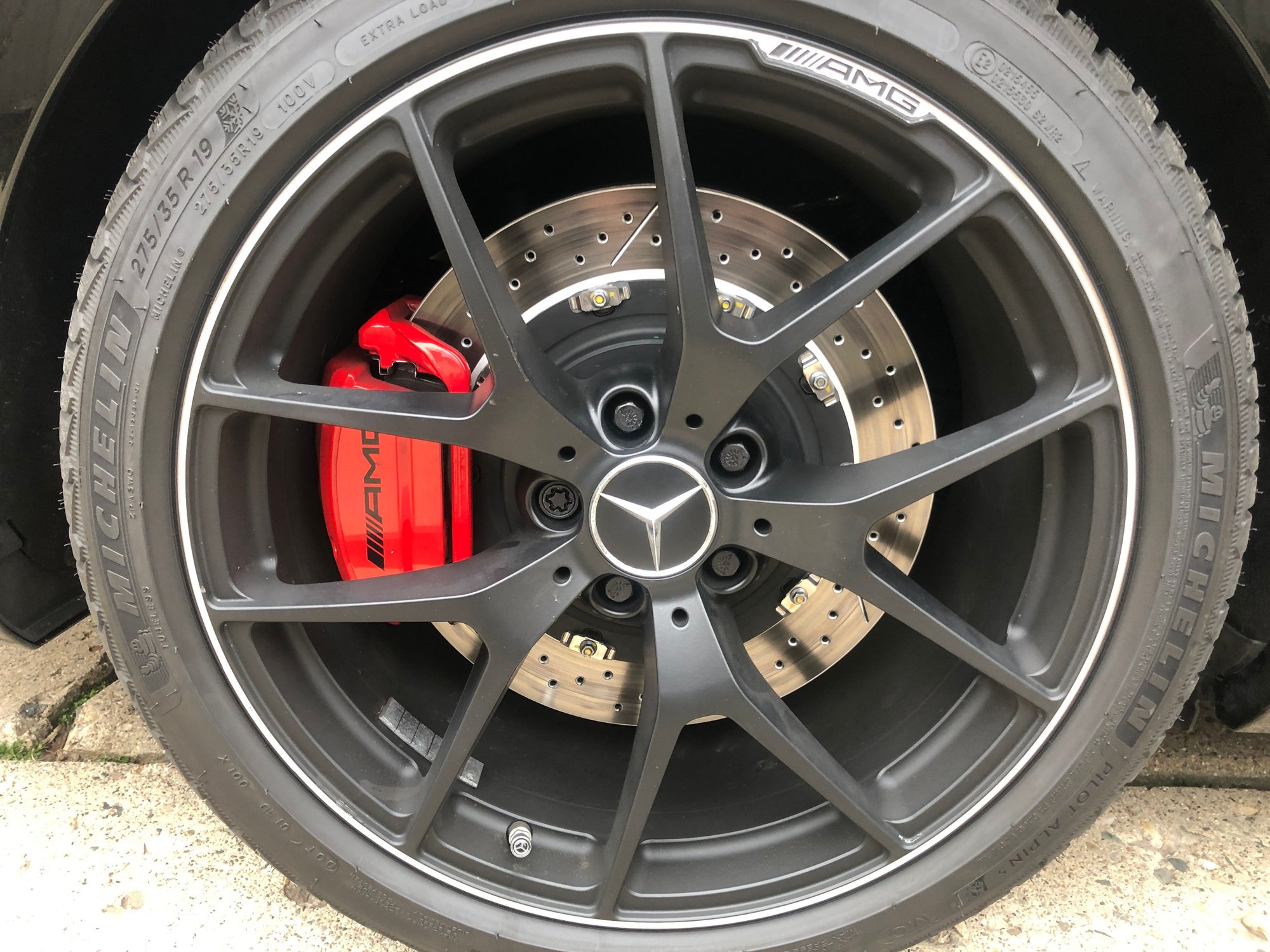

2 piece brembo rotors with custom machined hat on my c43
