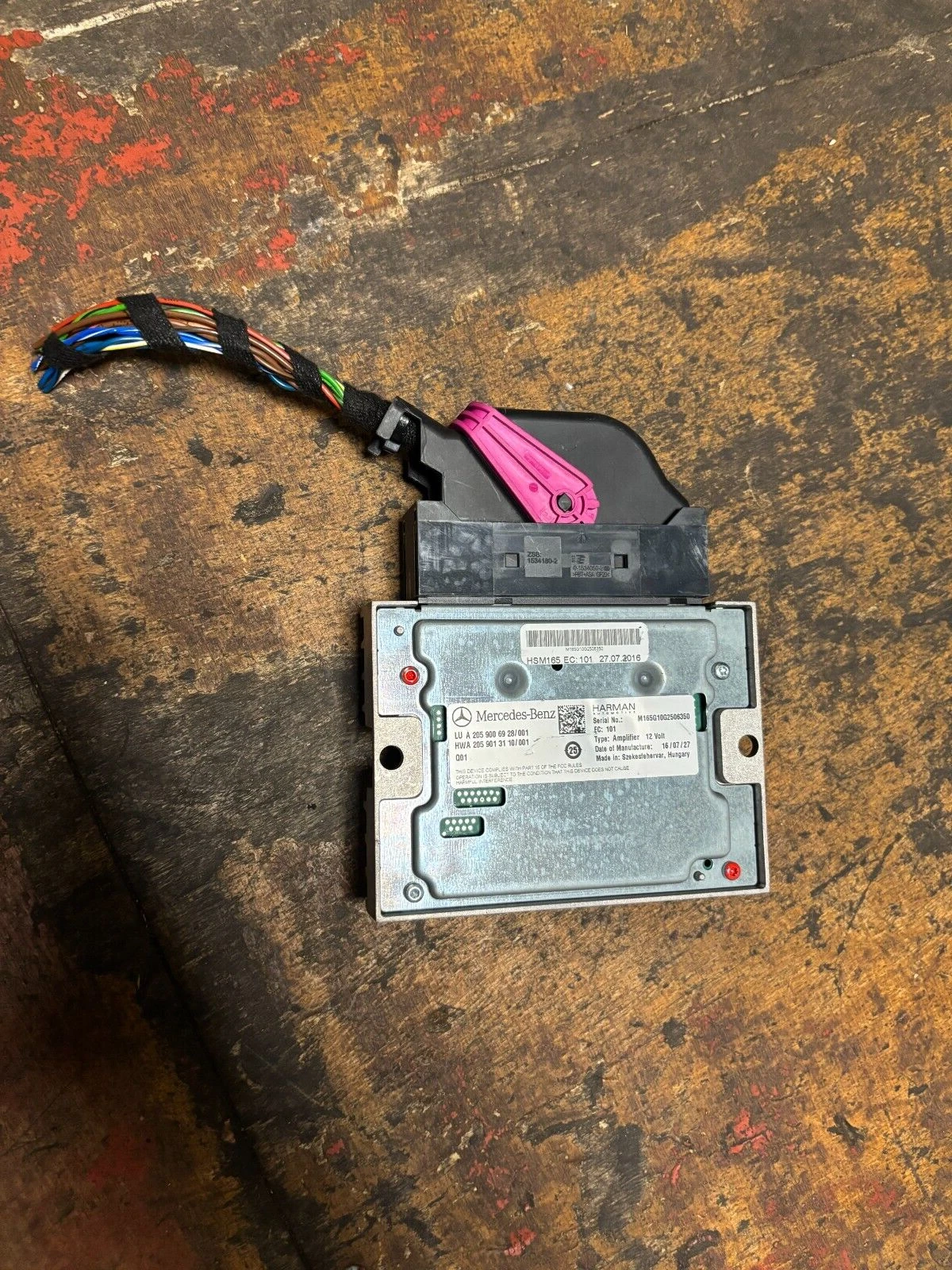

It looks like these things plug straight in, so the first thing to attempt would be a simple unplugging.
Old May 27, 2025 | 04:01 PM
  #81
W205C43PFL's Avatar
Posts: 32,231
Likes: 6,285
Originally Posted by gfang
https://i.ebayimg.com/images/g/1n0AAOSw~WFnybRS/s-l1600.webp
Could someone try it and report back please? Fair to say I am not a C 63 S owner...

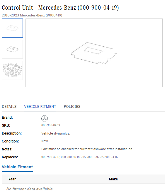

I was just on mbparts.mbusa.com the other day to look for a trim piece that fell off my car. So I got curious and searched for the part number for this supposed sound generator. Firstly, 205-900-69-28 has been discontinued. The new part is 205-900-21-29. Secondly, the vehicle fitment goes all the way back to the PFL, so if this is for fake engine sound, it's there in the PFL as well.
https://mbparts.mbusa.com/oem-parts/...UtOTAwLTY5LTI4
Old May 27, 2025 | 06:00 PM
  #83
W205C43PFL's Avatar
Posts: 32,231
Likes: 6,285
https://cimg6.ibsrv.net/gimg/www.mbw...5eb366f09f.png
This wouldn't have anything to do with noise cancellation right? Don't expect noise cancellation on this vehicle.
Unless the PFL have this module just not working as actively as the facelift or maybe they changed the sound it generates.

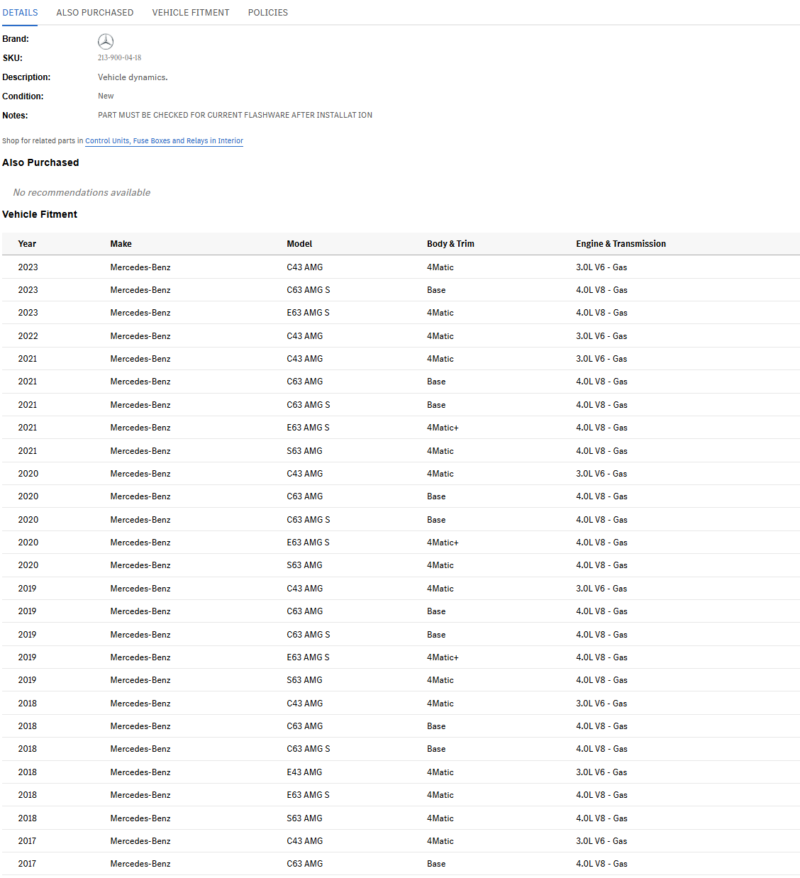

I think I mentioned it in one of my above posts, but 205-900-69-28 is not included in the PFL cars. Vehicle fitment on mbparts.mbusa.com only indicates that the part can be retrofitted to the vehicle, not that it was originally included on the vehicle. For example, the vehicle dynamics control unit is not originally a component present on the PFL cars, which makes sense since the PFL cars do not have AMG Dynamics. However, both the control units for vehicle dynamics and the sound generator appear with vehicle fitment for the PFL cars on mbparts.mbusa.com. Here is one of several vehicle dynamics modules with fitment for the C63S on mbparts.mbusa.com:
The original vehicle dynamics control unit that is included on FL C63S models appears with no vehicle fitment at all:
Some other instances of the vehicle dynamics control module with fitment for the PFL C63S can be found here:
https://mbparts.mbusa.com/oem-parts/...QtMGwtdjgtZ2Fz
With that being the case we are essentially back to square one of nobody really knowing what this module does and which VINs have it. While it can be fitted on a FL, it may not be standard equipment, just like the OPF is not present in some markets. Mercedes themselves said as much that it is an optional part on that other thread that was linked somewhere above. I guess it's nice to speculate at times, but nobody seems to have definitely tied this part to a specific FL VIN, or did I miss something? Fun discussion, though. I still prefer how the FL sounds .
Old May 27, 2025 | 08:35 PM
  #90
gfang's Avatar
Joined: May 2025
Posts: 10
From: Toronto
Yeah, unfortunately, Mercedes discontinued the EPC and replaced it with Xentry, so none of the third-party sites that used the EPC API can identify components present on specific FL cars by VIN. I used partsouq.com to confirm that both the sound generator and vehicle dynamics control units are not present on PFLs (or at least not present on any of the 4 PFL coupes from 2018 for the Canadian market that I tested it on), but I haven't been able to do the same with FL cars.
