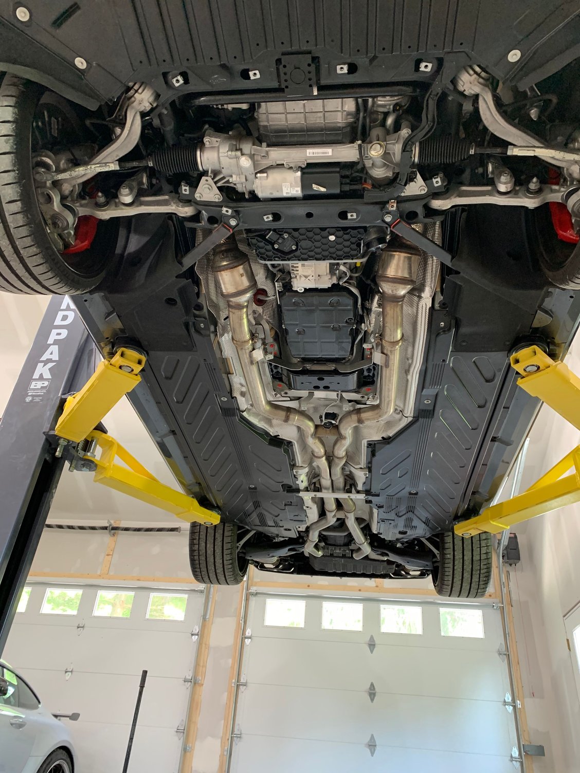

Are these bolt on or do we need to cut the stock exhaust?
Old Aug 5, 2020 | 11:03 AM
  #91
Rochviper's Avatar
Joined: Jun 2019
Posts: 61
2017 C63S AMG Coupe

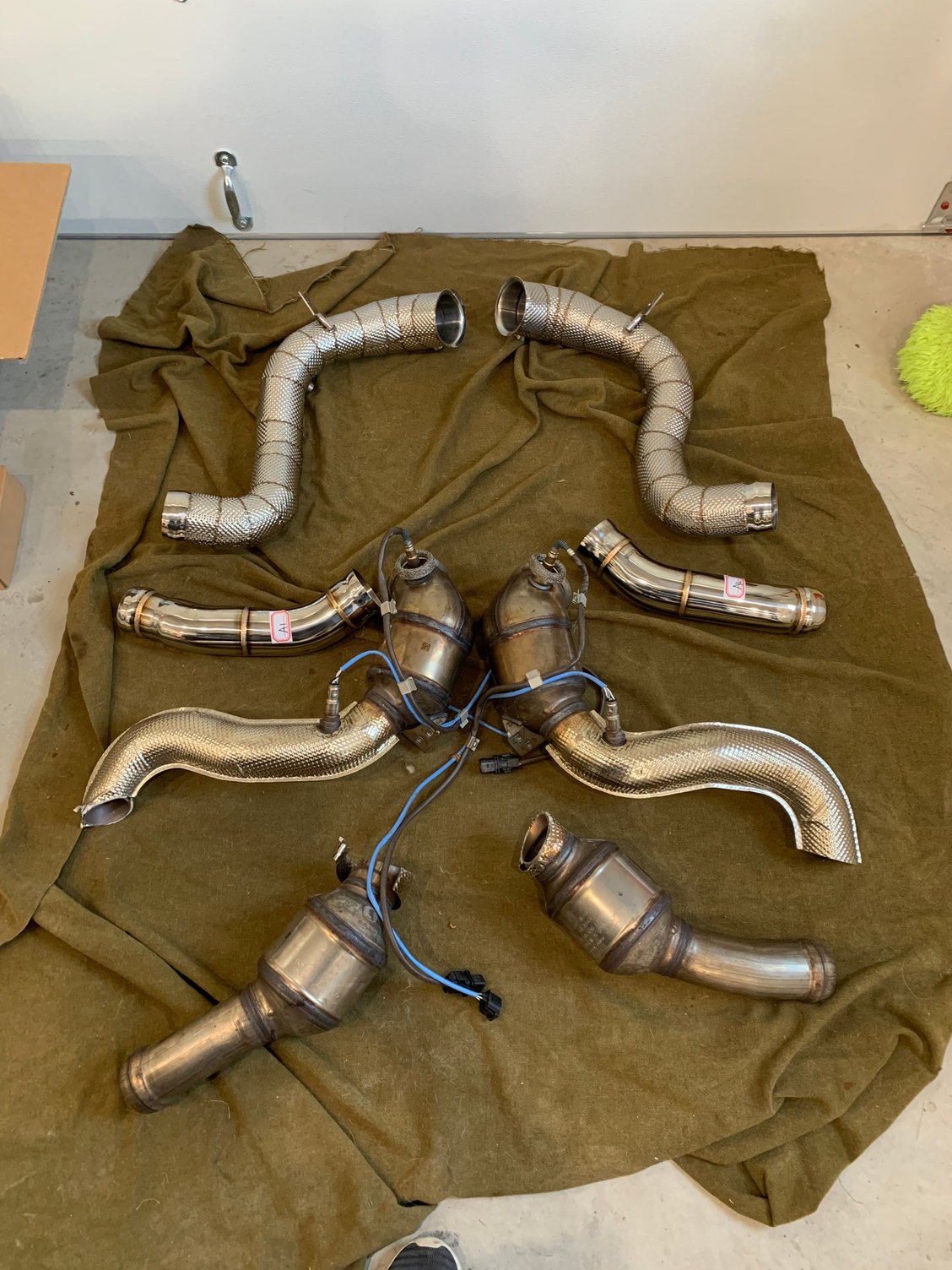

You either cut the stock units out or you have to drop the transmission to remove the stock downpipes/cats without cutting.

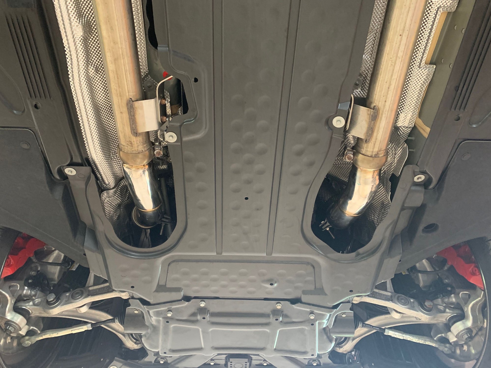

I see any pictures of under the car? I just got a c63 and want to see what I'm getting into .
Old Aug 5, 2020 | 11:20 AM
  #93
Rochviper's Avatar
Joined: Jun 2019
Posts: 61
2017 C63S AMG Coupe
Old Aug 5, 2020 | 12:25 PM

Thank you! So the down pipes have the primary and secondary cats on them.
Anyone successfully use spacers to not through a code? My state will flag your car if a monitor is turned off.
Old Aug 5, 2020 | 12:34 PM
  #95
Rochviper's Avatar
Joined: Jun 2019
Posts: 61
2017 C63S AMG Coupe
Yes. Cuts were made just above the secondary cats of my system to remove.

Im in the process of installing these DPs, everything was going smooth until it came time to remove the stock DPs and find a way to snake them out, it was a pain. The driver’s side one gave me the most issues since the steering column is in the way. All I can suggest for people that are going to do this is when you are cutting the stock DPs from the bottom cut as high as you can after the secondary cat.
The bracket that the DPs are connected to is also dumb, i had to take off screws from under the car.
I finally took the stock DPs off, now im stuck getting the driver’s side catless DP installed, the steering column is in the way again, i know i just have to keep on playing with it and it will eventually go through just a pain.
That was all yesterday, after I get home from work ill try again. In my opinion if snaking the DPs in and out wasn’t a pain this would be an easy job. But I would rather be going through this than paying someone $700 to do it for me lol
