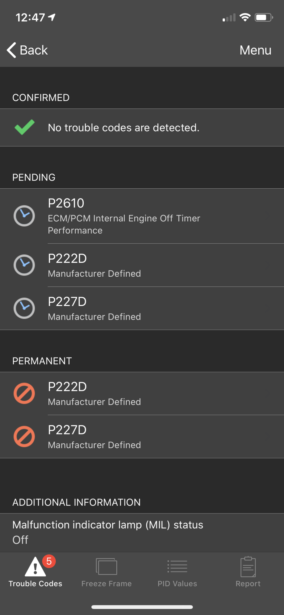

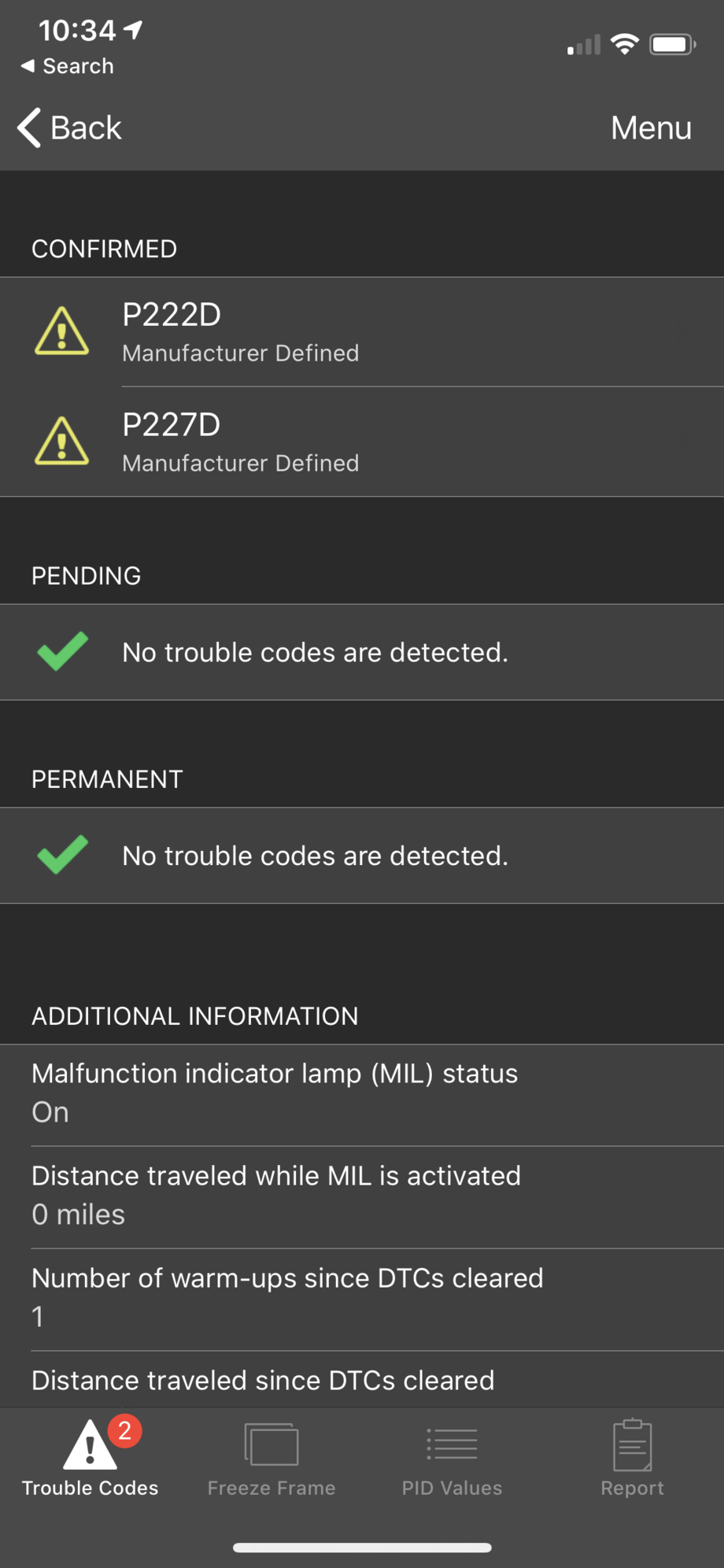

I've been running a Dinan tune without issues for several years (about 10k miles) and just recently started encountering issues with not hitting full boost, feeling a loss of power up top, occasionally going into limp mode, and generally feeling sluggish in acceleration. After long pulls (3rd and 4th) it will throw itself into a limp mode where I can't produce any boost at all. Restarting the car and resetting the codes (P222D & P227D) gets my boost back, but I still feel like there are underlying issues that are causing boost/power to be pulled. After clearing codes and getting boost back, the car feels better but my Dragy results are producing stock numbers - I'm down about 5-6 MPH in the 1/8 and slightly more than that in the 1/4.
I don't feel like the car is misfiring, but I suspect it may be an issue as I am still on stock plugs with a 14,500 miles total (and 10k on the tune). Does anyone have any advice on how to resolve these two codes/loss of boost? Looks like it could be a barometric pressure sensor(s) causing issues. I'm going to bypass my Dinan tune and revert back to stock and see if I still have issues, but I'm hoping someone can point me in the right direction.

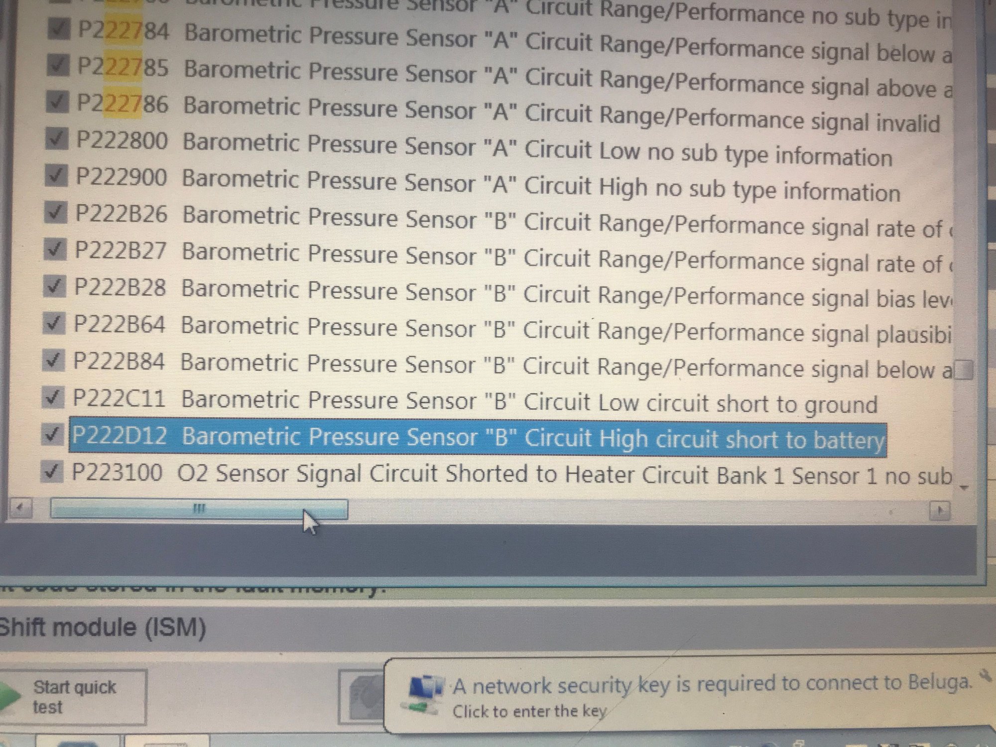

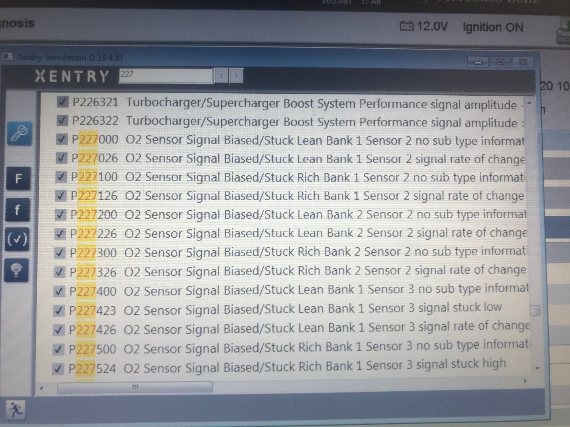

I looked these up using Xentry SIM Because your using a generic OBD reader it’s not super accurate , it looks like there could be an issue with a cable been shorted / chafed through. If reverting it to stock doesn’t clear the codes you’ll prob have to disconnect the piggy back harness and reconnect the factory wiring to the sensors( it’s a pain in the *** I know I’ve done my JB4 a few times)

Thanks zipzap. I put the car to sleep and unplugged the battery to swap in the Dinan bypass plug and revert to stock. After testing, power seems like stock/restored, boost is hitting max, and I didn't go into a limp mode after doing some higher gear pulls.
But these codes still popped back on, along with a new one for the PCM. The dealership is going to pick up from my home since I'm still under warranty, so I'll be popping off the Dinan harness to go back to stock (I've also done this 4-5 times, always a bit annoying, but I've gotten pretty good at it by now).
Car has run flawlessly with the Dinan tune up until now, so I'm wondering if it's plug/spark related (when more boost is being requested).
