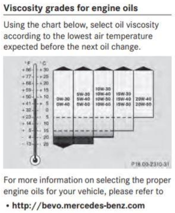

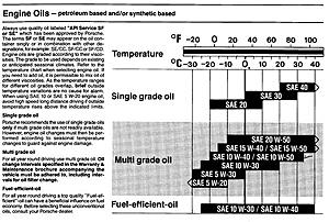

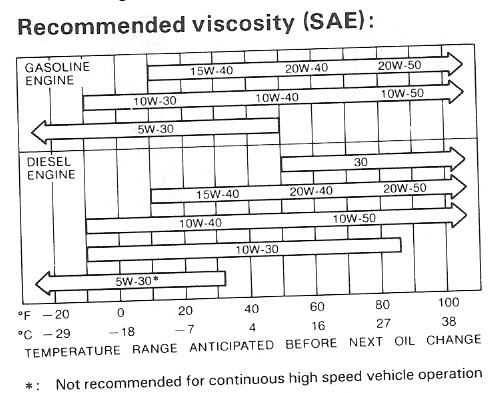

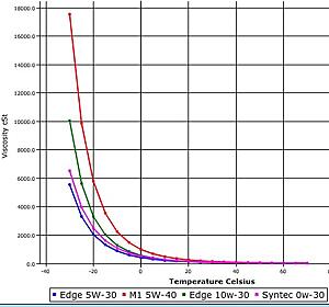

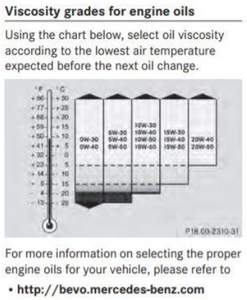

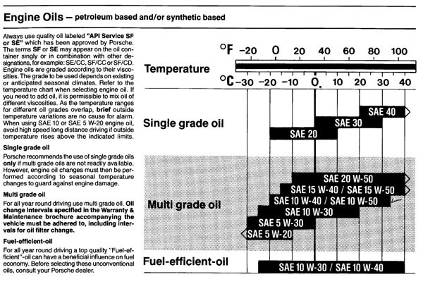

Different viscosity than what?
In cold, the oil starts out at 1000x thicker than operating temp, then thins down to a range at op temp of +100c. That range can be from 10cSt, like regular 30 weight, to 12cSt like Euro 30 weight, 14cSt 0w-40 thru 15cSt, a solid 5w-40. Oil temp determines the final visc, since +90c to +120c are common temps. A 5w-30 can run thicker at a lower op temp, a 40 weight can thin down if it's too hot....it's all within a range that works. Lower wear is often the case with thinner oil.
What "spec" MB, and all Euros rely upon is the high-temp / high sheer rating "HT/HS" visc at +150c. The spec is looking for >3.5cP, which Euro 30s like PZ Euro L meet. Remember too, Euro specs build in a buffer, a "safety margin" for driving flat out on the AutoBahn for hours at a time. We simply do not heat the oil up that wan in North American driving. That's why ISLAC/API (Japanese / American) oils are thinner 30s with HT/HS of 2.9cP, that's all the visc that's needed.
I'll chime back in later. Just look at this older visc / temp graph, MANY oils can be selected by the operator to optimize for their climate and driving. Now a days, CAFE rules for the MPG test demand that the same oil used in the test is the one recommended by the mfg, so we get a "one size fits all" 0w-40. In short, Euro 5w-30/0w-30/0w-40 and 5w-40 all meet MB specs ANYWAY. All ofthis is based on 15k intervals, which is silly. A good HD truck oil can go that far, but regular passenger oil is good out past 5000 miles just the same. It's a good way to clean out an old engine, frequent changes of 10w-40 / 15w-40 / 10w-30 HD. Back later.

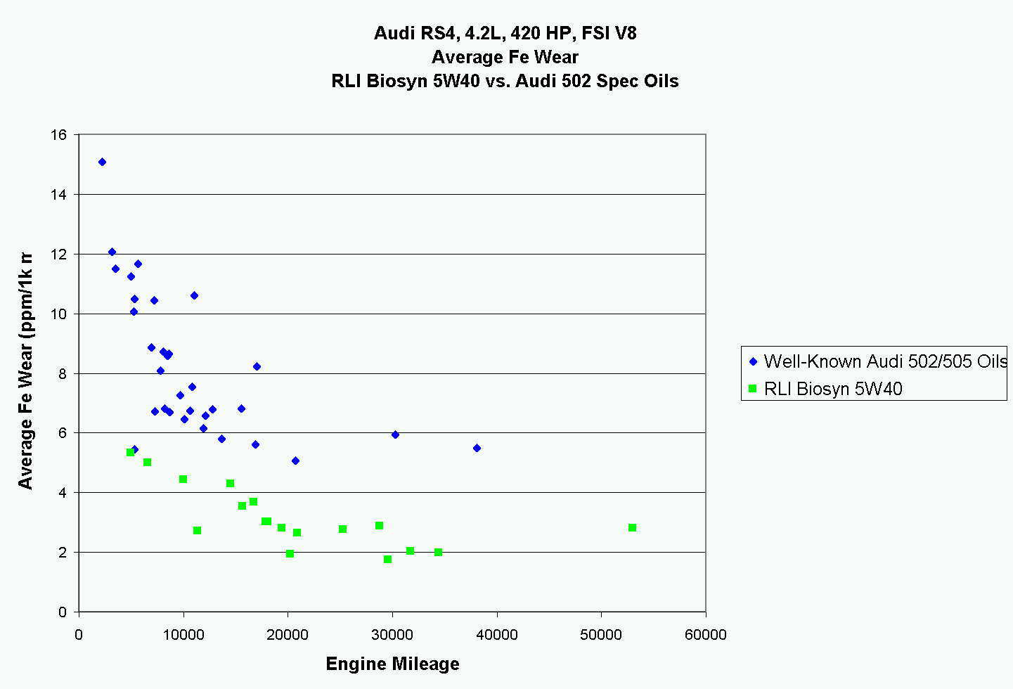

and...5w-40 is far too thick in cold, imo, for turbos....3-4x thicker than 30 weight

FYI Mobil 1 has changed their formula many times, so there's not really anything to cling onto.
In fact, plain Mobil 1 5w-30 is notorious for high wear rates. Any forum that hosts lab UOAs can confirm this.
Also, for a while after Katrina Mobil 1 was sold with NO API certs, and was suspected to be far out of spec.
I could post both pro and cons of Mobil 1, but just to mention there are indeed cons, like high rates of consumption.
Rushing to judgement on a broad front basically limits the level of knowledge and experience someone has.
The current Castrol Edge 0w-40 with titanium additives and ALL Euro specs, people love that product based on performance in UOAs.
Have you done any UOAs, or is it all guess work and sponsorship?
I think people who have used different oils are more informed than someone who used "Mobil 1 all their life". An example of one is not going to get you there, scientifically.
