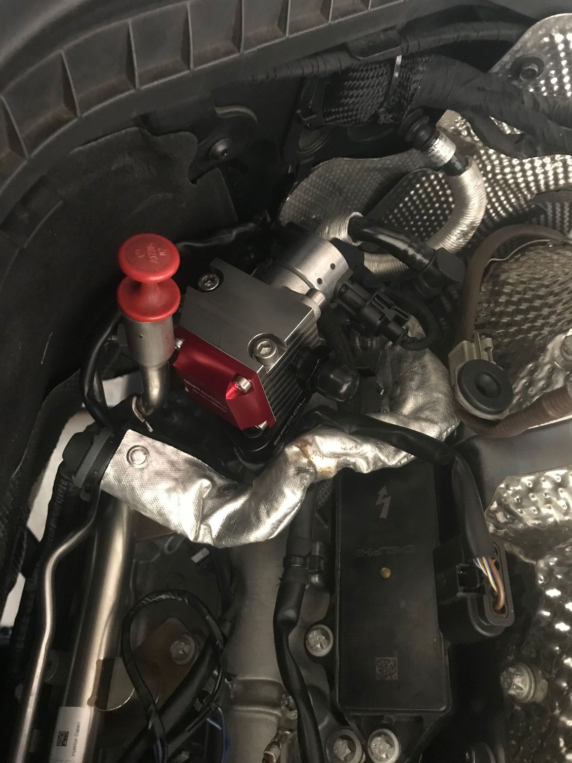

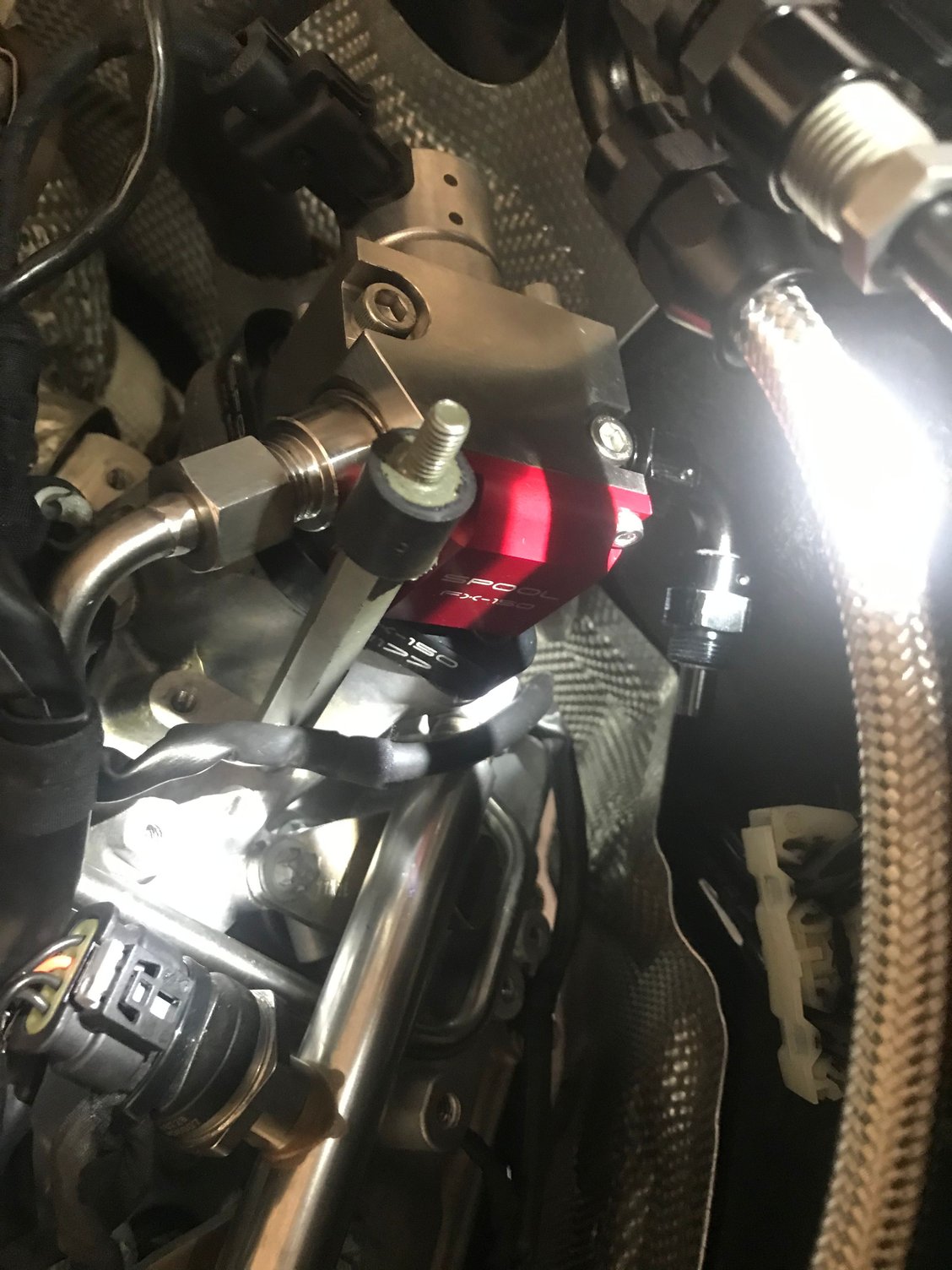

Jun 17, 2020 | 09:38 AM
Quote: Interesting. Can you visually tell the fuel pump has been changed in any way by brief visual inspection of the engine bay? Or do you have to start removing covers etc to tell it's modified?
Also, your website states you can provide "calibration details to your existing tuner." So I'm assuming the FP can be easily controlled via an ECU tune; no aftermarket controller or ECU required, correct?
Below are a couple of pics of the install I’m working through currently
You are correct about not needing an aftermarket controller. Ajay sends the DME changes and your turner applies them to your tune file
Reply 0
Jun 17, 2020 | 10:08 AM
Ah. So won't pass visual inspection. Thanks for the pics. Choices......
