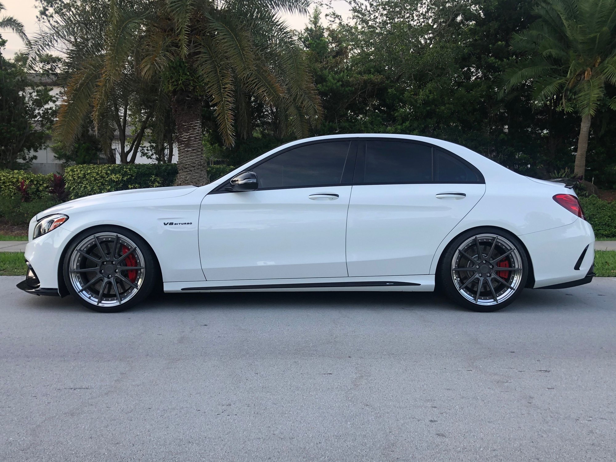

I would not recommend to use any wheel/tire setup, which changes the diameter by more than +/-5%...if that is what your asking. Other than that I have 20x9.5 +35 with 265/30 front and 20x10.5 +57 with 285/30 rear. Here is pic before lowering ..since then I lowered on KW HAS and they fit nice ans snug.

The offset together with the width I listed above is about as flush as I wanted to go w/o poke and/or rubbing when lowered.
Some pics of rear before lowering...(yeah,m that wheel gap had to go)

...thx, I put some in the general w205 picture thread. Since those pics (including the one below) I added a few things (PSM sideskirts, lowerin... sequential lights, puddle AMG logos...some pieces under the hood)...never ends.
