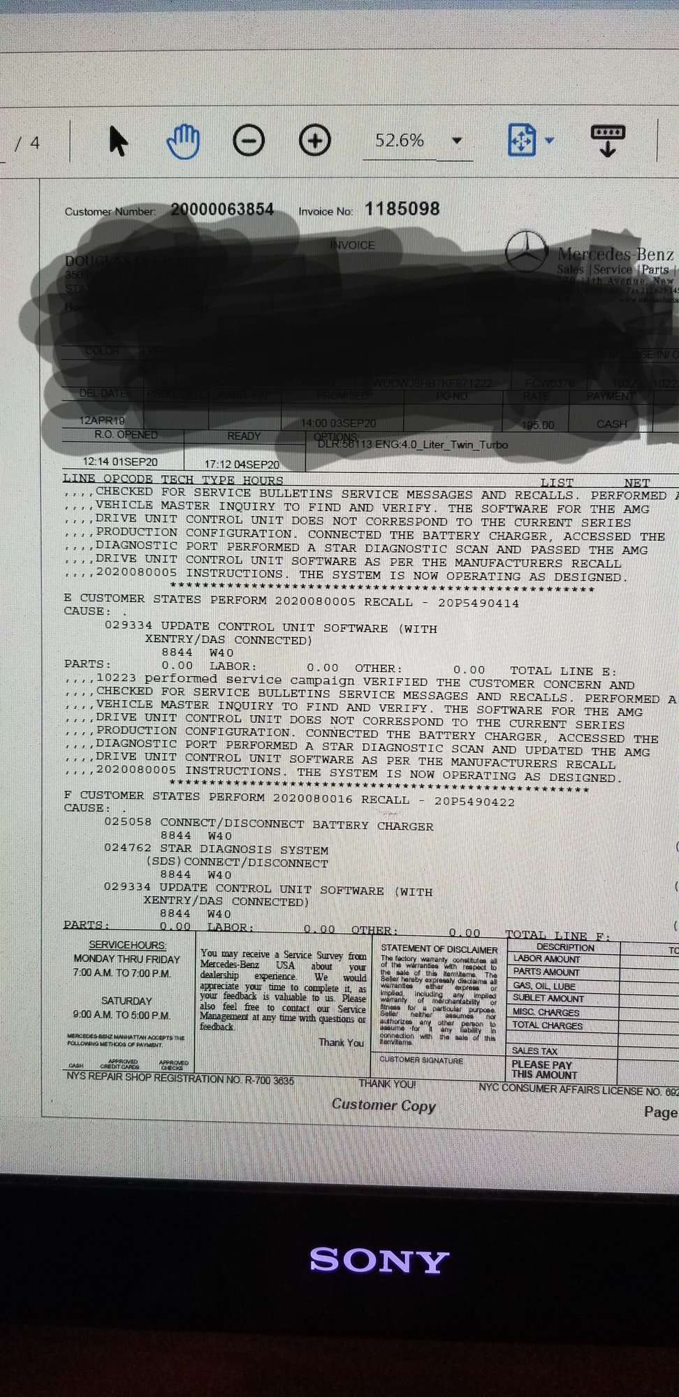

Last month I brought my 2019 C63s coupe to the Dealership for the 3x time regarding a rattle from front dash/rear view mirror area.
They had my car for a long 10 days going through a number of steps/parts to correct the issue. I listed those steps i
n another post. So far, 3 weeks later the rattle is gone, hopefully.
While my car was there, the Dealership performed 2 software updates for my model year. See photo above.
