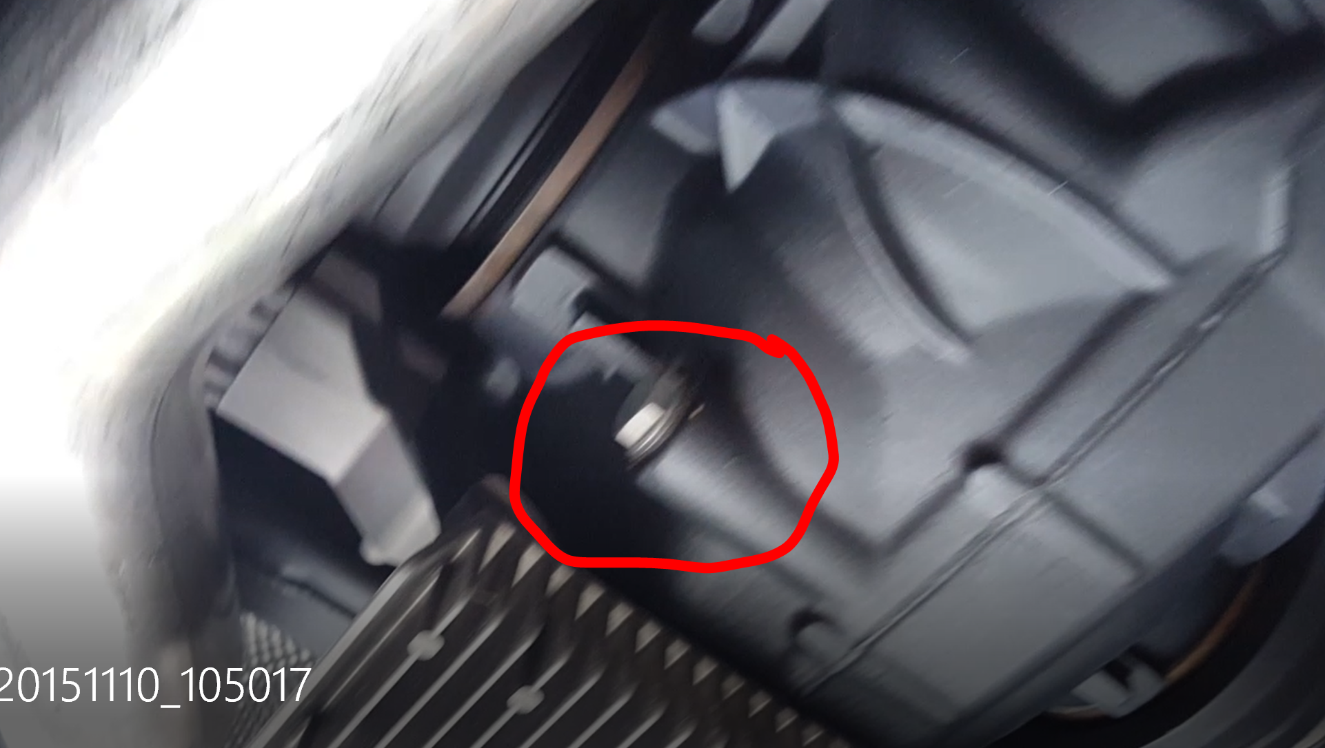

Ahh... gotcha. In this case, the only thing that I would be doubtful for is the tranny/diff oil replacement. This would be easy enough to check with a flashlight, however. Look at the circled diff drain bolt under the car. If it shows some wetness in some way (like fluid drained out of it), then you are likely good. Otherwise...they lie lie lie... Please let us know if you do or don't see wetness!!!
I don't believe the tranny oil drain bolt can be seen from under the car. You would have to remove some undercarriage covers. See this video here:

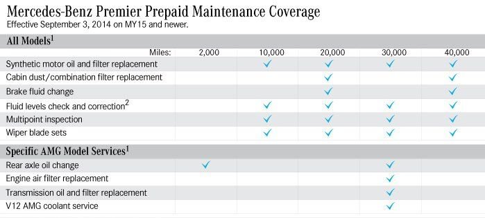

- I squirreled away the following graphic, from somewhere ... can't be sure it's still valid:
- everything I've seen indicates that there are only A and B services for 2017 C-class AMGs ... the maintenance booklet, which contains a fair amount of information, is available via https://www.mercedesbenzraleigh.com/...intervals.html (this should actually answer any questions about what was supposed to be done)
- some maintenance info is also available via https://www.mbusa.com/en/owners/service-maintenance
- transmission and/or differential fluid changes were likely not supposed to be a part of your second scheduled maintenance (but brake-fluid change likely should have been) ... I say "likely" because it's unclear whether it was the second service since new or just since you owned it (though I suspect it's a 50K or so service, given that you say plugs were replaced)

I did receive the printed report which stated the tranny and diff oils were changed, along with engine oil and filter and a whole bunch of other stuff.
And I guess you’re right, if at the start of the service they let all three oils drain, while that’s happening they could of changed the spark plugs and whatever else, then refill oil three oils I guess that could be done in 3 hours.
