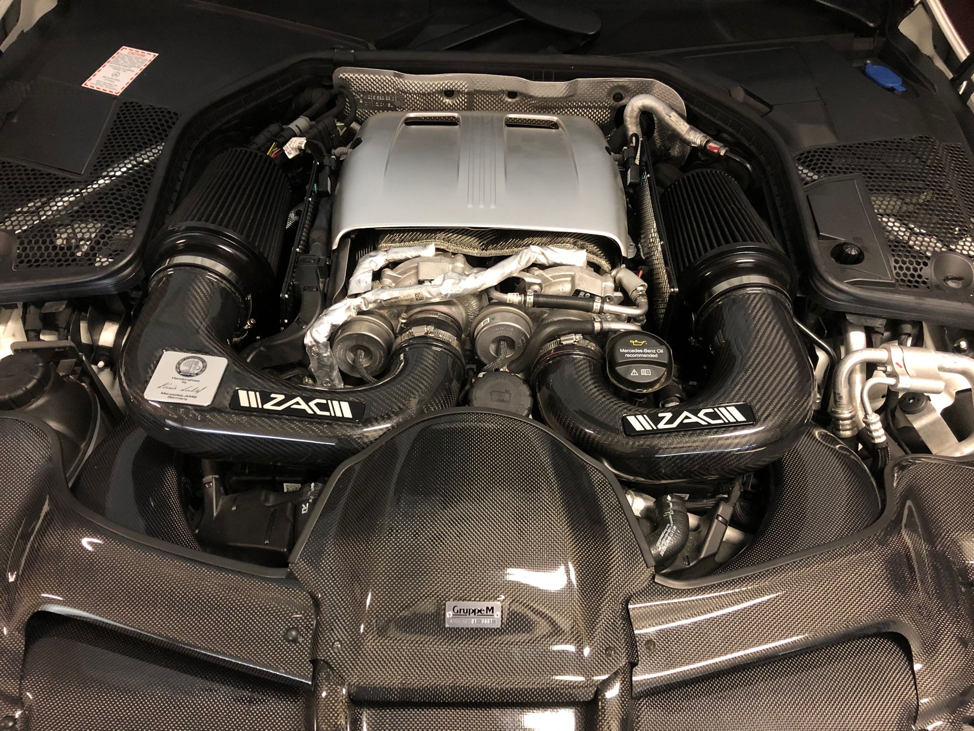

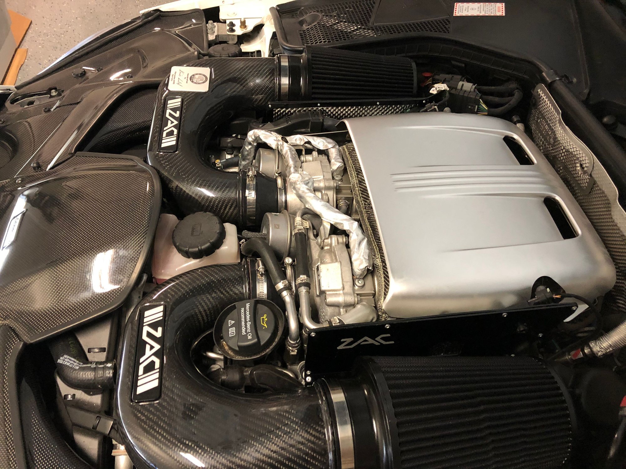

not sure what you expect. It says it’s aluminum mandrel bend. So, its the same as the CF version but aluminum. Latter for sure has a much different heat conduction factor but not worse like BMS or others none CF versions. Not sure what you think defines a cold air intake - the name came from early days when intakes were designed to suck air from front or under car where air is colder. Some still have those design where engine layout allows it. Like my Nismo had AEM intakes which had tubes under front of bumper. Most what is called “cold air intakes” today are not “cold” but just allow more air into it. ZAC calls them SHF - super high flow. Same here and same for MW or even eventuri or Weistec. Any heat shielding here is to avoid to have even hotter air sucked in but for sure not “cold air”. No such thing when sucking in air next to turbo and not from somewhere where air is actually colder.
Btw, I am going to sell my ZAC CF with heatshields soon. So, if you want CF ZAC below even those “black metal” versions, PM me.

the modalworks ones use the factory air intakes from the front of car , and the housing around the filter seals against the hood when its closed.
so of these others do NOT do that and yes you end up sucking in more hot air then cold from outside.

the ZAC heat shields have a very similar effect, neither are perfect but none of the intakes are in that regard. They shield the heat from the turbo and still get the air from the same intake funnels the care comes with OEM.
