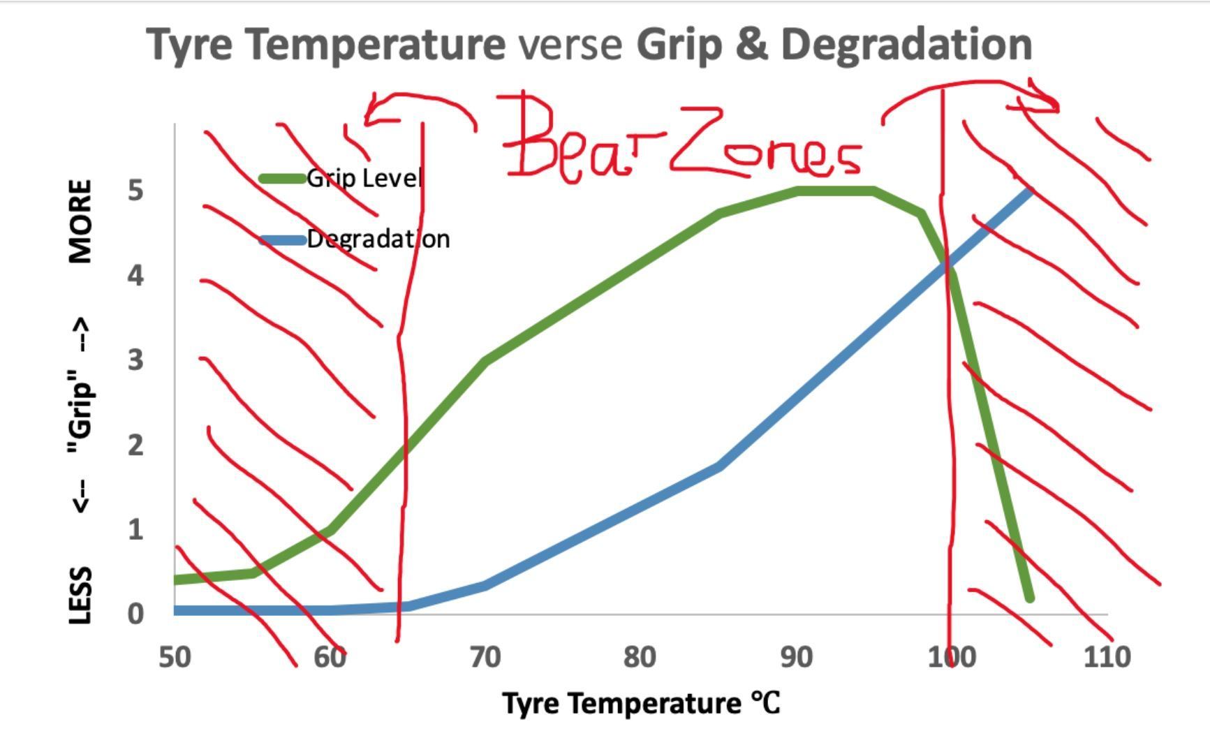

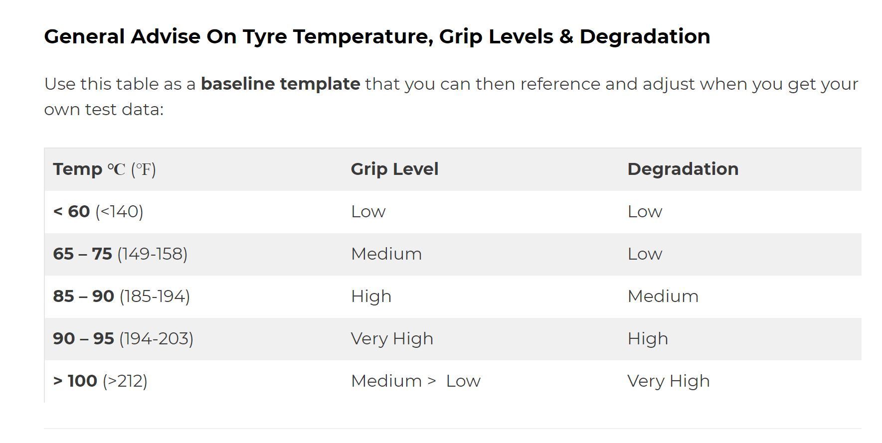

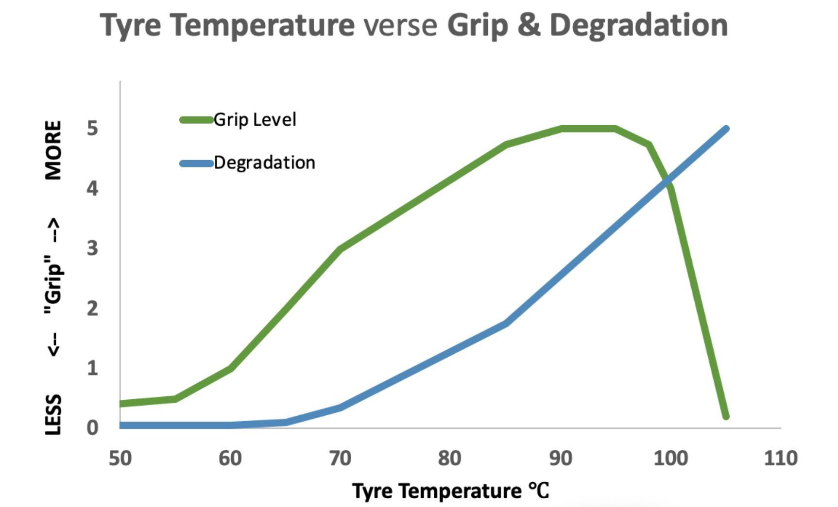

Optimal tire temps for "sporty" driving
So MB has hooked us up with tire temperature and pressure in the car - but what good is it if we don't use it to our advantage -- since I really don't know much about car tire temp (I do know motorcycle tires though!) I did some quick reading and came up with a good starting point for playful driving -- I mean, we assure our engine and tranny are warmed up before we stomp it, but are we also paying attention to the 4 things that keep us on the road....I know I want traction! Anyway, here are some thoughts -- please comment and share your experiences. For the record, I run 44 psi front and 40 psi rear cold and my guess is MB tire temp is measuring air temp, not rubber

Ultimately this comes down to the tires you use. Something like a Cup 2 needs higher temperatures before they have optimal grip compared to a PS4S which has better grip at lower temps than the Cup 2. You learn at what temps your tires develop optimal grip. The more aggressive you drive the hotter they get as well, so tire temperature and driving style kinda goes hand in hand. I can definitely tell that in the canyons my PS4S start sticking more and more the hotter they get, and they easily spin when cold and I'm a bit too eager on the throttle. Somewhere around 90-110F they seem to stick pretty well for road use. In the canyons I've had the fronts as high as ~170F at which point they show red. Around ~150-160F they become orange.

Well I learned something here -- I didn't know the temp display changed color for warm and hot temp but I should've figured it might...thanks! I need to keep an eye on that, I seem to recall seeing one tire rather warm the other day (it was in the sun longest) but don't remember the display being a different color for the temp....more to come on this one!
