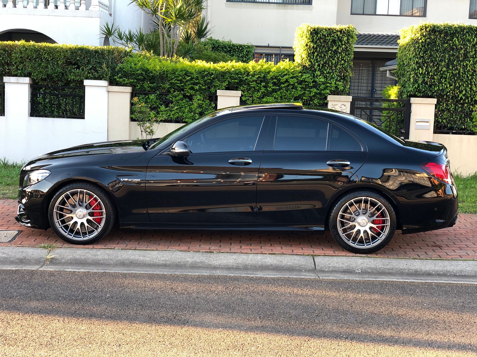

Guys I decided to take a punt and go to Heng's Garage and try again with the MSS Lowering kit for my C63S. 2nd time, the wrong parts! Had anyone on this forum installed this kit on their car??

The problem is the car is not lower than stock. Same height! The front is marginal but rear is higher!

Mate, we're talking about 30-35mm difference on the lowest setting! We wound it out all the way and it was at stock level! These guys are experts!

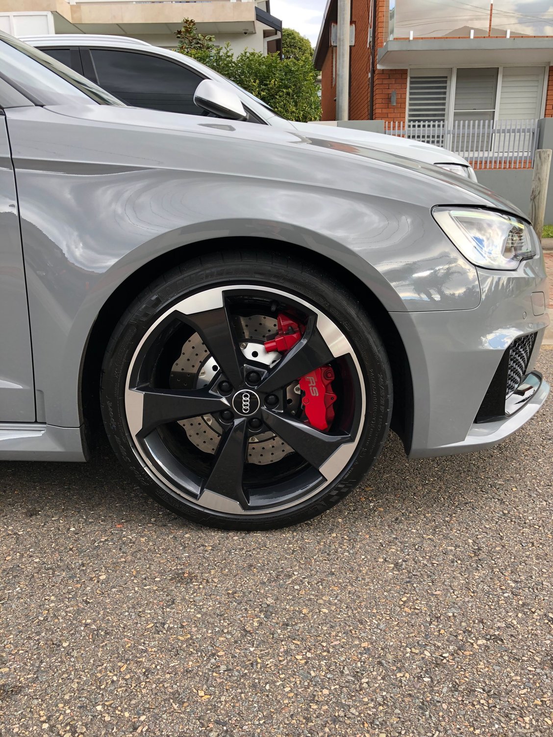

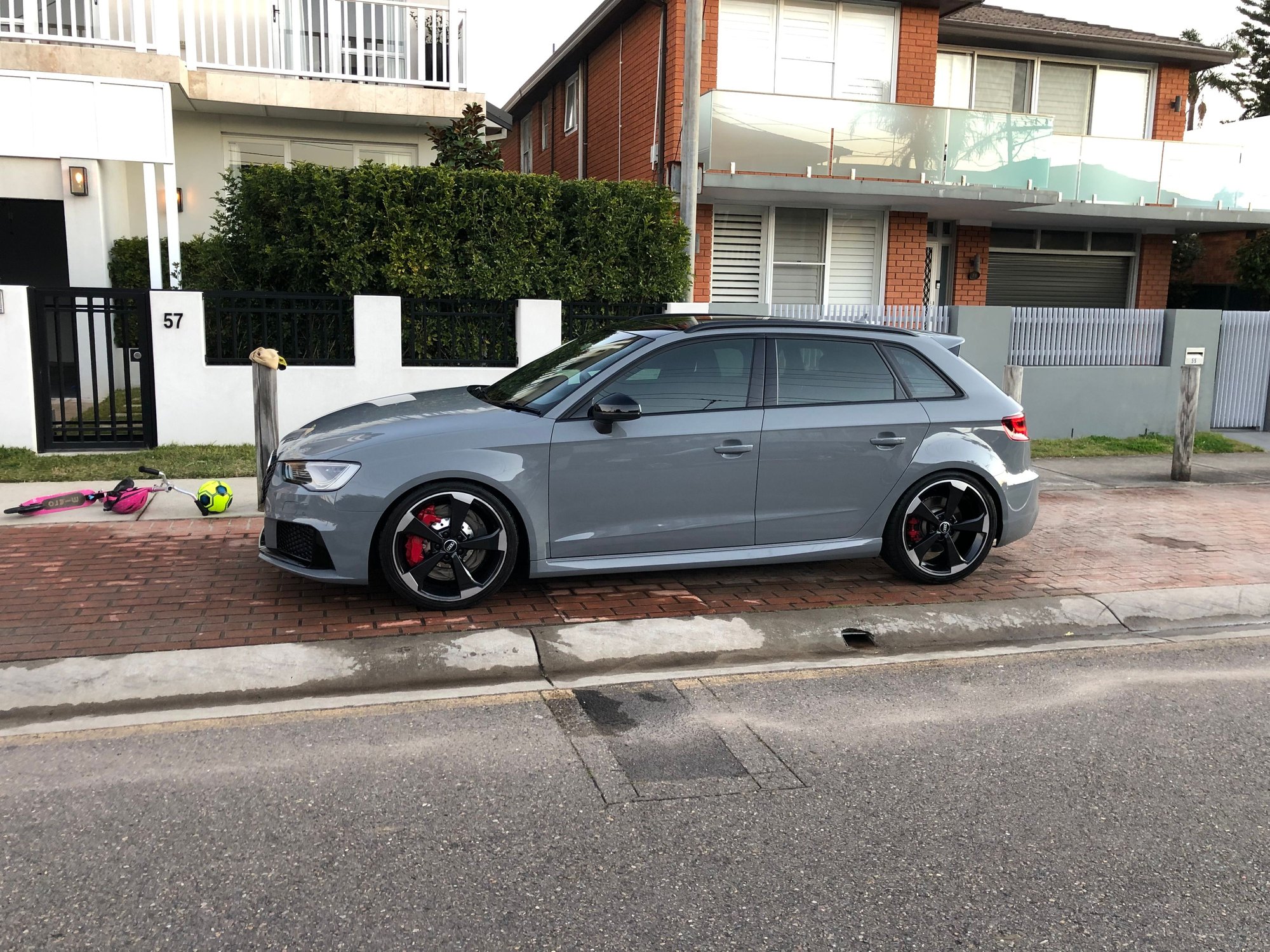

Crester this isn't my 1st rodeo. My RS3 has the same kit so I know what I'm talking about. My RS3 looked lowered when we did the job. There was no gap to the guard. The C63 is the same height as stock. I can put my fist through.
in settling, we're talking about 1-2mm not 30-35mm! Understand? There is a major problem. They are the wrong parts. It's the 2nd expert mechanic that's it's happened to.

The facts are that I went to two expert mechanics. Both only do these type of installs, all the time. They've both been around for many many years, both told me the same thing! Personally I've installed suspension on most of my cars so yes I do have a little experience and understanding on what issues pop up with these things.
On my C63S, it's different from all the other times I've installed the suspension. When set to the lowest setting, and the car is lowered onto the floor from the hoist, it should sit very close to where you set it. My RS3 has exactly the same system, and when we took it off the hoist, it sat practically where it sits today. It settled maybe not even 1mm. The C63S when came off the hoist, sits at the stock level, yes we measured it. It's not normal.
