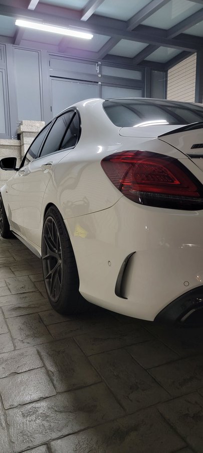

Will post some pics when I get time to give the car a wash and install them.
In the meantime here's a pic of the flics, I think they are pretty well made.

Found some time to install just now. The flics looked good in photos of cars with them but I kind of got mixed feelings about the look. Fitment is probably about 90% accurate so can't really complain. Sorry for poor pics cause it's night time here.
