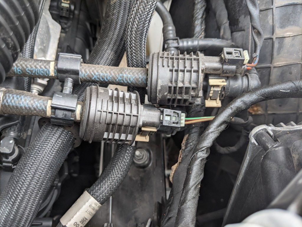

Sweet ride. How is she holding up at the moment with the 0.024 plug gaps? Any misfiring or we all good?​​​
running stock plugs now. It was the evap/purge valve solenoid all along. I’ll post their dyno that shows stock tune and their tune having the same issue. They took the car for several days even with high octane it had the same issues on both tunes. Now I’m running 101 octane, modalworks intakes, and zac DP on race gas tune making 612whp on stock turbos. Here’s their dyno showing the same issue on both tunes. Since then i fixed the problem, added intakes and 101 octane tune. I am going with hks plugs, dropping those in tomorrow just as insurance 🤷‍♂️. Stock plugs, stock gap worked great for me though.

it’s the whole piece, the two solenoids, tubing, and sensors very front of drivers side engine bay. but yes lol. It can cause misfires especially at high rpm because of its function and it’s just a stupid emissions device. All this headache and trouble for months. Weistec took the car and figured it out when MB couldnt. Went from down on power misfiring to beating dodge demons on race gas. One stupid part.

What are they
geeze...... what a pri_k of a thing
Ok now i'm paranoid mine need replacing you wouldn't happen to have any part no(s) or diagram of what these actual parts are? wanna get mine sorted with new ones while i'm trying to rule out a persistent misfire issue of mine too 😓😓😓

if you pop your hood it’s literally the two solenoids and tubing on the front right drivers side just off of the engine. You can see them plainly and it takes just minutes to swap out. Cost $130 from the dealer, it’s all one piece. Part number printed on both solenoids is A0014764432 but dealer will have a specific number for the entire thing in their system as it’s all sold as one piece. It’s #1, #1 and #5 in the diagram. It is specifically named the evap and purge valve solenoid. I have had no issues since. I used to have random misfires past 5k rpm. All cylinders
Great post mate thanks for going through the effort to show us that diagram
You're the best dude.... thanks for that 👌👌👌
Ah ha! I found them. Shi*ty little plastic barrels just above the splash guard next to the air con pipes
around $75-110 when I called around, I have 41k miles and had some misfires before so I might change em out too
