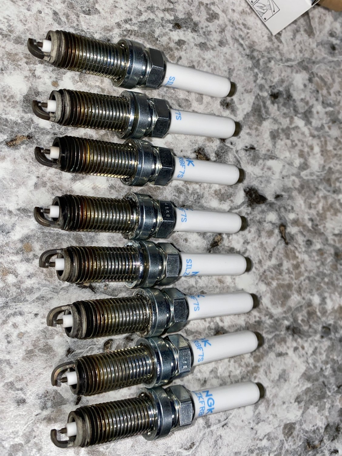

Got the same after retuning my car but coils are brand new. Gap the plugs at 0.22.-0.24 this will make things run very smoothly (source: https://mbworld.org/forums/c63-c63s-...ire-knock.html)
Please give this a go first and if it still plays up look at your coils if they are not new.

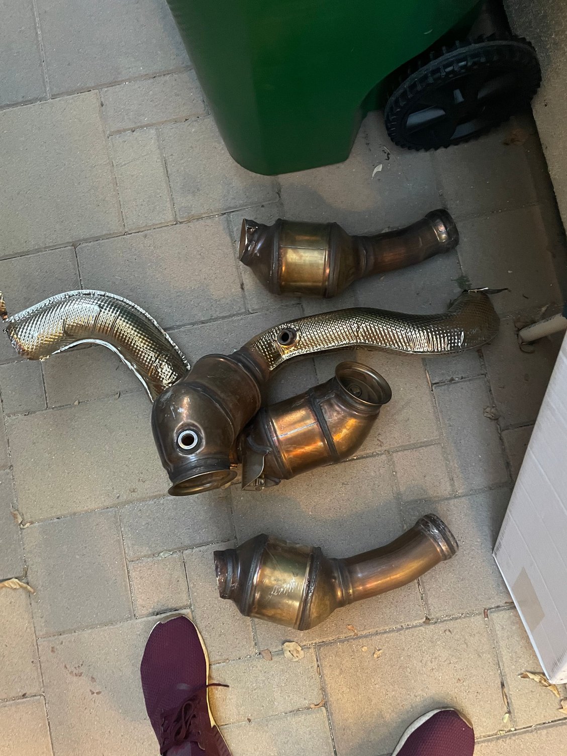

I’ll drop gap to 0.024 from 0.026 and throw in the catless downpipes I’ve been waiting on and get it retuned. I just wanted to rule out any other possible causes but fuel trims look good and coil packs and plugs are new. I’ll let you guys know what happens maybe things improve 🤷‍♂️
Yep let us know how you go with those gaps please.

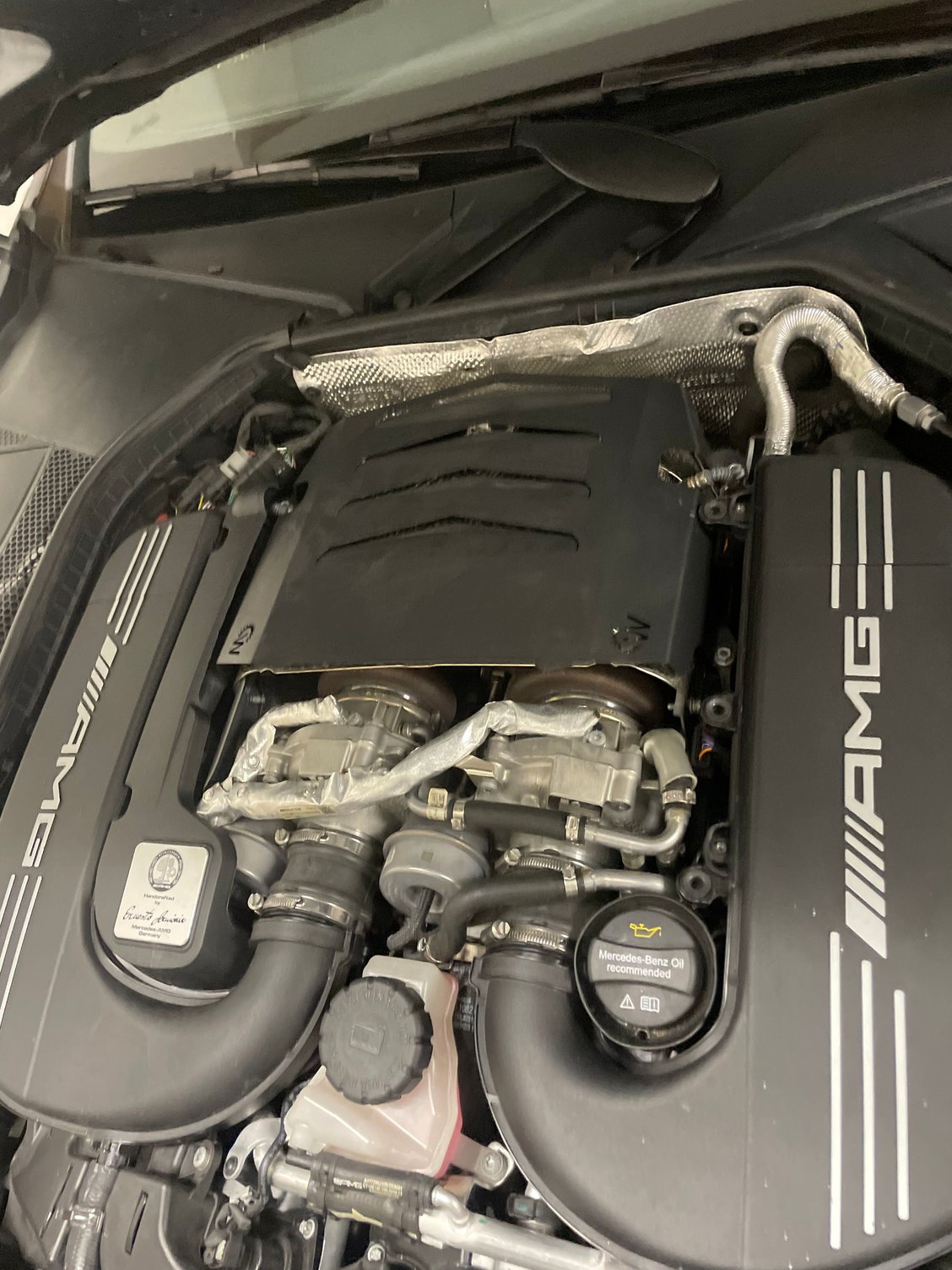

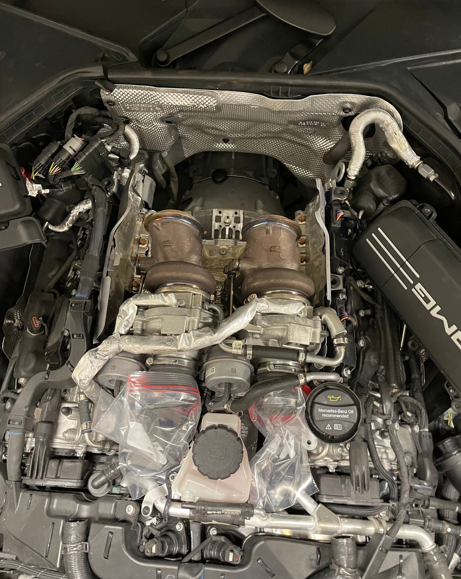

been running 0.024 for a few days now with catless downpipes, high flow filters, and stage 2 tune. Pulled on a demon from a roll, he didn’t expect it. Car is ridiculously quick and noticeably different with no issues.let’s hope it stays this way.
