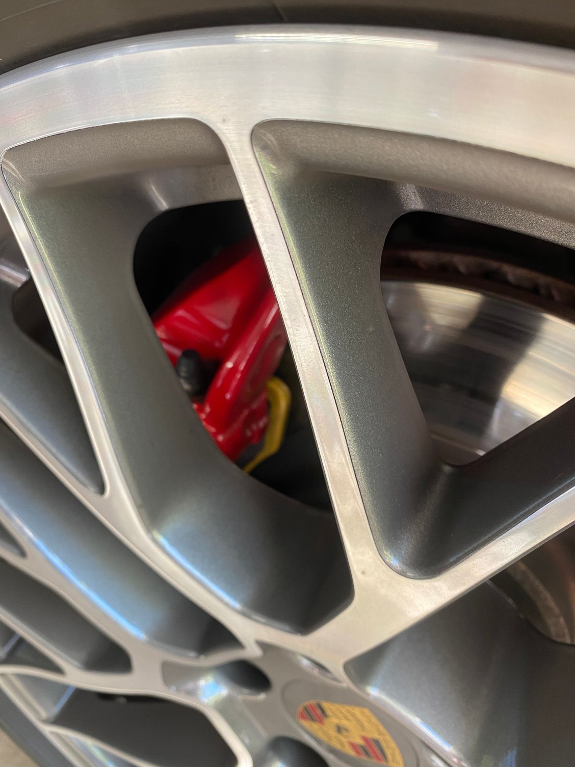

Think I posted this on the Macan forum yesterday. I installed a full set of EBC Yellow Stuff on my ‘18 Macan Turbo. Prior to that, I had already bought and had my dealership install Goodridge yellow Teflon coated SS brake lines. I’ve used EBC Red Stuff on my last 6(?) cars. But they don’t make Red for the 360mm rotors. So far, I like them. Stop good cold. No noise. And little dust.
And these brakes can stop!
