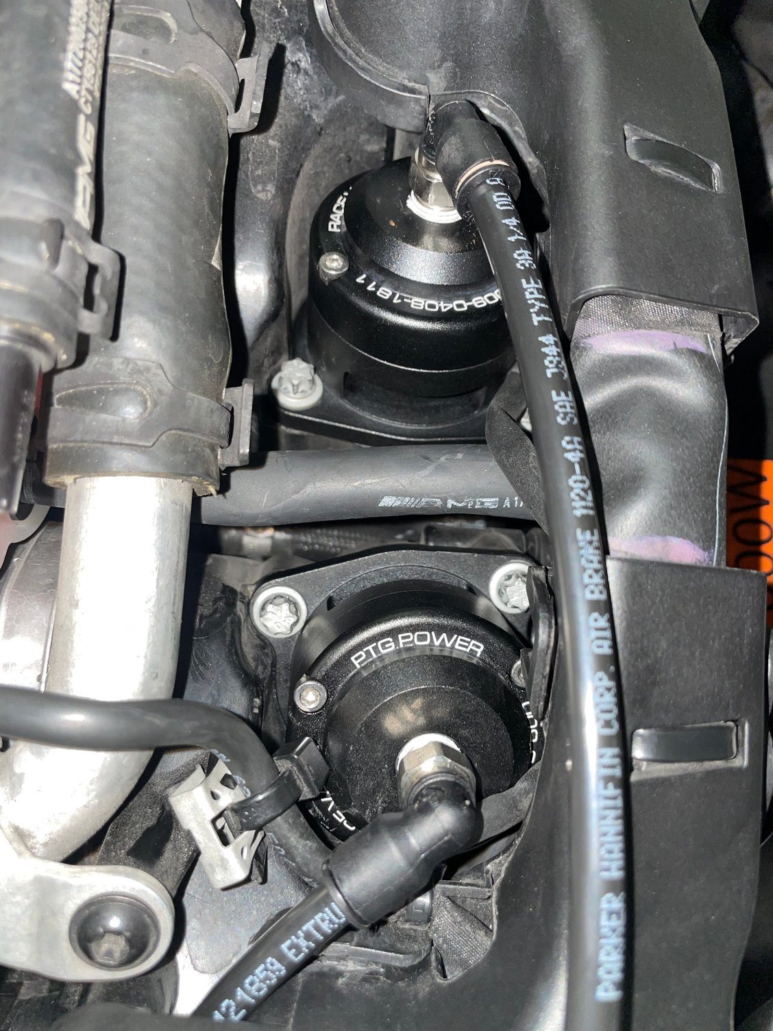

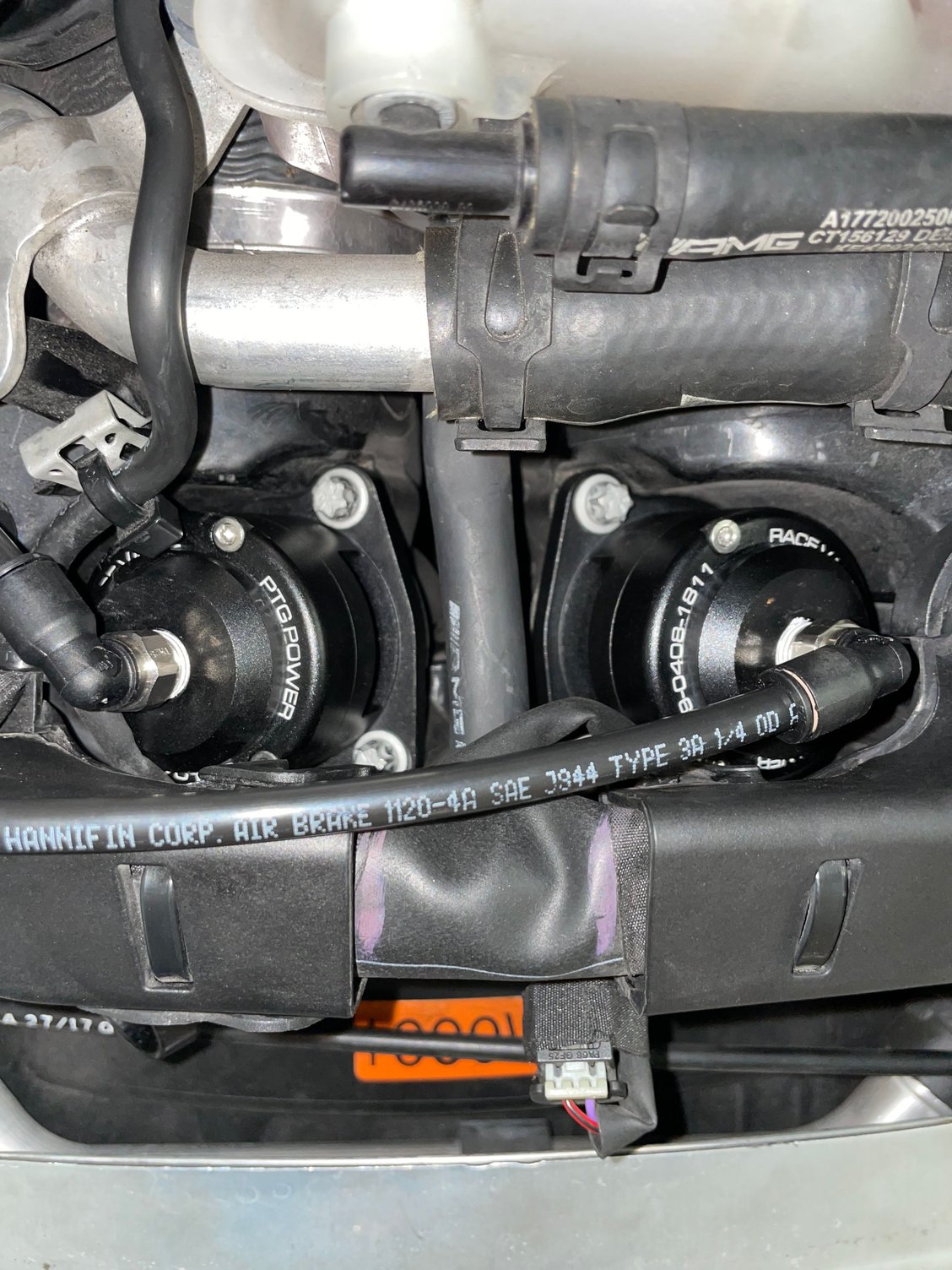

I have ZAC intakes which essentially removed the recirculation/diverter valves hoses and the factory BOV vents the excess air to atmosphere.
Couple weeks ago, I ordered PTG race valves and the air now recirculates into the passenger side intake manifold. Its a completely mechanical BOV.
Feels like less turbo lag between shifts and when I step on the gas out of nowhere.
PTG supplied 3 sets of springs that go inside the BOV. I am using the hardest spring as of now so whatever excess air gets pushed out past the springs should be beneficial versus being vented, in my mind.

A blow off valve in our testing helps with turbo lag. Venting to atmosphere or venting back into the box as a bypass really does the same thing. It makes no difference. The main reason why a valve is added is to remove what is called compressor surge. This is when the throttle valve closes and the turbo is still spinning at very high RPM's. Compressor surge is the turbo oscillating shaft RPM's and you can audibly hear the noise. This is first off bad for turbocharger longevity and second causing turbo RPM to slow dramatically. When you accelerate again, the turbo has to spool up. A blow off valve or bypass valve will by pass the excess pressure when the throttle valve is closed, allowing the turbo to free spin at a much higher RPM.
We produce a Street Valve which is a spacer made for noise and increased flow. You still maintain the factory electric valve as your control but it just simply vents to atmosphere instead of back in the box. This also takes heat out of the system because this is charge air before the intercooler that is being vented. This is a benefit of venting to atmosphere.
We also produce a race valve as shown above. this removes your factory electric valve and replaces it with a more typical vacuum/boost assisting valve. These can hold more boost and remove some of the ECU's logic to open and close the valve when you don't necessarily want it to.
Hopefully this adds some of our experience to the thread.

Install was pretty easy, you just have to loosen the hard plastic pieces a little bit in front of the factory BOV to stick a E10 ratchet in there to remove the screws.
I was also able to stick my hand down the passenger side to remove the stock intake manifold plastic plug to plug in the BOV lines. WD40 and a flat head might needed to wiggle the piece out.

you have to reach down into the passenger side and delicately push the plug to unlock it then you pull it out, you can also use a pick if your hands are fat like mine. Becareful because the fins can and I broke mine. I had to use my spark plug angle tool to loosen it more. Next time I know.
For the topside you have to remove the factory BOVs and simply place the new one in and tighten. You might have to loosen the some of the plastic pieces over it to get space.
