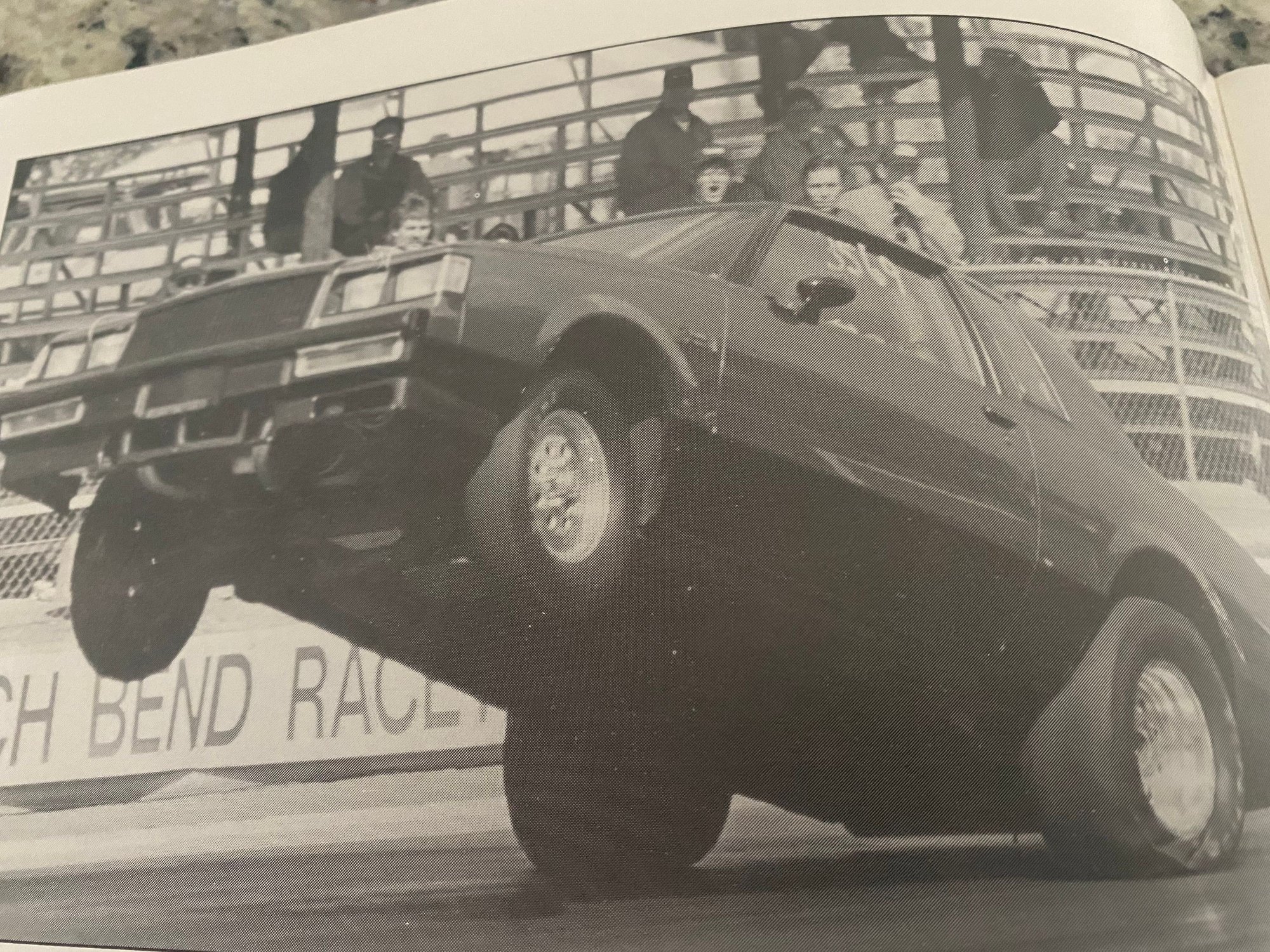

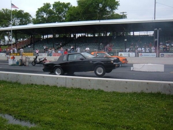

*****Proper track prep makes a huge difference as does proper tire temps. Driving experience and drag racing experience helps as well. Colder air helps produce more power but if it is really cold, the tires will just spin and spin, especially on the street.
Your times are not that far off what is to be expected for a Non-S Cabriolet, which weights more to begin with. Our cars are not set up to be drag racing cars and have poor squat characteristics and weight transfer compared to other cars that have much better 60 ft times at the track, but make much less horsepower overall.
I've had properly set up 4 link suspensions on cars that produce 1.6 second 60 ft times at the track on a 400hp or so car that weight about 3800 lbs with Nitto Drag radials (sticky street tires) It is rare to see in my experience a C63s or C63 break 2 seconds in a 60ft, almost regardless of 285, 295, 305, or whatever tires are on the car. The sidewalls are too thin, and it is tough to heat the tires up properly. A bigger tire will help to a point, but there are other factors at play as well with respect to launching hard, and getting into an optimal torque/power band quickly and efficiently. A hard hitting car using slicks and a trans-brake, on a properly set up 4 link will absolutely destroy pretty much *any* street tire driven car at least for the first few hundred feet, at a much lower power level. Street car versus a specialized drag car running a spool, brake, slicks, etc.. There's lots of physics involved.
This is why 60-130mph tests are perhaps a better indicator of power/performance on these cars. Less issues regarding traction, and driver differences, tire temps, etc..
Anyway, some good tips in other posts if you want to improve your times a bit, but just understand the C63 is just not optimal for super fast 0-60 times, or 60 ft times, etc... It is more of a road racing car.
