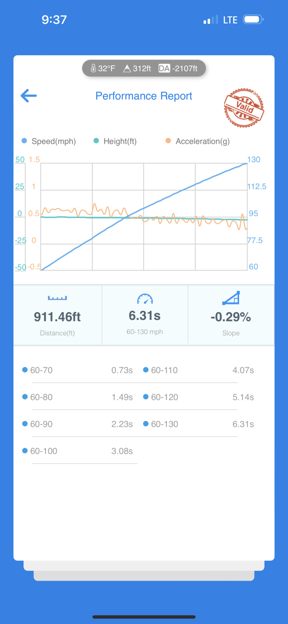

Nice! Do you have a Dragy screen shots? My best Dragy run was a 6.31s 60-130mph on 93. I think I’m a bit faster now but haven’t made any new 60-130ph passes since to confirm.
Jeff
Originally Posted by legit_c63s
I’m actually closer to mid 5’s on e50. Traction is an issue sometimes, working on getting that resolved. I was mid to low 6’s on 93 all day.

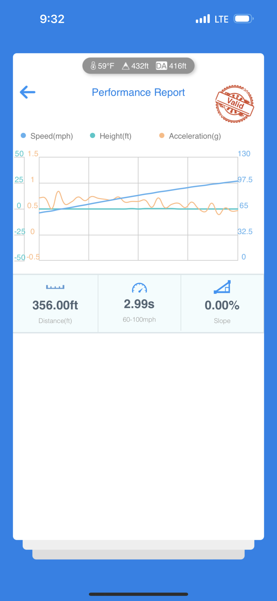

Jeff
i sure do. Those ModalWork intakes aren’t too bad after all lol

This isn’t my fastest time and the tuning is still in progress
Thats moving!! Nice!! I recently did a a couple 60-100 dragy runs and got a 2.99 and a 3.00 back to back. I should be close to a 6.0x/6.1x 60-130mph currently. Just harder to make a 130mph pass safely around here so I use 60-100mph as a comparison bc they are easier/safer to do and they are reported on 60-130mph passes. Including my dragy runs below.
