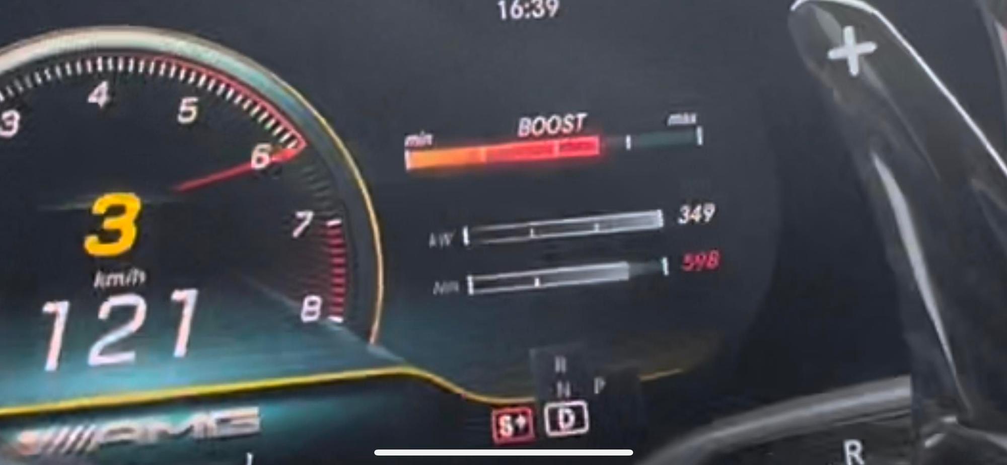

Hello guys, I've noticed that my car on acceleration is not getting full boost gauge to max. Even on full throttle it's like 3/4 of it. Xentry checked for errors and nothing was found. Can it be bad fuel quality or what to look for? Attached photo where you can see max boost i've getting. Thanks

Your car is most likely in limp mode. If you bring up the engine data screen what does the horsepower scale say? If it's less than 500 then it's in limp mode. Can happen if there was an electric failure. Need to take it in to get checked and taken out of limp mode.

Checked for errors and didn't get any. I have non S version so it will be lower than 500. And in my car there is kW instead of hp. On full throttle boost gauge totally live it's own life and blinking lower and higher. Can attach video of acceleration if it can help

Uploaded video of acceleration to show boost

If it's in limp mode then the power gauge scale on the engine data screen will max out at about half of the rated power. I see you had it up in that video, but it was too far away. Pretty easy to tell. It does look like you are way down on power. From that video it took about 8 seconds from 0-100kph. Despite loosing traction for a moment there and the TC cutting power that's quite slow even for the non-S.

His video did show that it hit full boost for a brief second but not at high RPMs, or maybe I am mistaken.

At the 5 second mark of your video named IMG_3042, you can see the boost is at full bar but only briefly.
