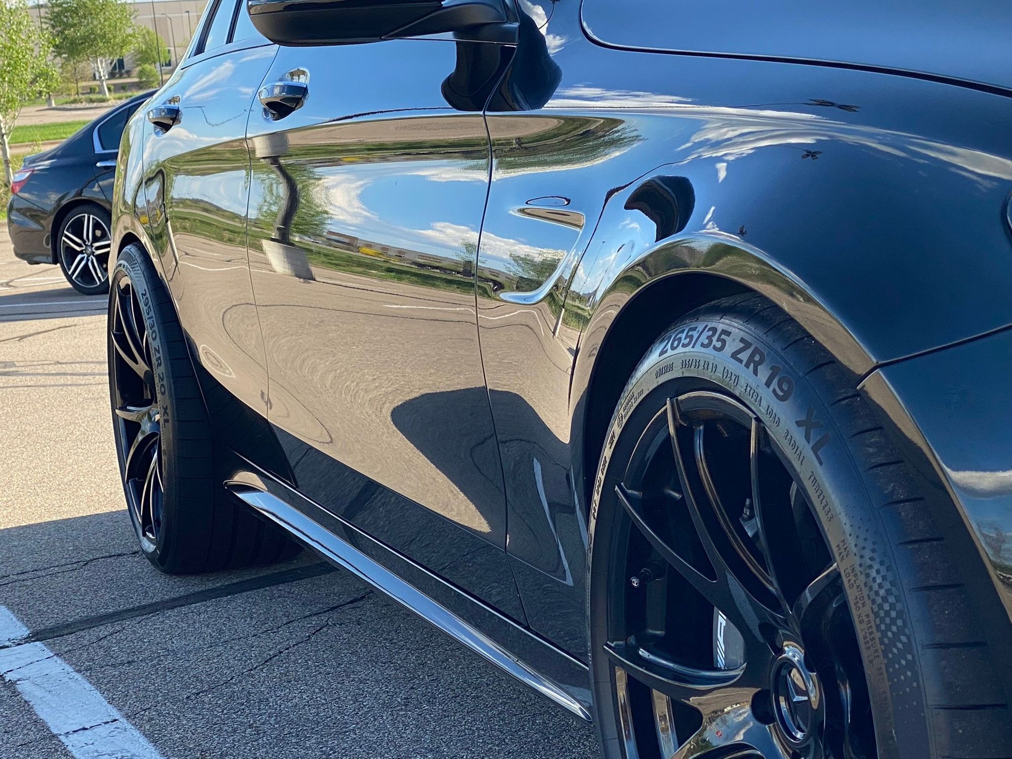

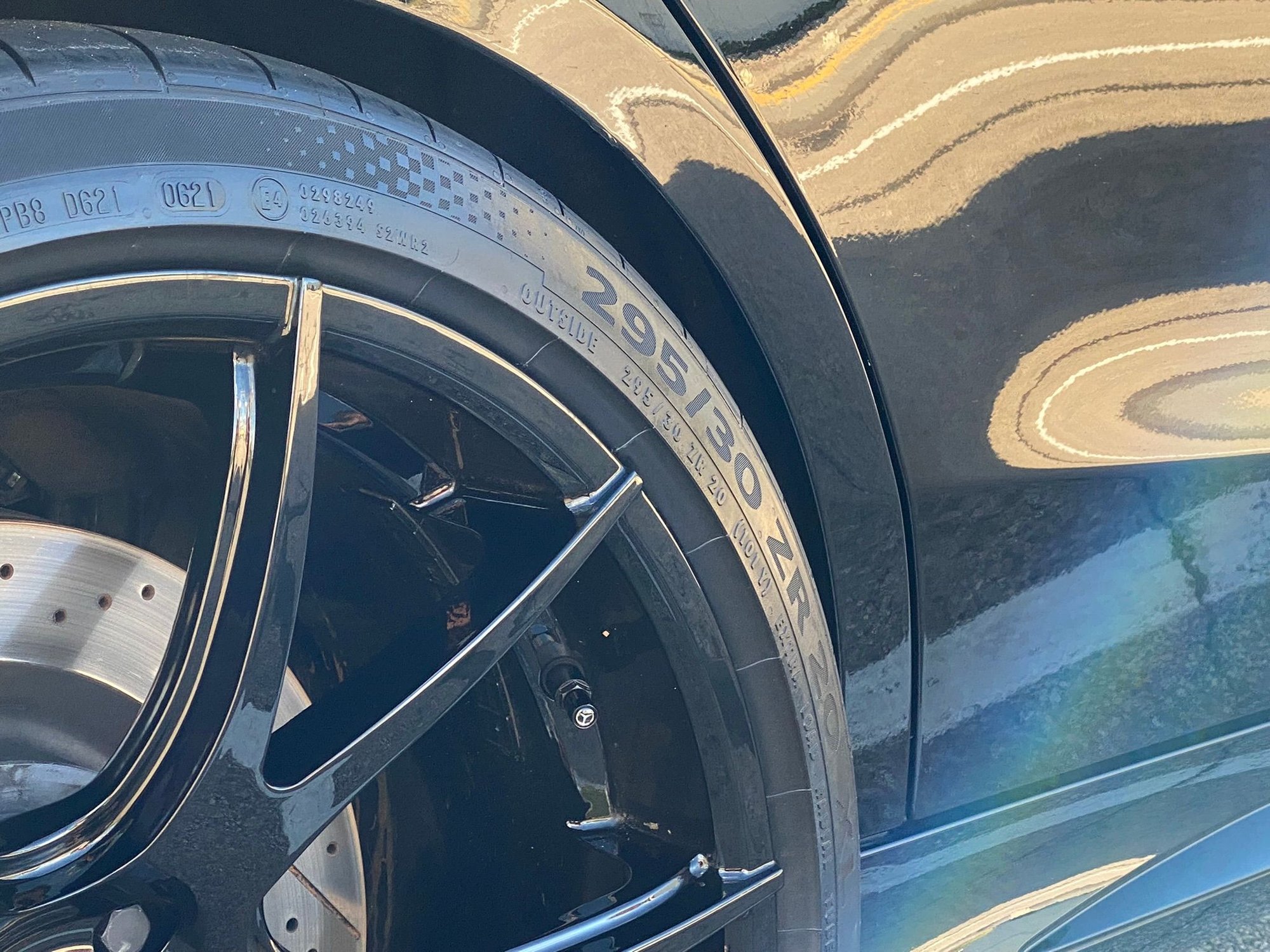

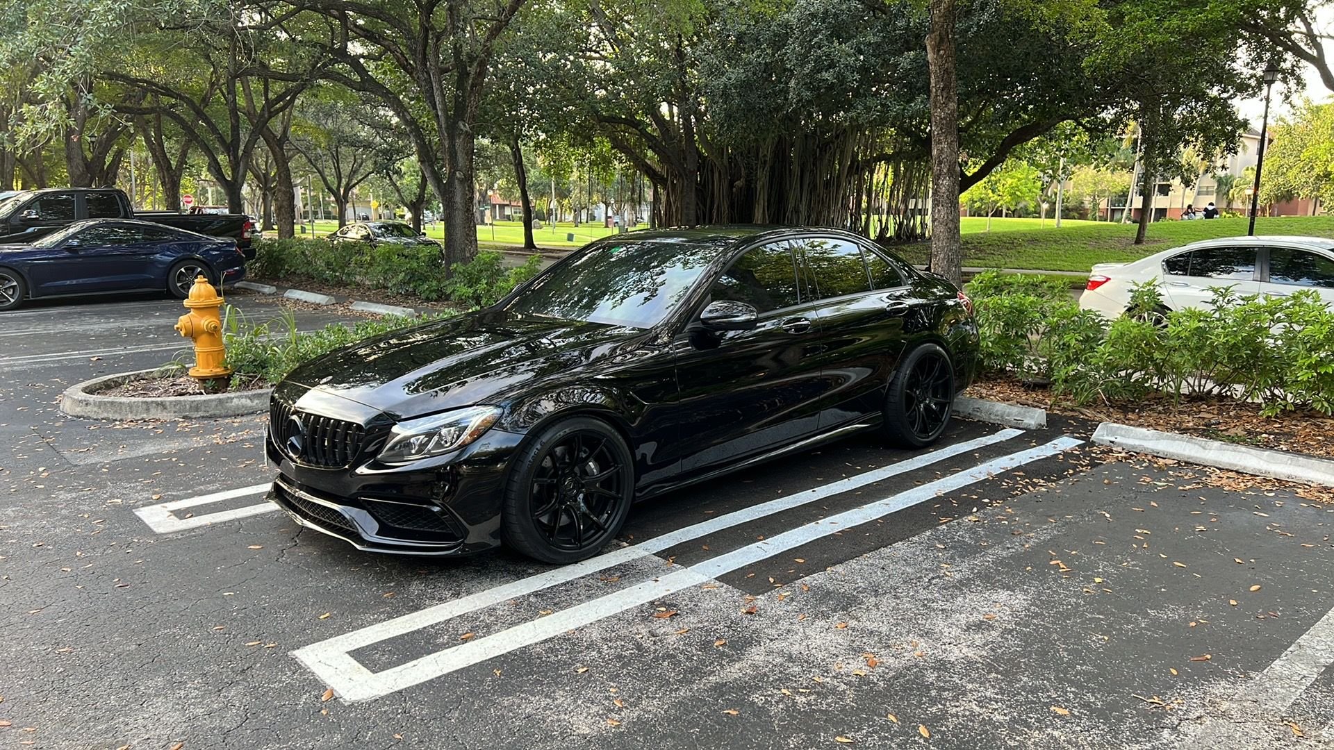

Performance wise the best upgrade is wider wheels and tires. They say you cant but I will tell you, you can. The disclaimer is that rear fenders need to be reshaped; rolled and pulled. I ordered some shims for the rear springs but havent got them yet. Just to add a little space, stop it from scrubbing hitting big dips and railroad tracks. I am wondering if 305/30ZR20 will work after I add the shims.
Continental SportContact 6
FRONT:
265/35ZR19
19x9.5 ET+30
REAR:
295/30ZR20
20x11 ET+45
Once you get traction the car stops driving like crap.
I recommend 19/20 staggered to keep proper dynamics. Rear wheel having a larger rolling diameter than the front.
If I was going to build a track car out of my sedan I would have put 19x12 with 325/30ZR19 on the rears. I don’t think big rear fender flares look good on this car. 19x12 wouldnt fit otherwise. With my current setup I would cut the inside of the wheel wells to add in inch of space but keep with the original design, just a little curved out. To make it perfect, if I had the extra money.
Brabus Sedan only has 285 on the rear. With the Pure 900 turbo upgrade we can hit 700 whp without going catless. With a fender roller, fender pliers and a heat gun I modified it to run the 295/30ZR20 on 11x20 wheels. Yes it is possible. Should you do it? Probably not, but the best things in life are usually the things we shouldnt do. (sinister laugh)
