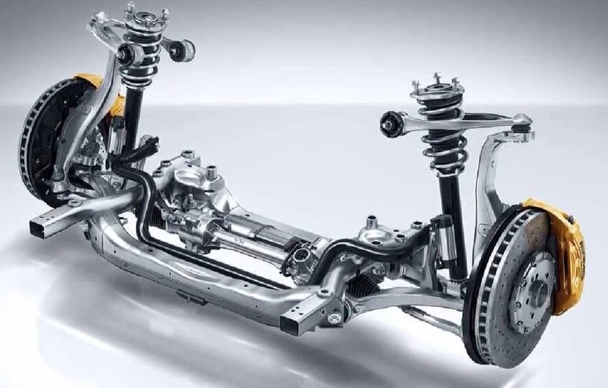

Just picked up the car from dealer. Below is service invoice stating what the tech did and this site has full explanation of this TSB.
https://www.tsbsearch.com/Mercedes-B...46-35-P-068182
There is new thrust piece on rack-and-pinion steering made of new stronger material (aluminum vs. plastic).
When I first drove the car right after picking up the car, I immediately noticed that there is now more resistance to the steering movement making it feel a bit more direct and heavy.
I welcome this change as I always felt like C63s steering movement was on the light side.
