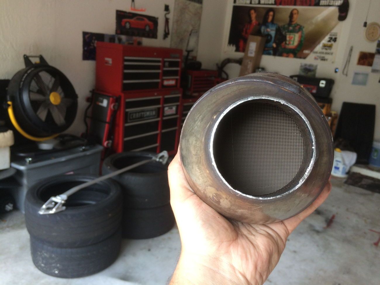

Here's a photo of someone's secondary cat after they removed it. Looking like ~300CPI range to me.
Don't think I would mess with trying to gut the primaries. You'd have to drop the trans or cut the stock pipes apart just to get enough access to do so. Gutting cats can be very difficult (drilling, chisleing, etc). You'd have an open chamber where the cat was, which will increase turbulence. You'll have to install and then weld the factory pipes back together (or weld v-band clamps on). Youl'll have check engine lights on because the primary cats are the ones measured by the ECU. You'll end up with a system that flows worse than an aftermarket set of downpipes with 100-200cpi cats.

No way the 2ndary are 100cpi

Secondary cats in our cars are 300 cell.
