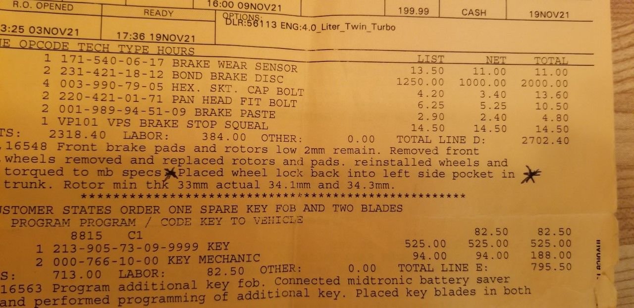

Currently have 23,417 miles on 2019 C63s coupe. I needed front brakes and rotors at 16,548 miles. I went to an experienced MB Indy who gave me a quote and stated he will only use
MB Original brake components. I then called Mercedes SA which I had been dealing with and he gave me a quote of $600 more than the Indy. I informed him of the Indy quote and magically he could match it. So it was much more convenient for me to have it done at MB. See Invoice above. So you may want to use the quote from your Indy and then see if Mercedes will match it or better it.
At 17,993 miles the Check Brake Pad light came on and had the Rear brakes and rotors replaced at MB Dealership. Invoice above.

Hopefully, I'm wrong here, but is that a $60 charge for disabling/enabling the brake calipers in order to change the pads? If so wow! It's a menu item on the dash!
Hahahaa fuucken sixty bucks to press the steering wheel buttons 3 times 😂
