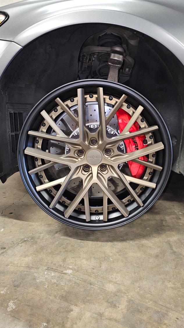

Hi guys has anyone fitted a 285/30/20 to the front of their C63s also a 315/30/20 on their rear.

I don’t think this is possible with the stock setup. Assuming you’re referring to a C63S coupe/cab, the max you can go on stock rims / suspension is 275F and 305R without rubbing or going beyond the tire width limits of the rims.
I’m planning to get this done on my coupe tomorrow (275/35/19 F and 305/30/20 F).

Sorry meant to say that I have new wheels
20x10 front
20x10.5 rear
