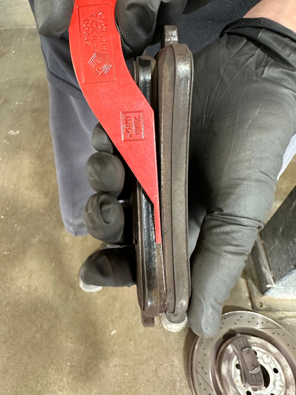

What point does the brake sensor go off?
Not a huge deal, but changed my brakes yesterday. Did rotors and pads in all 4 corners. I didn't get any notification about my brakes being bad(I knew ahead of time they needed changing from the previous owner) but you can see in the pic the rears were down to 2mm haha. At what point does the sensor give notifications?

2mm-2.5mm
There is only one sensor per axle so if there was uneven wear left to right it could mean the side with the sensor has not worn far enough yet. On my W166 the outer pads wore faster than the inner pads, with slight (1mm) difference left wheel vs right wheel.

The sensor normally hits the rotor at about 3 MM pad remaining. As already commented, inner/outer pads can wear differently though, IMO, that should never be more than about 1 MM difference.
Now all that assumes you're not running on the track. My multiple experiences in a C63 S were that the sensors don't work on the track ... they're destroyed by the heat and give no indication. The first time that happened, I hit the metal backing pads ... still stops very well, BTW (and badly scores the rotors rather rapidly ... du-oh). Just did front pads in my GTR Pro and see that the sensor was also falling apart (crumbling), so it looks like they simply can't take much heat.

2mm-2.5mm
There is only one sensor so if there was uneven wear left to right it could mean the side with the sensor has not worn far enough yet. On my W166 the outer pads wore faster than the inner pads, with slight (1mm) difference left wheel vs right wheel.
Makes sense! Guessing it was probably right on the edge.
Thanks guys for satisfying my curiosity haha

In the past with other cars, the sensors tripped at about 3 mm, but with these cars they don't seem to trip until about 2 mm. Always good to pay attention to the inspection report when the car is serviced to get an idea of how much life is left on the pads. For me, the pads start squealing when they are close to where the sensor should trip. That's my early warning to replace the brakes.

Good question. I just had my brakes replaced about a month ago w/o the sensors going off. According to the last inspection, the rears were down to 2 mm and as said they did their usually squealing, so I knew I needed to replace them. So maybe the sensor was fused. My indy didn't say anything. The sensor is just a piece of wire that wears through eventually, but if there's enough brake dust and what not, it could still close the loop, so it's really more of a last resort kinda thing than something to rely on.

Those sensors are supposed to fire in an emergency in case the squealing, scored rotors, and heat soak were completely not sending you any clues. The last 25% of the pad wears pretty quickly but hey you paid for the whole pad you gotta use the whole pad!
that one side looks real thin but the other side looks like it's about to trip the sensor any minute now. that a neat brake pad depth gauge. I usually recommend replacement when they're thinner than the backing plate. there just isn't enough heat sink left when they're that thin.

2mm but there is only one sensor per axle. Nice pad gauge man
