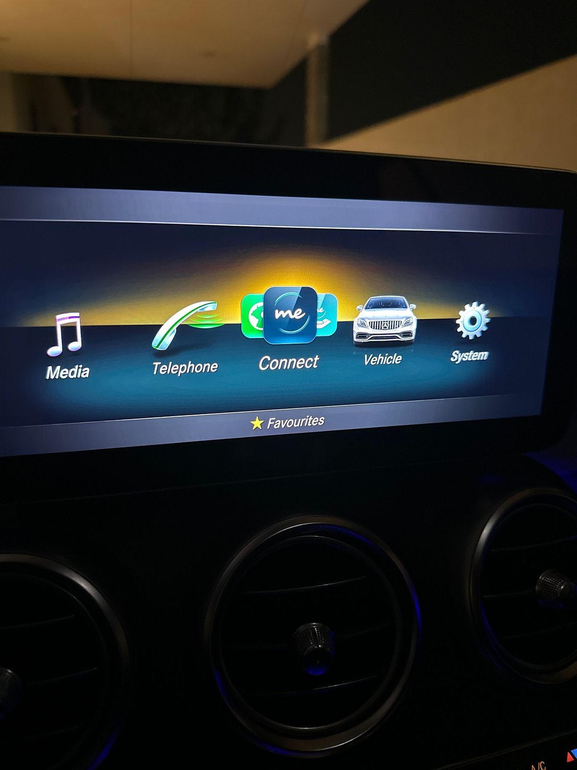

u mean this ?

Originally Posted by eytam bh
u mean this ?
Yes, that's COMAND. I know it's confusing and it looks similar to MBUX, but MBUX is the newer system. I have a 2019 C63S coupe with the same system as you, but mine came standard with Track Pace from the factory. The Mercedes Infotainment system used to be called COMAND and there were many versions over the year. Our cars have the latest version, which internally is referred to as NTG 5.5. It was then renamed to MBUX with NTG 6.0. MBUX is now up to NTG 8.0. It's different generations of the Infotainment system.
If you are confused about MBHouse being in Canada, I see you are located in Israel I believe, then don't be. They do this remotely over the Internet. You will have to purchase or rent an adapter that connects to your car and your laptop, and then they will install/code things remotely from their end. Other shops you can contact are BenzNinja and RJ Automotive. They are all referred to as remote coders. They can install and code additional features in your car remotely over the Internet.

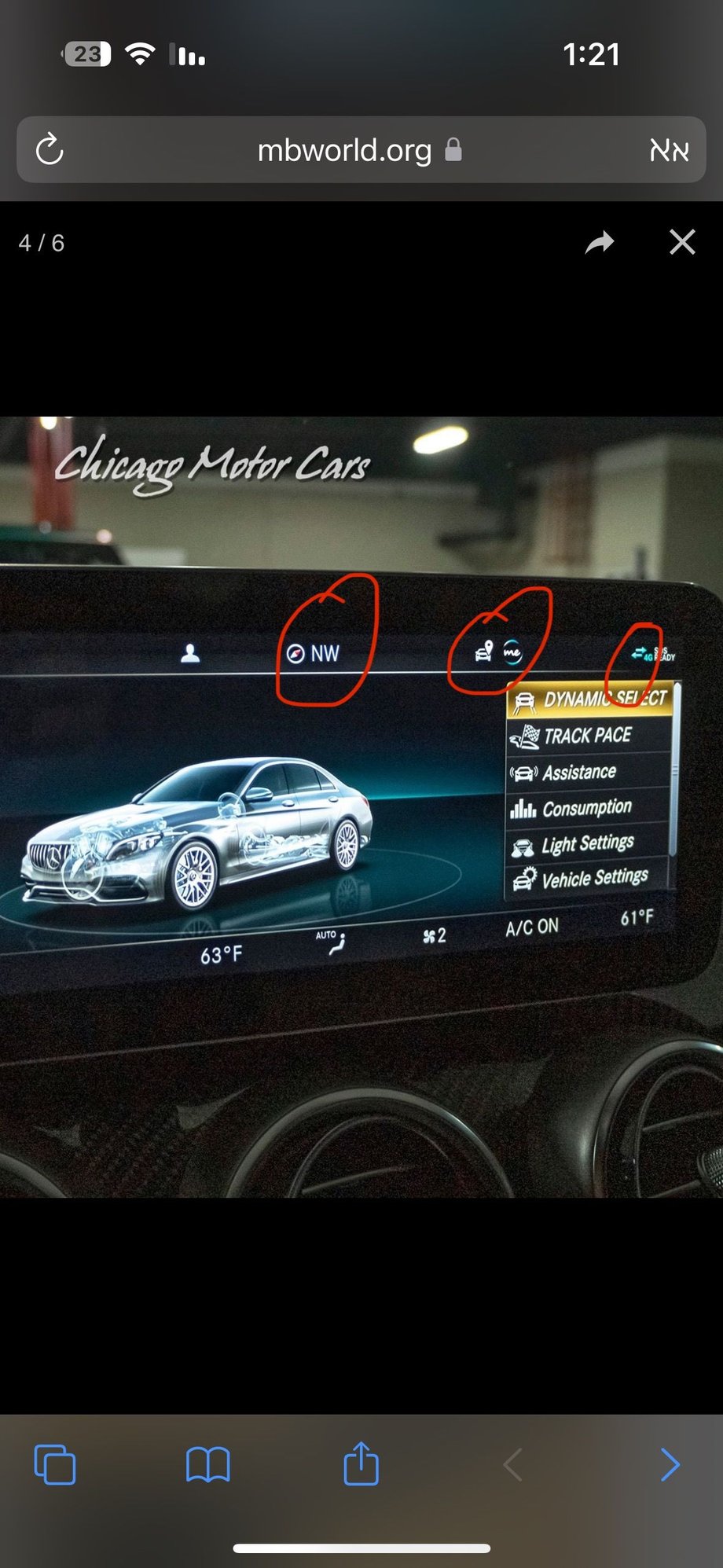

You can certainly check with them first. Just out of curiosity, have you looked for it in the right place? It's not on the home screen. It's under Vehicle in the right hand menu.
yes I send u pic

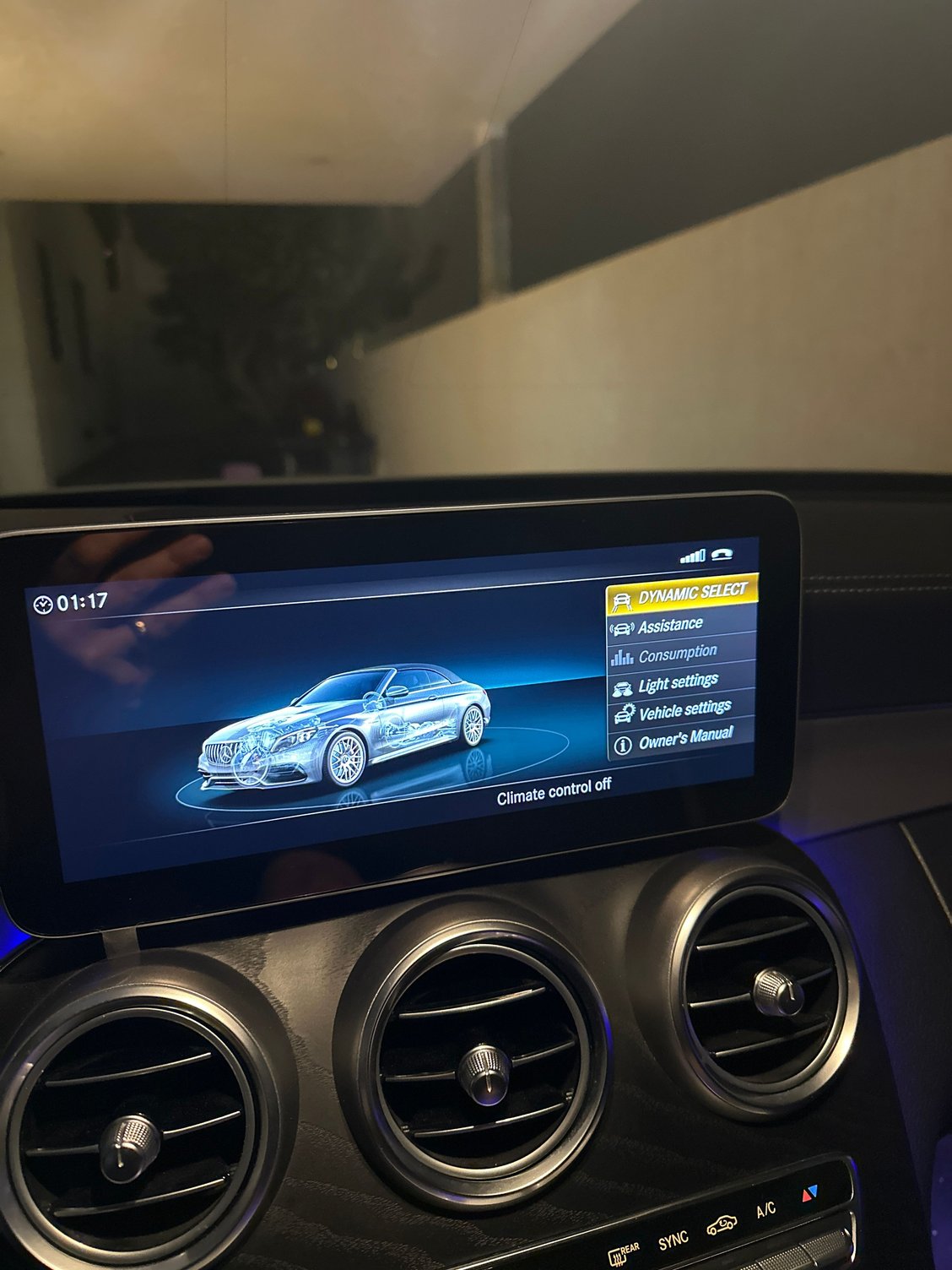

From: iL
mercedes c63s cabriolet 2020
u see

u see u have this in red I don’t have

Ah I see. Forget everything I said. You have the wrong system altogether. Your car has the entry level Infotainment system. Your system doesn't support Track Pace, online services, navigation etc. You are out of luck unfortunately.
Wow, interesting, my car is relatively new at the end of 2020, is it possible to update it or is it impossible?

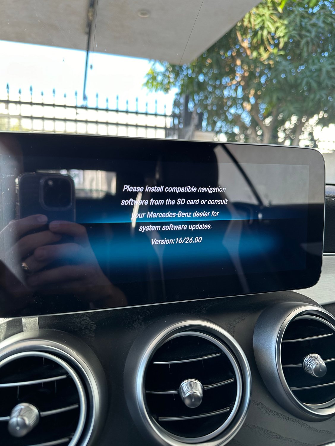

I send the guy from Mercedes this pic & he say to me it cost 1300 dollars to open
Yeah, that's the SD card navigation, but that doesn't cost $1300.
