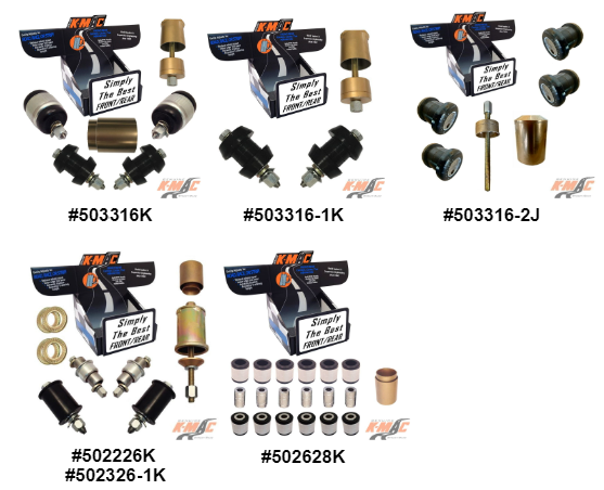

Hi
When it comes to suspension and handling we manufacture a “TOTAL SYSTEM” for the C63’S’ Coupe (and virtually all Benz models back to 1968).
EVEN THOUGH A PERFORMANCE AMG MODEL THERE IS ONLY FRONT AND REAR TOE “DIRECTIONAL” ADJUSTMENT !
NO FRONT CAMBER OR CASTER. NO REAR CAMBER !
All to do with cost cutting and ever increasing speed of new car assembly lines !
YET ESSENTIAL to combat costly, premature excess edge tire wear or on TRACK DAYS easily able to dial in “extra Neg. Camber” to hit those corner apexes every time and go deeper into the corners with increased traction and braking response. In the pursuit of front of the grid lap times.

WELL WE CERTAINLY DO (put in the effort…. and you get the results):
WITH K-MAC THEY’RE RACE PROVEN - The Strongest Camber & Caster adjuster kits constantly tested developed in all out heavy V8 competition racing. Situations where “Race Safety” scrutineers rule only K-MAC to be fitted.
…..AND WITH ALL THE “EXTRA” K-MAC FEATURES:
●Biggest
Adjustment Range.
●Quickest To Fit.
●Ultimate Adjustment - Patented design / Single wrench direct on alignment rack UNDER LOAD.
●Fraction of time to Accurately Adjust.
●Fraction of cost also (not philosophy / premise higher price dictates higher quality) !
….Then having “IN-HOUSE” manufacture of all facets of production - Ensures total control over quality and rapid / constant development !

C63/S Coupe & Sedans, Wagons - Re the “Rear End” queries:
“Losing Control”, Fishtailing, “Toe Arm Misalignment”, “Bushing Squeak” or “Popping / Failure”.
…..AT K-MAC - IT’S A TOTAL MATCHED & TUNED SYSTEM !
(C63/S Performance Auto - yet no OEM adjustment ! We saw the need to cater for not only resolving costly, premature edge tire wear but also the pursuit of Front row of the grid lap times).
We have the experience of manufacturing Performance bushings and Adjuster kits - Longer than anyone else 60 years.
From the outset in 1964 it has been ultimate - testing / developing on the race track. Heavy V8’s full speed main straight then hitting corner race curbs. Fully launching then slamming down broadside lap after lap.
This combined with proudly not sourcing imports but “IN-HOUSE” manufacture which allows rapid / constant development.
NO BRAND COMES CLOSE - With 1,000’s sold and experience / know how re strength and reliability (and without bush squeaks - a matter of correct “initial” torque settings).
AND NO BRAND COMES CLOSE RE -
SPEED of fitment, EASE / ACCURACY of adjustment, ADJUSTMENT range and PRICING - Low realistic !!
SEE SPOILER - C63/S “TOTAL SYSTEM” Coupe, Sedan, Wagon !
Spoiler
AUDI to VOLVO - K-MAC Experience Of Resolving OEM Suspension Shortcomings Since 1964 !

Revolution in design - initially “how can this possibly work”. But once you get your head around it. Align shops realise the simplicity (often said - simplest design is the best design).
Same with the C63S K-MAC “REAR” Camber (& Extra Toe) kits.
COUPE MODEL #502326-1K Game changer when compared to the OEM basic, inaccurate and minimal adjustment shims on this model !
K-MAC kit “replacing” and updating to A PRECISELY ACCURATE CAM WASHER ADJUSTMENT SYSTEM WITH 4 TIMES THE ADJUSTMENT RANGE (Plus uprating the soft rubber OEM bushes at the same time).
Same with Sedan and Wagons #502226K Camber (& Extra Toe) kit.
Similar design as Coupe and both rear kits exact same features as front.
SUMMARY - BILLET ARMS OR WHATEVER - “CANNOT SIMPLIFY any more” (Single Wrench / Precise adjustment under load) !!

The alignment shop mentioned it "eats up stock arms".
I don't know what that means, but they are no longer installing / working with KMAC bushings because of my car. Maybe they just don't understand how they work, but I would be surprised as they do all of the track alignments for Porsche GT cars, McLaren's etc.
