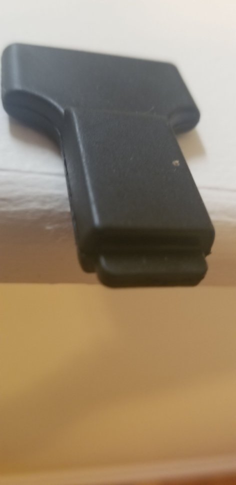

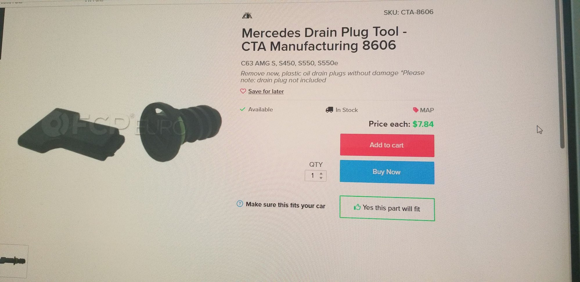

I just had my oil changed today at Indy shop. I do it every 6 months. Photo below is the plastic part to remove that plastic plug. Something I forget to get last time.

Is it possible to remove it with anything but plastic? or shall you install a fumoto valve?
I'm not sure how the Indy did it last time without the drain plug tool.
But I ordered it this time from FCP Euro. See photo below. The Indy told me to hold onto the drain plug tool for next time so I did.
https://cimg9.ibsrv.net/gimg/www.mbw...858e1b0a23.jpg
Sorry about that, I realized I made a mistake in my post... I meant "Is it possible to replace it with anything other than plastic, the drain plug... like aluminum or a copper drain plug" not the word remove.
As for the drain plug tool, does it look like a flat head screw driver will remove it?
Reason I mentioned fumoto valve is so you don't have to ever replace the drain plug again you just open a valve when you need to do the oil change.

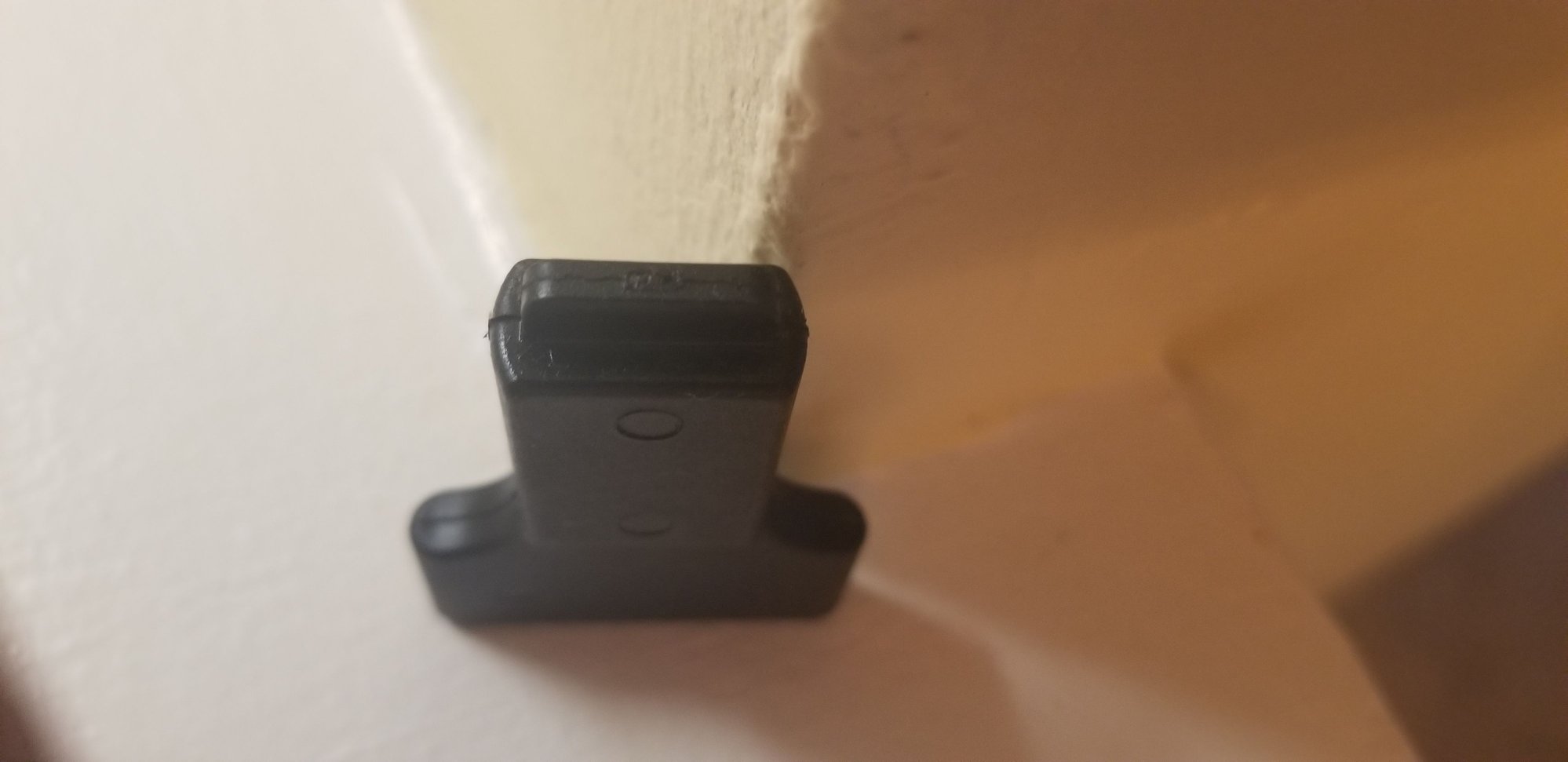

Not sure if a flat head will remove it. I sent few more photos at different angles and a photo of Production Information on it use.
This old school chain smoking MB mechanic told me to hold on to it. Also
https://cimg7.ibsrv.net/gimg/www.mbw...b29b6f0dc4.jpg
https://cimg5.ibsrv.net/gimg/www.mbw...47e5af6067.jpg
his young eagle eyed tech was able to see that small bubble in my sidewall. Grateful for that.
I see, does look like it is thicker than a typical flat head but honestly even if it works it wouldn't be wise given metal on plastic is not a good idea. the plastic tool on the plastic drain plug makes more sense. That said, really should see if you can replace it with something other than plastic.

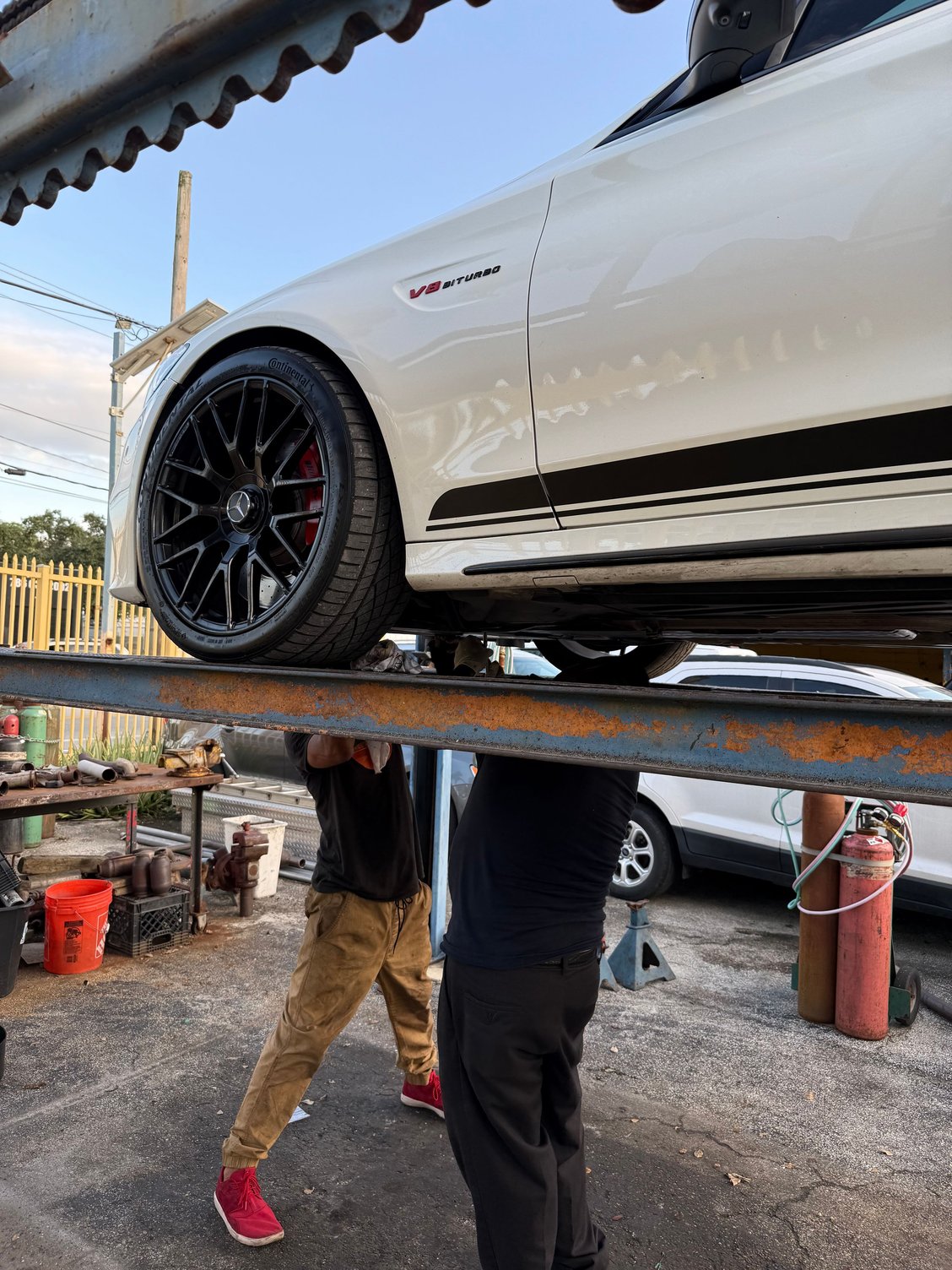

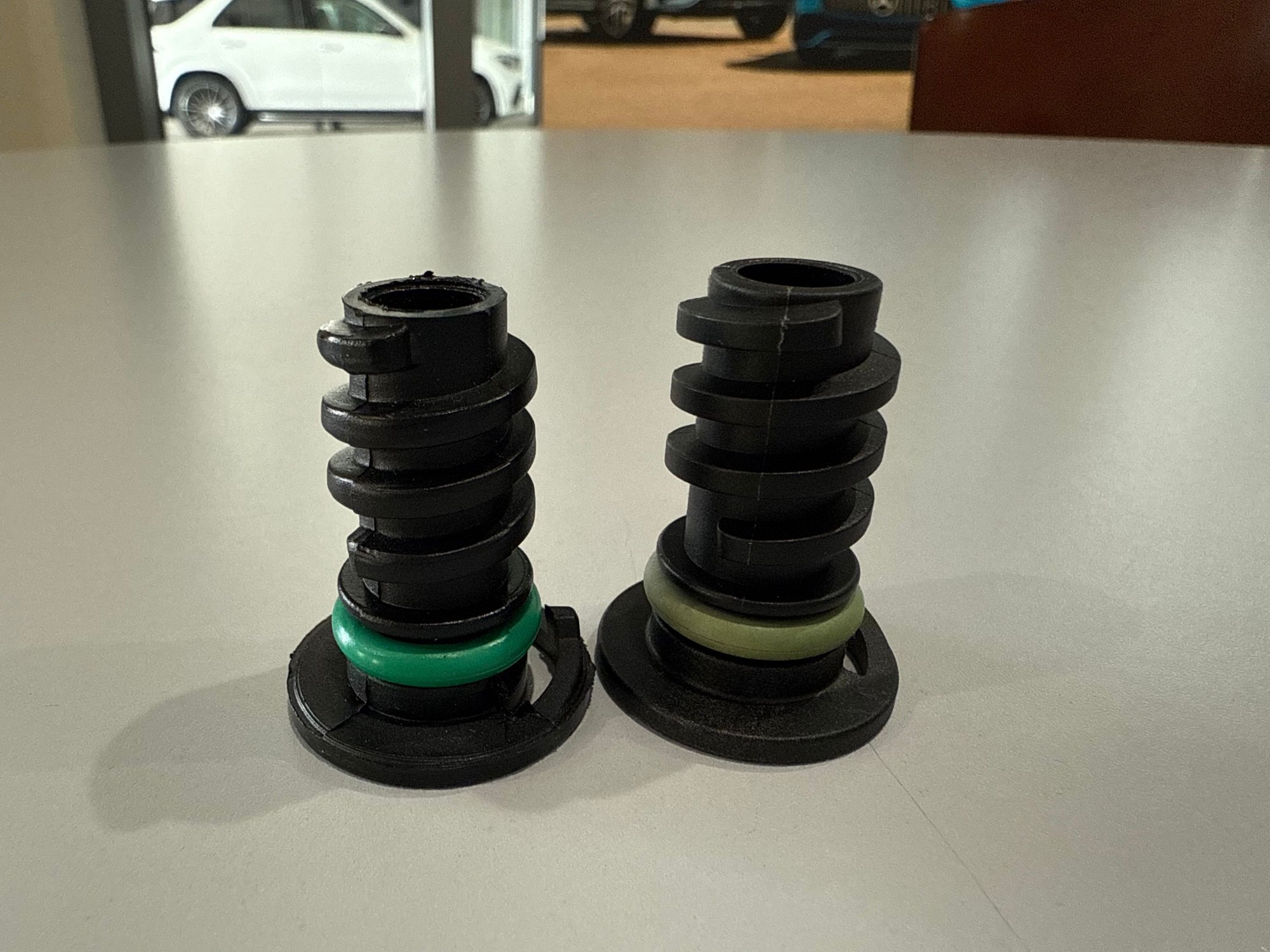

Just fixed my oil leak, 100% the drain plug unless the other mechanic overtightened it or didn't tighten it enough.
I HOPE!
Do not buy your drain plugs off Amazon, just for peace of mind. Get em from MB. $28. Then cost me another $40 for a local mechanic to pop out the Amazon one.
I HOPE!
https://cimg5.ibsrv.net/gimg/www.mbw...180db8bdc.jpeg
https://cimg6.ibsrv.net/gimg/www.mbw...7e49f4e98.jpeg
Looks like the boys are hard at work.
Ive done this 4 times now and have used a flathead each time. Some Mercedes techs even do this.
I see. Mystery solved : )
